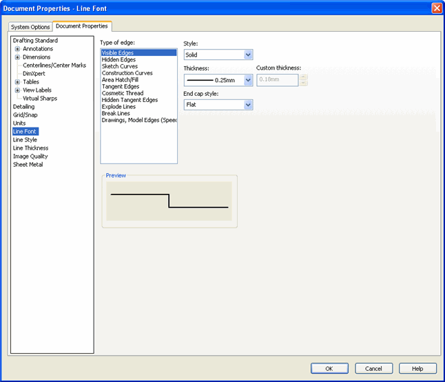

Document Properties > Line Font
Setting
Get/Set Methods
Return Value or <Value>
Comments
Visible Edges - Style
IModelDocExtension::GetUserPreferenceInteger(swUserPreferenceIntegerValue_e.swLineFontVisibleEdgesStyle, swUserPreferenceOption_e.swDetailingNoOptionSpecified)
IModelDocExtension::SetUserPreferenceInteger(swUserPreferenceIntegerValue_e.swLineFontVisibleEdgesStyle, swUserPreferenceOption_e.swDetailingNoOptionSpecified, swLineStyles_e.<Value>)
See swLineStyles_e for valid options
Specifies style of visible edges

Drawings, Model Edges (SpeedPak) - Custom thickness
IModelDocExtension::GetUserPreferenceDouble(swUserPreferenceDoubleValue_e.swLineFontSpeedPakDrawingsModelEdgesThicknessCustom, swUserPreferenceOption_e.swDetailingNoOptionSpecified)
IModelDocExtension::SetUserPreferenceDouble(swUserPreferenceDoubleValue_e.swLineFontSpeedPakDrawingsModelEdgesThicknessCustom, swUserPreferenceOption_e.swDetailingNoOptionSpecified, <Value>)
Double value
Specifies a custom thickness for model edges in a SpeedPak drawing document; sets Custom Thickness to the specified thickness and Leader Thickness to Custom Size
Page:   Document Properties > Line Font
Web Help Content Version: API Help (English only) 2010 SP05
