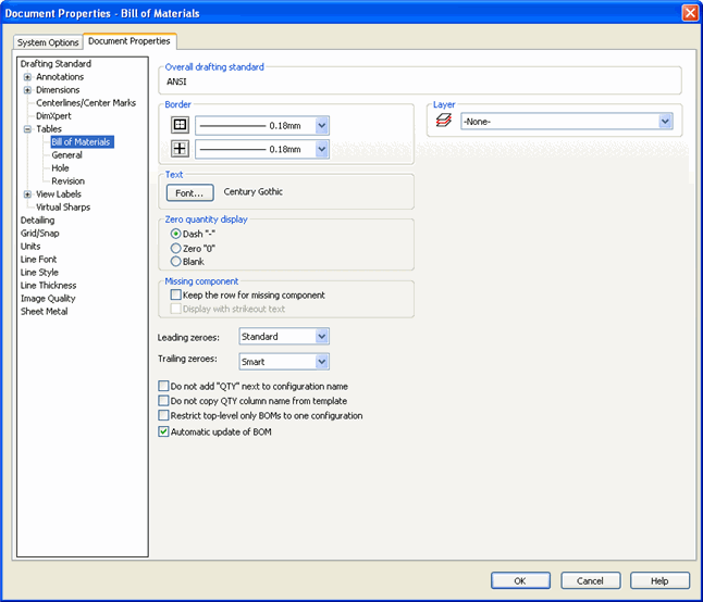

Document Properties > Tables > Bill of Materials
Setting
Get/Set Methods
Return Value or <Value>
Comments
Border - Box Border
IModelDocExtension::GetUserPreferenceInteger(swUserPreferenceIntegerValue_e.swDetailingBillOfMaterialBorderLineWeight, swUserPreferenceOption_e.swDetailingNoOptionSpecified)
IModelDocExtension::SetUserPreferenceInteger(swUserPreferenceIntegerValue_e.swDetailingBillOfMaterialBorderLineWeight, swUserPreferenceOption_e.swDetailingNoOptionSpecified, swLineWeights_e.<Value>)
See swLineWeights_e for valid options
Border - Grid Border
IModelDocExtension::GetUserPreferenceInteger(swUserPreferenceIntegerValue_e.swDetailingBillOfMaterialGridLineWeight, swUserPreferenceOption_e.swDetailingNoOptionSpecified)
IModelDocExtension::SetUserPreferenceInteger(swUserPreferenceIntegerValue_e.swDetailingBillOfMaterialGridLineWeight, swUserPreferenceOption_e.swDetailingNoOptionSpecified, swLineWeights_e.<Value>)
Text - Font...
IModelDocExtension::GetUserPreferenceTextFormat(swUserPreferenceTextFormat_e.swDetailingBillOfMaterialTextFormat, swUserPreferenceOption_e.swDetailingNoOptionSpecified)
IModelDocExtension::SetUserPreferenceTextFormat(swUserPreferenceTextFormat_e.swDetailingBillOfMaterialTextFormat, swUserPreferenceOption_e.swDetailingNoOptionSpecified, <Value>)
See ITextFormat for font options
To set font property values, implement ITextFormat, set the appropriate ITextFormat member values, and pass the ITextFormat object in the API set method
Zero quantity display
IModelDocExtension::GetUserPreferenceInteger(swUserPreferenceIntegerValue_e.swBomTableZeroQuantityDisplay, swUserPreferenceOption_e.swDetailingBillOfMaterial)
IModelDocExtension::SetUserPreferenceInteger(swUserPreferenceIntegerValue_e.swBomTableZeroQuantityDisplay, swUserPreferenceOption_e.swDetailingBillOfMaterial, swZeroQuantityDisplay_e.<Value>)
See swZeroQuantityDisplay_e for valid options
Missing component - Keep the row for missing component
IModelDocExtension::GetUserPreferenceToggle(swUserPreferenceToggle_e.swBomTableKeepMissingItems, swUserPreferenceOption_e.swDetailingNoOptionSpecified)
IModelDocExtension::SetUserPreferenceToggle(swUserPreferenceToggle_e.swBomTableKeepMissingItems, swUserPreferenceOption_e.swDetailingNoOptionSpecified, <Value>)
Boolean value
Specifies whether to list missing (deleted) components in BOM
Missing component - Display with strikeout text
IModelDocExtension::GetUserPreferenceToggle(swUserPreferenceToggle_e.swBomTableStrikeThroughMissingItems, swUserPreferenceOption_e.swDetailingNoOptionSpecified)
IModelDocExtension::SetUserPreferenceToggle(swUserPreferenceToggle_e.swBomTableStrikeThroughMissingItems, swUserPreferenceOption_e.swDetailingNoOptionSpecified, <Value>)
Boolean value
Specifies whether to strike through text for missing components
Leading zeroes
IModelDocExtension::GetUserPreferenceInteger(swUserPreferenceIntegerValue_e.swDetailingLeadingZero, swUserPreferenceOption_e.swDetailingBillOfMaterial)
IModelDocExtension::SetUserPreferenceInteger(swUserPreferenceIntegerValue_e.swDetailingLeadingZero, swUserPreferenceOption_e.swDetailingBillOfMaterial, swDetailingLeadingZero_e.<Value>)
See swDetailingLeadingZero_e for valid options
Trailing zeroes
IModelDocExtension::GetUserPreferenceInteger(swUserPreferenceIntegerValue_e.swDetailingDimTrailingZero, swUserPreferenceOption_e.swDetailingBillOfMaterial)
IModelDocExtension::SetUserPreferenceInteger(swUserPreferenceIntegerValue_e.swDetailingDimTrailingZero, swUserPreferenceOption_e.swDetailingBillOfMaterial, swDetailingDimTrailingZero_e.<Value>)
See swDetailingDimTrailingZero_e for valid options
Do not add "QTY" next to configuration name
IModelDocExtension::GetUserPreferenceToggle(swUserPreferenceToggle_e.swBomTableDontAddQTYNextToConfigName, swUserPreferenceOption_e.swDetailingNoOptionSpecified)
IModelDocExtension::SetUserPreferenceToggle(swUserPreferenceToggle_e.swBomTableDontAddQTYNextToConfigName, swUserPreferenceOption_e.swDetailingNoOptionSpecified, <Value>)
Boolean value
Do not add QTY column header name next to configuration name header
Do not copy QTY column name from template
IModelDocExtension::GetUserPreferenceToggle(swUserPreferenceToggle_e.swDontCopyQTYColumnNameFromTemplate, swUserPreferenceOption_e.swDetailingNoOptionSpecified)
IModelDocExtension::SetUserPreferenceToggle(swUserPreferenceToggle_e.swDontCopyQTYColumnNameFromTemplate, swUserPreferenceOption_e.swDetailingNoOptionSpecified, <Value>)
Boolean value
Do not copy QTY column header name from template to BOM
Restrict top-level only BOMs to one configuration
IModelDocExtension::GetUserPreferenceToggle(swUserPreferenceToggle_e.swOneConfigOnlyTopLevelBom, swUserPreferenceOption_e.swDetailingNoOptionSpecified)
IModelDocExtension::SetUserPreferenceToggle(swUserPreferenceToggle_e.swOneConfigOnlyTopLevelBom, swUserPreferenceOption_e.swDetailingNoOptionSpecified, <Value>)
Boolean value
Specifies whether to limit BOMs designated as top-level only to one configuration
Automatic update of BOM
IModelDocExtension::GetUserPreferenceToggle(swUserPreferenceToggle_e.swDetailingAutoUpdateBOM, swUserPreferenceOption_e.swDetailingNoOptionSpecified)
IModelDocExtension::SetUserPreferenceToggle(swUserPreferenceToggle_e.swDetailingAutoUpdateBOM, swUserPreferenceOption_e.swDetailingNoOptionSpecified, <Value>)
Boolean value
Specifies whether to automatically update BOM when changes are made to model
Layer
IModelDocExtension::GetUserPreferenceString(swUserPreferenceStringValue_e.swDetailingLayer, swUserPreferenceOption_e.swDetailingBillOfMaterial)
IModelDocExtension::SetUserPreferenceString(swUserPreferenceStringValue_e.swDetailingLayer, swUserPreferenceOption_e.swDetailingBillOfMaterial, <Value>)
Valid options:
  • "Border"
  • "Dimensions"
  • "Notes"
  • "BOM"
  • "FORMAT"
  • "None"
This setting is available only on drawings; depending on drawing, some options may not apply
