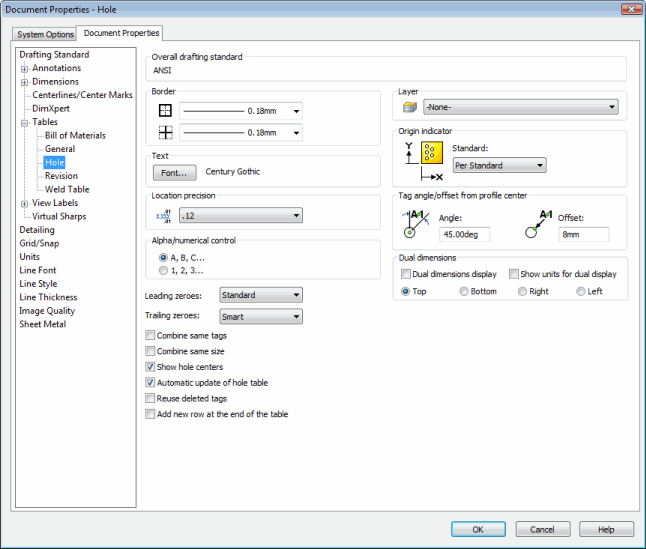

Document Properties > Tables > Hole
NOTE: Setting any of the following hole table values means that new holes tables added to the drawing use these default values. However, a hole table that uses a template table for insertion might not use these default values because the template table contains certain properties that take precedence over these default values. These properties include the tag style, precision values, combine tag, combine same size, and hole centers visible values.
Setting
Get/Set Methods
Return Value or <Value>
Comments
Border - Box Border
IModelDocExtension::GetUserPreferenceInteger(swUserPreferenceIntegerValue_e.swDetailingHoleTableBorderLineWeight, swUserPreferenceOption_e.swDetailingNoOptionSpecified)
IModelDocExtension::SetUserPreferenceInteger(swUserPreferenceIntegerValue_e.swDetailingHoleTableBorderLineWeight, swUserPreferenceOption_e.swDetailingNoOptionSpecified, swLineWeights_e.<Value>)
See swLineWeights_e for valid options
Border - Grid Border
IModelDocExtension::GetUserPreferenceInteger(swUserPreferenceIntegerValue_e.swDetailingHoleTableGridLineWeight, swUserPreferenceOption_e.swDetailingNoOptionSpecified)
IModelDocExtension::SetUserPreferenceInteger(swUserPreferenceIntegerValue_e.swDetailingHoleTableGridLineWeight, swUserPreferenceOption_e.swDetailingNoOptionSpecified, swLineWeights_e.<Value>)
Text - Font...
IModelDocExtension::GetUserPreferenceTextFormat(swUserPreferenceTextFormat_e.swDetailingHoleTableTextFormat, swUserPreferenceOption_e.swDetailingNoOptionSpecified)
IModelDocExtension::SetUserPreferenceTextFormat(swUserPreferenceTextFormat_e.swDetailingHoleTableTextFormat, swUserPreferenceOption_e.swDetailingNoOptionSpecified, <Value>)
See ITextFormat for font options
To set font property values, implement ITextFormat, set the appropriate ITextFormat member values, and pass the ITextFormat object in the API set method
Location precision - Unit Precision
IModelDocExtension::GetUserPreferenceInteger(swUserPreferenceIntegerValue_e.swHoleTableHoleLocationPrecision, swUserPreferenceOption_e.swDetailingNoOptionSpecified)
IModelDocExtension::SetUserPreferenceInteger(swUserPreferenceIntegerValue_e.swHoleTableHoleLocationPrecision, swUserPreferenceOption_e.swDetailingNoOptionSpecified, <Value>)
Integer value (0 - 8)
Specifies the number of digits of precision to display in the X and Y hole location columns in the hole table; specify a value from 0 through 8
When setting this value, existing hole tables in the drawing are updated to use this precision
Alpha/numerical control
IModelDocExtension::GetUserPreferenceInteger(swUserPreferenceIntegerValue_e.swHoleTableTagStyle, swUserPreferenceOption_e.swDetailingNoOptionSpecified)
IModelDocExtension::SetUserPreferenceInteger(swUserPreferenceIntegerValue_e.swHoleTableTagStyle, swUserPreferenceOption_e.swDetailingNoOptionSpecified, swHoleTableTagStyle_e.<Value>)
See swHoleTableTagStyle_e for valid options
Specifies whether or not the hole tags are alphanumeric or numeric
Leading zeroes
IModelDocExtension::GetUserPreferenceInteger(swUserPreferenceIntegerValue_e.swDetailingLeadingZero, swUserPreferenceOption_e.swDetailingHoleTable)
IModelDocExtension::SetUserPreferenceInteger(swUserPreferenceIntegerValue_e.swDetailingLeadingZero, swUserPreferenceOption_e.swDetailingHoleTable, swDetailingLeadingZero_e.<Value>)
See swDetailingLeadingZero_e for valid options
Trailing zeroes
IModelDocExtension::GetUserPreferenceInteger(swUserPreferenceIntegerValue_e.swDetailingDimTrailingZero, swUserPreferenceOption_e.swDetailingHoleTable)
IModelDocExtension::SetUserPreferenceInteger(swUserPreferenceIntegerValue_e.swDetailingDimTrailingZero, swUserPreferenceOption_e.swDetailingHoleTable, swDetailingDimTrailingZero_e.<Value>)
See swDetailingDimTrailingZero_e for valid options
Combine same tags
IModelDocExtension::GetUserPreferenceToggle(swUserPreferenceToggle_e.swHoleTableCombineTags, swUserPreferenceOption_e.swDetailingNoOptionSpecified)
IModelDocExtension::SetUserPreferenceToggle(swUserPreferenceToggle_e.swHoleTableCombineTags, swUserPreferenceOption_e.swDetailingNoOptionSpecified, <Value>)
Boolean value
If TRUE, then holes of the same size are assigned the same tag, and the hole table contains a Quantity column, which indicates multiple holes of the same size exist
Combine same size
IModelDocExtension::GetUserPreferenceToggle(swUserPreferenceToggle_e.swHoleTableCombineSameSize, swUserPreferenceOption_e.swDetailingNoOptionSpecified)
IModelDocExtension::SetUserPreferenceToggle(swUserPreferenceToggle_e.swHoleTableCombineSameSize, swUserPreferenceOption_e.swDetailingNoOptionSpecified, <Value>)
Boolean value
If TRUE, then holes are the same size, and their cells in the Size column are merged and appear as a single cell
Show hole centers
IModelDocExtension::GetUserPreferenceToggle(swUserPreferenceToggle_e.swHoleTableHoleCentersVisible, swUserPreferenceOption_e.swDetailingNoOptionSpecified)
IModelDocExtension::SetUserPreferenceToggle(swUserPreferenceToggle_e.swHoleTableHoleCentersVisible, swUserPreferenceOption_e.swDetailingNoOptionSpecified, <Value>)
Boolean value
If TRUE, then the hole centers are indicated by points
Automatic update of hole table
IModelDocExtension::GetUserPreferenceToggle(swUserPreferenceToggle_e.swHoleTableAutomaticUpdate, swUserPreferenceOption_e.swDetailingNoOptionSpecified)
IModelDocExtension::SetUserPreferenceToggle(swUserPreferenceToggle_e.swHoleTableAutomaticUpdate, swUserPreferenceOption_e.swDetailingNoOptionSpecified, <Value>)
Boolean value
If TRUE, then the hole table is automatically updated when the model changes; when you set this value, existing holes tables in the drawing are updated
Layer
IModelDocExtension::GetUserPreferenceString(swUserPreferenceStringValue_e.swDetailingLayer, swUserPreferenceOption_e.swDetailingHoleTable)
IModelDocExtension::SetUserPreferenceString(swUserPreferenceStringValue_e.swDetailingLayer, swUserPreferenceOption_e.swDetailingHoleTable, <Value>)
Valid options:
  • "Border"
  • "Dimensions"
  • "Notes"
  • "BOM"
  • "FORMAT"
  • "None"
This setting is available only on drawings; depending on drawing, some options may not apply
Origin indicator
IModelDocExtension::GetUserPreferenceInteger(swUserPreferenceIntegerValue_e.swHoleTableOriginStandard, swUserPreferenceOption_e.swDetailingNoOptionSpecified)
IModelDocExtension::SetUserPreferenceInteger(swUserPreferenceIntegerValue_e.swHoleTableOriginStandard, swUserPreferenceOption_e.swDetailingNoOptionSpecified, swDetailingStandard_e.<Value>)
See swDetailingStandard_e for valid options
Specifies the detailing standard to use for displaying the hole table's origin symbol
If you specify -1 or 0, then the origin symbol is displayed according to the default document detailing standard; otherwise, the value is from swDetailingStandard_e and the hole table's origin is displayed according to that standard
When setting this value, any existing hole tables in the drawing are updated to use this dimensioning standard
To determine the default document detailing standard, get the value of the document's integer user preference swDetailingDimensionStardard
Tag angle/offset from profile center - Angle
IModelDocExtension::GetUserPreferenceDouble(swUserPreferenceDoubleValue_e.swHoleTableTagAngle, swUserPreferenceOption_e.swDetailingNoOptionSpecified)
IModelDocExtension::GetUserPreferenceDouble(swUserPreferenceStringValue_e.swHoleTableTagAngle, swUserPreferenceOption_e.swDetailingNoOptionSpecified, <Value>)
Double value
The origin of the hole tag text is at this angle, in radians, clockwise from the Y axis at the distance specified by swHoleTableTagOffset (see the next enumeration); the angle must be between -360°and 360°
Tag angle/offset from profile center - Offset
IModelDocExtension::GetUserPreferenceDouble(swUserPreferenceDoubleValue_e.swHoleTableTagOffset, swUserPreferenceOption_e.swDetailingNoOptionSpecified)
IModelDocExtension::GetUserPreferenceDouble(swUserPreferenceStringValue_e.swHoleTableTagOffset, swUserPreferenceOption_e.swDetailingNoOptionSpecified, <Value>)
Double value
The origin of the hole tag text is this distance from the hole at the angle specified by swHoleTableTagAngle (see previous enumeration); the offset must be > 0
