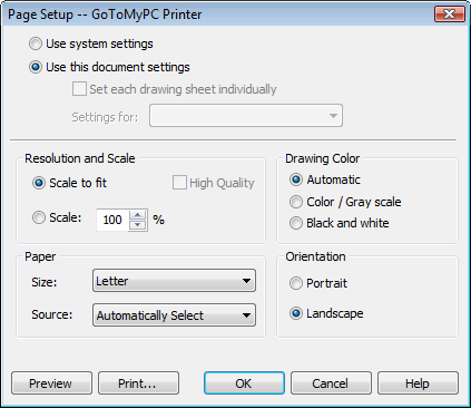

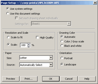

This topic contains two tables. The information in the table:
  • appearing immediately after the screen capture of the Page Setup dialog corresponds to the settings on that dialog.

Setting
Get/Set Methods
Return Value
or
<Value>
or
<OnFlag>
Comment
Use system settings
See Comment
See Comment
Not currently available in SolidWorks API
Use this document settings
See Comment
See Comment
Set each drawing sheet individually
See Comment
See Comment
Settings for
See Comment
See Comment
Resolution and Scale - Scale to fit
ISldWorks::GetUserPreferenceToggle(swUserPreferenceToggle_e.swPageSetupDrawingScaleToFit) ISldWorks::SetUserPreferenceToggle(swUserPreferenceToggle_e.swPageSetupDrawingScaleToFit, <OnFlag>)
Boolean value
Specifies whether to print drawing sheet to fit paper size; for drawings only; Use system settings on Page Setup dialog must be selected when changing this setting.
See Comment
See Comment
Resolution and Scale - <n>
See Comment
See Comment
Resolution and Scale - High Quality
ISldWorks::GetUserPreferenceToggle(swUserPreferenceToggle_e.swPageSetupHighQuality) ISldWorks::SetUserPreferenceToggle(swUserPreferenceToggle_e.swPageSetupHighQuality, <OnFlag>)
Boolean value
Specifies whether to load all model information into memory; for drawings only
Drawing Color - Automatic
ISldWorks::GetUserPreferenceIntegerValue(swUserPreferenceIntegerValue_e.swPageSetupDrawingColor)
ISldWorks::SetUserPreferenceIntegerValue(swUserPreferenceIntegerValue_e.swPageSetupDrawingColor, swPageSetupDrawingColor_e.swPageSetup_AutomaticDrawingColor)
See swPageSetupDrawingColor_e for all valid options
Drawing Color - Color / Gray scale
ISldWorks::SetUserPreferenceIntegerValue(swUserPreferenceIntegerValue_e.swPageSetupDrawingColor, swPageSetupDrawingColor_e.swPageSetup_ColorGrey)
Drawing Color - Black and white
ISldWorks::SetUserPreferenceIntegerValue(swUserPreferenceIntegerValue_e.swPageSetupDrawingColor, swPageSetupDrawingColor_e.swPageSetup_BlackAndWhite)
Paper - Size
See Comment
See Comment
Defined by the operating system or by a specific printer device; there is no SolidWorks API enumeration for these values
Paper - Source
See Comment
See Comment
Orientation - Portrait
ISldWorks::GetUserPreferenceIntegerValue(swUserPreferenceIntegerValue_e.swPageSetupPrinterOrientation)
ISldWorks::SetUserPreferenceIntegerValue(swUserPreferenceIntegerValue_e.swPageSetupPrinterOrientation, swPageSetupOrientation_e.swPageSetupOrient_Portrait)
See swPageSetupOrientation_e for all valid options
Orientation - Landscape
ISldWorks::SetUserPreferenceIntegerValue(swUserPreferenceIntegerValue_e.swPageSetupPrinterOrientation, swPageSetupOrientation_e.swPageSetupOrient_Landscape)
swPageSetupOrientation_e.swPageSetupOrient_Landsacpe
