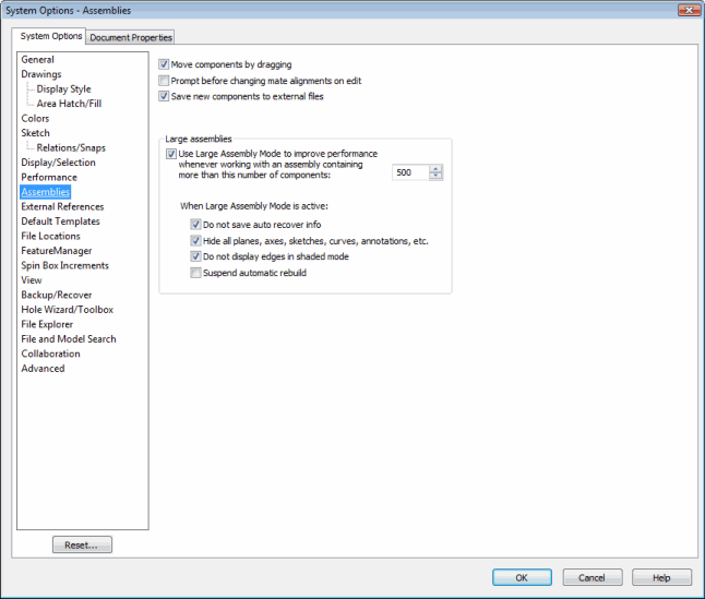

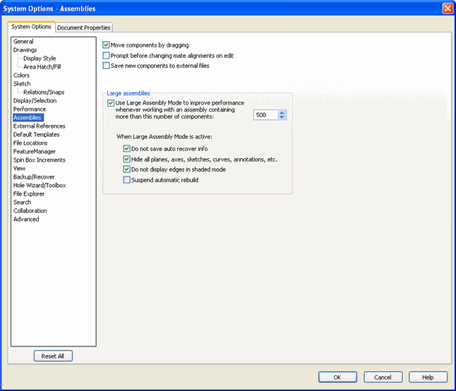

System Options > Assemblies
Setting
Get/Set Method
Return Value
or
<Value>
or
<OnFlag>
Comment
Move components by dragging
ISldWorks::GetUserPreferenceToggle(swUserPreferenceToggle_e.swAssemblyAllowComponentMoveByDragging)
ISldWorks::SetUserPreferenceToggle(swUserPreferenceToggle_e.swAssemblyAllowComponentMoveByDragging, <OnFlag>)
Boolean value
Specifies whether to move assembly components by dragging them or using the Move with Triad and Move Component tools
Prompt before changing mate alignments on edit
ISldWorks::GetUserPreferenceToggle(swUserPreferenceToggle_e.swPromptForAutoMateFlip)
ISldWorks::SetUserPreferenceToggle(swUserPreferenceToggle_e.swPromptForAutoMateFlip, <OnFlag>)
Boolean value
Specifies whether to prompt before automatically flipping a mate to avoid errors
Save new components to external files
ISldWorks::GetUserPreferenceToggle(swUserPreferenceToggle_e.swSaveNewComponentToExternalFile)
ISldWorks::SetUserPreferenceToggle(swUserPreferenceToggle_e.swSaveNewComponentToExternalFile, <OnFlag>)
Boolean value
Specifies whether to save new components to external files
Large assemblies - Use Large Assembly Mode to improve performance whenever working with an assembly containing more than this number of components (checkbox)
ISldWorks::GetUserPreferenceToggle(swUserPreferenceToggle_e.swLargeAsmModeEnabled)
ISldWorks::SetUserPreferenceToggle(swUserPreferenceToggle_e.swLargeAsmModeEnabled, <OnFlag>)
Boolean value
Specifies whether to activate large assembly mode
Large assemblies - Use Large Assembly Mode to improve performance whenever working with an assembly containing more than this number of components (listbox)
ISldWorks::GetUserPreferenceIntegerValue(swUserPreferenceIntegerValue_e.swLargeAsmModeThreshold)
ISldWorks::SetUserPreferenceIntegerValue(swUserPreferenceIntegerValue_e.swLargeAsmModeThreshold, <Value>)
Integer value
When Large Assembly Mode is active - Do not save auto recover info
ISldWorks::GetUserPreferenceToggle(swUserPreferenceToggle_e.swLargeAsmModeAutoRecover)
ISldWorks::SetUserPreferenceToggle(swUserPreferenceToggle_e.swLargeAsmModeAutoRecover, <OnFlag>)
Boolean value
Specifies whether to automatically save model information after specified number of changes
When Large Assembly Mode is active - Hide all planes, axes, sketches, curves, annotations, etc.
ISldWorks::GetUserPreferenceToggle(swUserPreferenceToggle_e.swLargeAsmModeHideAllItems)
ISldWorks::SetUserPreferenceToggle(swUserPreferenceToggle_e.swLargeAsmModeHideAllItems, <OnFlag>)
Boolean value
Specifies whether to hide all planes, axes, sketches, curves, annotations, etc.
When Large Assembly Mode is active - Do not display edges in shaded mode
ISldWorks::GetUserPreferenceToggle(swUserPreferenceToggle_e.swLargeAsmModeUseHLREdgesInShaded)
ISldWorks::SetUserPreferenceToggle(swUserPreferenceToggle_e.swLargeAsmModeUseHLREdgesInShaded, <OnFlag>)
Boolean value
Specifies whether to use HLR edges in shaded mode
When Large Assembly Mode is active - Suspend automatic rebuild
ISldWorks::GetUserPreferenceToggle(swUserPreferenceToggle_e.swLargeAsmModeSuspendAutoRebuild)
ISldWorks::SetUserPreferenceToggle(swUserPreferenceToggle_e.swLargeAsmModeSuspendAutoRebuild, <OnFlag>)
Boolean value
Specifies to defer the update of assemblies so that you can make changes and rebuild the assembly once
