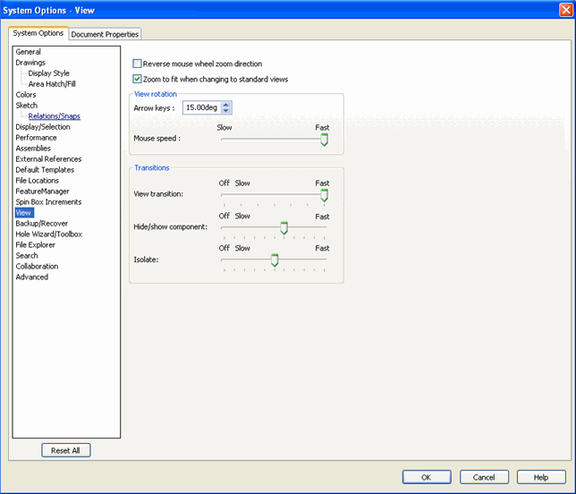

Setting
Get/Set Methods
Return Value or <Value> or <OnFlag>
Comment
Reverse mouse wheel zoom direction
ISldWorks::GetUserPreferenceToggle(swUserPreferenceToggle_e.swViewReverseWheelZoomDirection)
ISldWorks::SetUserPreferenceToggle(swUserPreferenceToggle_e.swViewReverseWheelZoomDirection, <OnFlag>)
Boolean value
Specifies whether to reverse a mouse's wheel zoom direction
Zoom to fit when changing to standard views
ISldWorks::GetUserPreferenceToggle(swUserPreferenceToggle_e.swViewZoomFitAndCenter)
ISldWorks::SetUserPreferenceToggle(swUserPreferenceToggle_e.swViewZoomFitAndCenter, <OnFlag>)
Specifies whether to zoom-to-fit view when changing to standard views
View rotation - Arrow keys
ISldWorks::GetUserPreferenceDoubleValue(swUserPreferenceDoubleValue_e.swViewRotationArrowKeys)
ISldWorks::SetUserPreferenceDoubleValue(swUserPreferenceDoubleValue_e.swViewRotationArrowKeys, <Value>)
Double value in radians
Specifies angle increment for view rotation when arrow keys are used to rotate model
View rotation - Mouse speed
ISldWorks::GetUserPreferenceIntegerValue(swUserPreferenceIntegerValue_e.swViewRotationMouseSpeed)
ISldWorks::SetUserPreferenceIntegerValue(swUserPreferenceIntegerValue_e.swViewRotationMouseSpeed, <Value>)
Integer value from 1 to 100
Specifies the speed of rotation when you use the mouse to rotate the model or assembly component
Transitions - View transition
ISldWorks::GetUserPreferenceDoubleValue(swUserPreferenceDoubleValue_e.swViewAnimationSpeed)
ISldWorks::SetUserPreferenceDoubleValue(swUserPreferenceDoubleValue_e.swViewAnimationSpeed, <Value>)
Double value:
0 = off
>0 - 3 seconds
Specifies animation-like speed when changing views
Transitions - Hide/show component
ISldWorks::GetUserPreferenceDoubleValue(swUserPreferenceDoubleValue_e.swViewTransitionHideShowComponent)
ISldWorks::SetUserPreferenceDoubleValue(swUserPreferenceDoubleValue_e.swViewTransitionHideShowComponent, <Value>)
Double value
Specifies the animation-like speed at which to transition the view when hiding or showing components
Transitions - Isolate
ISldWorks::GetUserPreferenceDoubleValue(swUserPreferenceDoubleValue_e.swViewTransitionIsolate)
ISldWorks::SetUserPreferenceDoubleValue(swUserPreferenceDoubleValue_e.swViewTransitionIsolate, <Value>)
Specifies the animation-like speed at which to transition the view when isolating a component in assemblies and multi-body parts
