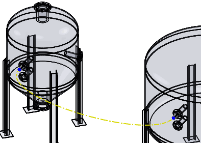

You can insert inline components into a pipe route after creating it from imported P&ID data, such as from a Solution Partner. SolidWorks identifies required components such as tees and reducers that are not defined in the document and lets you select them from a list.
Routing guidelines display without having to first place tees, inline fittings such as valves, and reducers. You can convert these guidelines to routes as required.
