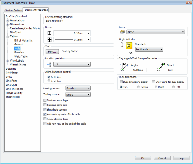

Setting |
Get/Set Methods |
Return Value or <Value> |
Comments |
Border - Box Border |
IModelDocExtension::GetUserPreferenceInteger(swUserPreferenceIntegerValue_e.swDetailingHoleTableBorderLineWeight,
swUserPreferenceOption_e.swDetailingNoOptionSpecified)
IModelDocExtension::SetUserPreferenceInteger(swUserPreferenceIntegerValue_e.swDetailingHoleTableBorderLineWeight,
swUserPreferenceOption_e.swDetailingNoOptionSpecified, swLineWeights_e.<Value>) |
See swLineWeights_e
for valid options |
Border - Grid Border |
IModelDocExtension::GetUserPreferenceInteger(swUserPreferenceIntegerValue_e.swDetailingHoleTableGridLineWeight,
IModelDocExtension::SetUserPreferenceInteger(swUserPreferenceIntegerValue_e.swDetailingHoleTableGridLineWeight,
See swLineWeights_e
for valid options |
Text - Font... |
IModelDocExtension::GetUserPreferenceTextFormat(swUserPreferenceTextFormat_e.swDetailingHoleTableTextFormat,
IModelDocExtension::SetUserPreferenceTextFormat(swUserPreferenceTextFormat_e.swDetailingHoleTableTextFormat,
swUserPreferenceOption_e.swDetailingNoOptionSpecified, <Value>) |
See ITextFormat
for font options |
To set font property values, implement ITextFormat, set the appropriate
ITextFormat member values, and pass the ITextFormat object in the API
set method |
Location precision - Unit Precision |
IModelDocExtension::GetUserPreferenceInteger(swUserPreferenceIntegerValue_e.swHoleTableHoleLocationPrecision,
IModelDocExtension::SetUserPreferenceInteger(swUserPreferenceIntegerValue_e.swHoleTableHoleLocationPrecision,
Integer value (0 - 8) |
Specifies the number of digits of precision to display in the X and
Y hole location columns in the hole table; specify a value from 0 through
8
When setting this value, existing hole tables in the drawing are updated
to use this precision |
Alpha/numerical control |
IModelDocExtension::GetUserPreferenceInteger(swUserPreferenceIntegerValue_e.swHoleTableTagStyle,
IModelDocExtension::SetUserPreferenceInteger(swUserPreferenceIntegerValue_e.swHoleTableTagStyle,
swUserPreferenceOption_e.swDetailingNoOptionSpecified, swHoleTableTagStyle_e.<Value>) |
See swHoleTableTagStyle_e
for valid options |
Specifies whether or not the hole tags are alphanumeric or numeric |
Leading zeroes |
IModelDocExtension::GetUserPreferenceInteger(swUserPreferenceIntegerValue_e.swDetailingLeadingZero,
swUserPreferenceOption_e.swDetailingHoleTable)
IModelDocExtension::SetUserPreferenceInteger(swUserPreferenceIntegerValue_e.swDetailingLeadingZero,
swUserPreferenceOption_e.swDetailingHoleTable, swDetailingLeadingZero_e.<Value>) |
See swDetailingLeadingZero_e
for valid options |
Trailing zeroes |
IModelDocExtension::GetUserPreferenceInteger(swUserPreferenceIntegerValue_e.swDetailingDimTrailingZero,
IModelDocExtension::SetUserPreferenceInteger(swUserPreferenceIntegerValue_e.swDetailingDimTrailingZero,
swUserPreferenceOption_e.swDetailingHoleTable, swDetailingDimTrailingZero_e.<Value>) |
See swDetailingDimTrailingZero_e
for valid options |
Combine same tags |
IModelDocExtension::GetUserPreferenceToggle(swUserPreferenceToggle_e.swHoleTableCombineTags,
IModelDocExtension::SetUserPreferenceToggle(swUserPreferenceToggle_e.swHoleTableCombineTags,
Boolean value |
If TRUE, then holes of the same size are assigned the same tag, and
the hole table contains a Quantity column, which indicates multiple holes
of the same size exist |
Combine same size |
IModelDocExtension::GetUserPreferenceToggle(swUserPreferenceToggle_e.swHoleTableCombineSameSize,
IModelDocExtension::SetUserPreferenceToggle(swUserPreferenceToggle_e.swHoleTableCombineSameSize,
Boolean value |
If TRUE, then holes are the same size, and their cells in the Size column
are merged and appear as a single cell |
Show hole centers |
IModelDocExtension::GetUserPreferenceToggle(swUserPreferenceToggle_e.swHoleTableHoleCentersVisible,
IModelDocExtension::SetUserPreferenceToggle(swUserPreferenceToggle_e.swHoleTableHoleCentersVisible,
Boolean value |
If TRUE, then the hole centers are indicated by points |
Automatic update of hole table |
IModelDocExtension::GetUserPreferenceToggle(swUserPreferenceToggle_e.swHoleTableAutomaticUpdate,
IModelDocExtension::SetUserPreferenceToggle(swUserPreferenceToggle_e.swHoleTableAutomaticUpdate,
Boolean value |
If TRUE, then the hole table is automatically updated when the model
changes; when you set this value, existing holes tables in the drawing
are updated |
Reuse deleted tags |
IModelDocExtension::GetUserPreferenceToggle(swUserPreferenceToggle_e.swHoleTableReuseDeleted,
IModelDocExtension::SetUserPreferenceToggle(swUserPreferenceToggle_e.swHoleTableReuseDeleted,
Boolean value |
If TRUE, then deleted tags can be
reused |
Add new row at the end of the table |
IModelDocExtension::GetUserPreferenceToggle(swUserPreferenceToggle_e.swHoleTableAddNewAtEnd,
IModelDocExtension::SetUserPreferenceToggle(swUserPreferenceToggle_e.swHoleTableAddNewAtEnd,
Boolean value |
If TRUE, then new rows are added to
Layer |
IModelDocExtension::GetUserPreferenceString(swUserPreferenceStringValue_e.swDetailingLayer,
IModelDocExtension::SetUserPreferenceString(swUserPreferenceStringValue_e.swDetailingLayer,
swUserPreferenceOption_e.swDetailingHoleTable, <Value>) |
Valid options:
"Border"
"Dimensions"
"Notes"
"BOM"
"FORMAT"
"None"
This setting is available only on drawings; depending on drawing, some
options may not apply |
Origin indicator |
IModelDocExtension::GetUserPreferenceInteger(swUserPreferenceIntegerValue_e.swHoleTableOriginStandard,
IModelDocExtension::SetUserPreferenceInteger(swUserPreferenceIntegerValue_e.swHoleTableOriginStandard,
swUserPreferenceOption_e.swDetailingNoOptionSpecified, swDetailingStandard_e.<Value>) |
See swDetailingStandard_e
for valid options |
Specifies the detailing standard to use for displaying the hole table's
origin symbol
If you specify -1 or 0, then the origin symbol is displayed according
to the default document detailing standard; otherwise, the value is from
swDetailingStandard_e and the hole table's origin is displayed according
to that standard
When setting this value, any existing hole tables in the drawing are
updated to use this dimensioning standard
To determine the default document detailing standard, get the value
of the document's integer user preference swDetailingDimensionStardard |
Tag angle/offset from profile center - Angle |
IModelDocExtension::GetUserPreferenceDouble(swUserPreferenceDoubleValue_e.swHoleTableTagAngle,
IModelDocExtension::GetUserPreferenceDouble(swUserPreferenceStringValue_e.swHoleTableTagAngle,
Double value |
The origin of the hole tag text is at this angle, in radians, clockwise
from the Y axis at the distance specified by swHoleTableTagOffset (see
the next enumeration); the angle must be between -360°and
360° |
Tag angle/offset from profile center - Offset |
IModelDocExtension::GetUserPreferenceDouble(swUserPreferenceDoubleValue_e.swHoleTableTagOffset,
IModelDocExtension::GetUserPreferenceDouble(swUserPreferenceStringValue_e.swHoleTableTagOffset,
Double value |
The origin of the hole tag text is this distance from the hole at the
angle specified by swHoleTableTagAngle (see previous enumeration); the
offset must be > 0 |
Dual dimensions - Dual dimensions
display |
IModelDocExtension::GetUserPreferenceToggle(swUserPreferenceToggle_e.swTableHoleDualDimensionDisplay,
IModelDocExtension::SetUserPreferenceToggle(swUserPreferenceToggle_e.swTableHoleDualDimensionDisplay,
Boolean value |
Specifies whether to display dual
dimensions |
Dual dimensions - Show units for
dual display |
IModelDocExtension::GetUserPreferenceToggle(swUserPreferenceToggle_e.swTableHoleShowUnitsForDualDisplay,
IModelDocExtension::SetUserPreferenceToggle(swUserPreferenceToggle_e.swTableHoleShowUnitsForDualDisplay,
Boolean value |
Specifies whether to display units
for dual dimensions |
Dual dimensions - Position |
IModelDocExtension::GetUserPreferenceInteger(swUserPreferenceIntegerValue_e.swTableHoleDualDimensionPos,
IModelDocExtension::SetUserPreferenceInteger(swUserPreferenceIntegerValue_e.swTableHoleDualDimensionPos,
See swDetailingDualDimPosition_e
for valid options |
The position of hole table dual
dimensions |
