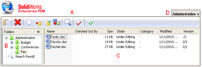

The Web client is very similar in appearance and functionality to the full Enterprise PDM client.
The following elements are common to both:
  • A - Toolbar
  • B - Folder Tree
  • C - File View
D, the Web configuration tab, lets you change from one Web configuration to another.
As in the full Enterprise PDM client, right-clicking a folder in the left pane tree or a folder or file in the right pane file view displays a shortcut menu with applicable commands.
