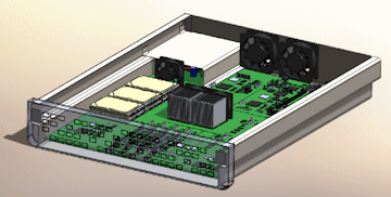

Electronic Cooling Module
The electronic cooling module provides accurate thermal analysis of printed circuit boards (PCBs) and enclosure designs based on more realistic modeling of individual components and PCBs.
These factors improve the accuracy of the thermal modeling:
  • The engineering database now contains more materials and components, and a PCB generator, for the precise thermal modeling of a multilayer PCB.
  • The module accounts for the effects of Joule heating.
  • You can choose to represent geometry as a two-resistor model.
