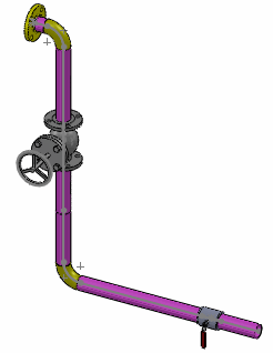

In the image below, the Isolate command is used to isolate a route.
