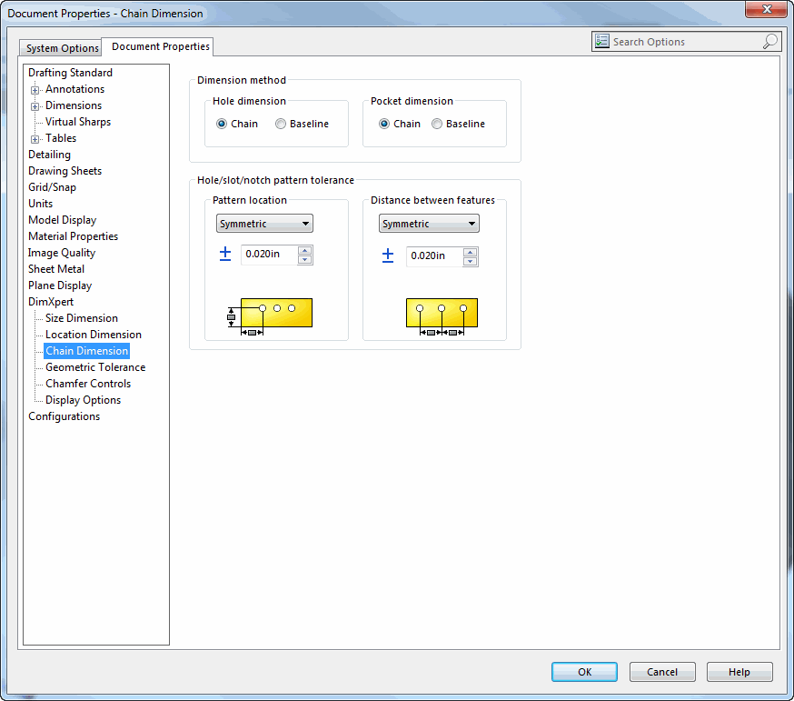

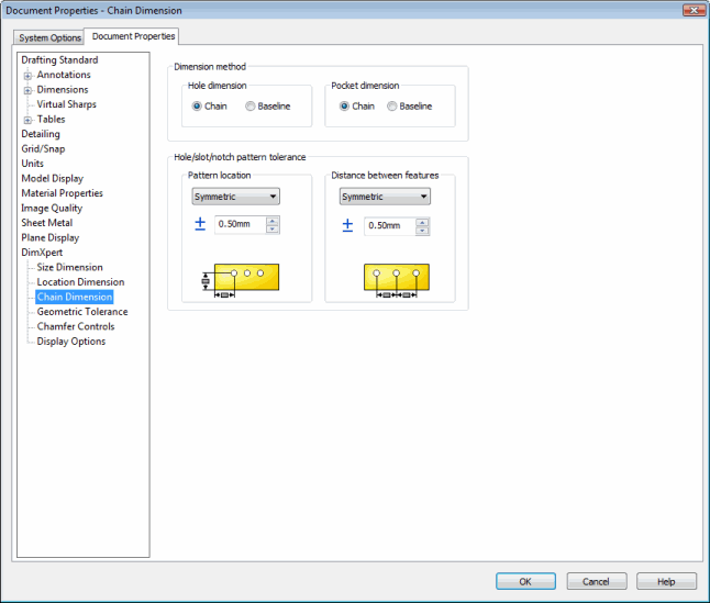

Document Properties > DimXpert > Chain Dimension
Setting
Get/Set Methods
Return Value or <Value>
Comments
Dimension method - Hole dimension - Chain or Baseline IModelDocExtension::GetUserPreferenceToggle(swUserPreferenceToggle_e.swPartDimXpertChainHoleDimensionChain, swUserPreferenceOption_e.swDetailingNoOptionSpecified)
IModelDocExtension::SetUserPreferenceToggle(swUserPreferenceToggle_e.swPartDimXpertChainHoleDimensionChain, swUserPreferenceOption_e.swDetailingNoOptionSpecified, <Value>)
Boolean value Specifies whether to use a chain or baseline type of dimension for holes
Dimension method - Pocket dimension - Chain or Baseline IModelDocExtension::GetUserPreferenceToggle(swUserPreferenceToggle_e.swPartDimXpertChainPocketDimensionChain, swUserPreferenceOption_e.swDetailingNoOptionSpecified)
IModelDocExtension::SetUserPreferenceToggle(swUserPreferenceToggle_e.swPartDimXpertChainPocketDimensionChain, swUserPreferenceOption_e.swDetailingNoOptionSpecified, <Value>)
Boolean value Specifies whether to use a chain or baseline type of dimension for pockets
Hole/slot/notch pattern tolerance - Pattern location - Tolerance type IModelDocExtension::GetUserPreferenceInteger(swUserPreferenceIntegerValue_e.swPartDimXpertChainPatternLocTolType, swUserPreferenceOption_e.swDetailingNoOptionSpecified)
IModelDocExtension::SetUserPreferenceInteger(swUserPreferenceIntegerValue_e.swPartDimXpertChainPatternLocTolType, swUserPreferenceOption_e.swDetailingNoOptionSpecified, swDimXpertTolType_e.<Value>)
See swDimXpertTolType_e for valid options Specifies tolerance type for the pattern location
Hole/slot/notch pattern tolerance - Pattern location - Bilateral or Symmetric tolerance upper value IModelDocExtension::GetUserPreferenceDouble(swUserPreferenceDoubleValue_e.swPartDimXpertChainPatternLocTolUpperValue, swUserPreferenceOption_e.swDetailingNoOptionSpecified)
IModelDocExtension::SetUserPreferenceDouble(swUserPreferenceDoubleValue_e.swPartDimXpertChainPatternLocTolUpperValue, swUserPreferenceOption_e.swDetailingNoOptionSpecified, <Value>)
Double value Specifies:
  • the upper and lower symmetric tolerances
    - or -
  • the upper bilateral tolerance
Hole/slot/notch pattern tolerance - Pattern location - Bilateral tolerance lower value IModelDocExtension::GetUserPreferenceDouble(swUserPreferenceDoubleValue_e.swPartDimXpertChainPatternLocTolLowerValue, swUserPreferenceOption_e.swDetailingNoOptionSpecified)
IModelDocExtension::SetUserPreferenceDouble(swUserPreferenceDoubleValue_e.swPartDimXpertChainPatternLocTolLowerValue, swUserPreferenceOption_e.swDetailingNoOptionSpecified, <Value>)
Double value Specifies the lower bilateral tolerance for the pattern location
Hole/slot/notch pattern tolerance - Pattern location - Block tolerance value IModelDocExtension::GetUserPreferenceInteger(swUserPreferenceIntegerValue_e.swPartDimXpertChainPatternLocBlockPrecision, swUserPreferenceOption_e.swDetailingNoOptionSpecified)
IModelDocExtension::SetUserPreferenceInteger(swUserPreferenceIntegerValue_e.swPartDimXpertChainPatternLocBlockPrecision, swUserPreferenceOption_e.swDetailingNoOptionSpecified, swDimXpertBlockPrecision_e.<Value>)
See swDimXpertBlockPrecision_e for valid options Sets the block precision tolerance for the pattern location
Hole/slot/notch pattern tolerance - Distance between features -Tolerance type IModelDocExtension::GetUserPreferenceInteger(swUserPreferenceIntegerValue_e.swPartDimXpertChainInnerTolType, swUserPreferenceOption_e.swDetailingNoOptionSpecified)
IModelDocExtension::SetUserPreferenceInteger(swUserPreferenceIntegerValue_e.swPartDimXpertChainInnerTolType, swUserPreferenceOption_e.swDetailingNoOptionSpecified, swDimXpertTolType_e.<Value>)
See swDimXpertTolType_e for valid options Specifies tolerance type for the distance between features
Hole/slot notch pattern tolerance - Distance between features - Bilateral or Symmetric tolerance upper value IModelDocExtension::GetUserPreferenceDouble(swUserPreferenceDoubleValue_e.swPartDimXpertChainInnerTolUpperValue, swUserPreferenceOption_e.swDetailingNoOptionSpecified)
IModelDocExtension::SetUserPreferenceDouble(swUserPreferenceDoubleValue_e.swPartDimXpertChainInnerTolUpperValue, swUserPreferenceOption_e.swDetailingNoOptionSpecified, <Value>)
    - or -
Hole/slot notch pattern tolerance - Distance between features - Bilateral tolerance lower value IModelDocExtension::GetUserPreferenceDouble(swUserPreferenceDoubleValue_e.swPartDimXpertChainInnerTolLowerValue, swUserPreferenceOption_e.swDetailingNoOptionSpecified)
IModelDocExtension::SetUserPreferenceDouble(swUserPreferenceDoubleValue_e.swPartDimXpertChainInnerTolLowerValue, swUserPreferenceOption_e.swDetailingNoOptionSpecified, <Value>)
Double value Specifies the lower bilateral tolerance for the distance between features
Hole/slot notch pattern tolerance - Distance between features - Block tolerance value IModelDocExtension::GetUserPreferenceInteger(swUserPreferenceIntegerValue_e.swPartDimXpertChainDistanceBwtnFeatBlockPrecision, swUserPreferenceOption_e.swDetailingNoOptionSpecified)
IModelDocExtension::SetUserPreferenceInteger(swUserPreferenceIntegerValue_e.swPartDimXpertChainDistanceBwtnFeatBlockPrecision, swUserPreferenceOption_e.swDetailingNoOptionSpecified, swDimXpertBlockPrecision_e.<Value>)
See swDimXpertBlockPrecision_e for valid options Sets the block precision tolerance for the distance between features
