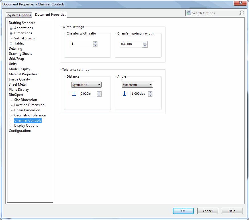

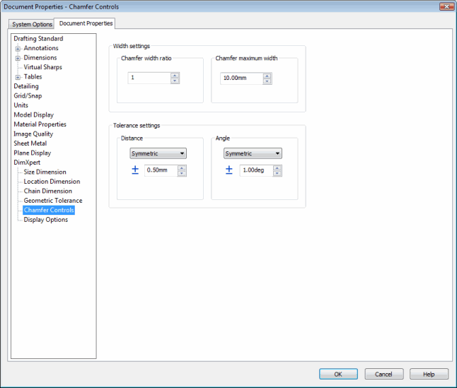

Document Properties > DimXpert > Chamfer Controls
Setting
Get/Set Methods
Return Value or <Value>
Comments
Width settings - Chamfer width ratio IModelDocExtension::GetUserPreferenceDouble(swUserPreferenceDoubleValue_e.swPartDimXpertChamferWidthRatio, swUserPreferenceOption_e.swDetailingNoOptionSpecified)
IModelDocExtension::SetUserPreferenceDouble(swUserPreferenceDoubleValue_e.swPartDimXpertChamferWidthRatio, swUserPreferenceOption_e.swDetailingNoOptionSpecified, <Value>)
Double value Sets the chamfer width ratio
Width settings - Chamfer maximum width IModelDocExtension::GetUserPreferenceDouble(swUserPreferenceDoubleValue_e.swPartDimXpertChamferMaxWidth, swUserPreferenceOption_e.swDetailingNoOptionSpecified)
IModelDocExtension::SetUserPreferenceDouble(swUserPreferenceDoubleValue_e.swPartDimXpertChamferMaxWidth, swUserPreferenceOption_e.swDetailingNoOptionSpecified, <Value>)
Double value Sets the maximum chamfer width
Tolerance settings - Distance - Tolerance type IModelDocExtension::GetUserPreferenceInteger(swUserPreferenceIntegerValue_e.swPartDimXpertChamferDistanceTolType, swUserPreferenceOption_e.swDetailingNoOptionSpecified)
IModelDocExtension::SetUserPreferenceInteger(swUserPreferenceIntegerValue_e.swPartDimXpertChamferDistanceTolType, swUserPreferenceOption_e.swDetailingNoOptionSpecified, swDimXpertTolType_e.<Value>)
See swDimXpertTolType_e for valid options Sets chamfer distance tolerance type
Tolerance settings - Distance - Bilateral or Symmetric tolerance upper value IModelDocExtension::GetUserPreferenceDouble(swUserPreferenceDoubleValue_e.swPartDimXpertChamferDistanceTolUpperValue, swUserPreferenceOption_e.swDetailingNoOptionSpecified)
IModelDocExtension::SetUserPreferenceDouble(swUserPreferenceDoubleValue_e.swPartDimXpertChamferDistanceTolUpperValue, swUserPreferenceOption_e.swDetailingNoOptionSpecified, <Value>)
Double value Specifies:
  • the upper and lower symmetric tolerances
    - or -
  • the upper bilateral tolerance
for chamfer distances
Tolerance settings - Distance - Bilateral tolerance lower value IModelDocExtension::GetUserPreferenceDouble(swUserPreferenceDoubleValue_e.swPartDimXpertChamferDistanceTolLowerValue, swUserPreferenceOption_e.swDetailingNoOptionSpecified)
IModelDocExtension::SetUserPreferenceDouble(swUserPreferenceDoubleValue_e.swPartDimXpertChamferDistanceTolLowerValue, swUserPreferenceOption_e.swDetailingNoOptionSpecified, <Value>)
Double value Specifies the lower bilateral tolerance for chamfer distances
Tolerance settings - Distance - Block tolerance value IModelDocExtension::GetUserPreferenceInteger(swUserPreferenceIntegerValue_e.swPartDimXpertChamferDistanceBlockPrecision, swUserPreferenceOption_e.swDetailingNoOptionSpecified)
IModelDocExtension::SetUserPreferenceInteger(swUserPreferenceIntegerValue_e.swPartDimXpertChamferDistanceBlockPrecision, swUserPreferenceOption_e.swDetailingNoOptionSpecified, swDimXpertBlockPrecision_e.<Value>)
See swDimXpertBlockPrecision_e for valid options Sets the block precision tolerance for chamfer distances
Tolerance settings - Angle - Tolerance type IModelDocExtension::GetUserPreferenceInteger(swUserPreferenceIntegerValue_e.swPartDimXpertChamferAngleTolType, swUserPreferenceOption_e.swDetailingNoOptionSpecified)
IModelDocExtension::SetUserPreferenceInteger(swUserPreferenceIntegerValue_e.swPartDimXpertChamferAngleTolType, swUserPreferenceOption_e.swDetailingNoOptionSpecified, swDimXpertTolType_e.<Value>)
See swDimXpertTolType_e for valid options Sets the chamfer angular tolerance type
Tolerance settings - Angle - Bilateral or Symmetric tolerance upper value IModelDocExtension::GetUserPreferenceDouble(swUserPreferenceDoubleValue_e.swPartDimXpertChamferAngleTolUpperValue, swUserPreferenceOption_e.swDetailingNoOptionSpecified)
IModelDocExtension::SetUserPreferenceDouble(swUserPreferenceDoubleValue_e.swPartDimXpertChamferAngleTolUpperValue, swUserPreferenceOption_e.swDetailingNoOptionSpecified, <Value>)
    - or -
for chamfer angles
Tolerance settings - Angle - Bilateral tolerance lower value IModelDocExtension::GetUserPreferenceDouble(swUserPreferenceDoubleValue_e.swPartDimXpertChamferAngleTolLowerValue, swUserPreferenceOption_e.swDetailingNoOptionSpecified)
IModelDocExtension::SetUserPreferenceDouble(swUserPreferenceDoubleValue_e.swPartDimXpertChamferAngleTolLowerValue, swUserPreferenceOption_e.swDetailingNoOptionSpecified, <Value>)
Double value Specifies the lower bilateral tolerance for chamfer angles
Tolerance settings - Angle - Block tolerance value IModelDocExtension::GetUserPreferenceInteger(swUserPreferenceIntegerValue_e.swPartDimXpertChamferAngleBlockPrecision, swUserPreferenceOption_e.swDetailingNoOptionSpecified)
IModelDocExtension::SetUserPreferenceInteger(swUserPreferenceIntegerValue_e.swPartDimXpertChamferAngleBlockPrecision, swUserPreferenceOption_e.swDetailingNoOptionSpecified, swDimXpertBlockPrecision_e.<Value>)
See swDimXpertBlockPrecision_e for valid options Sets the block precision tolerance for chamfer angles
