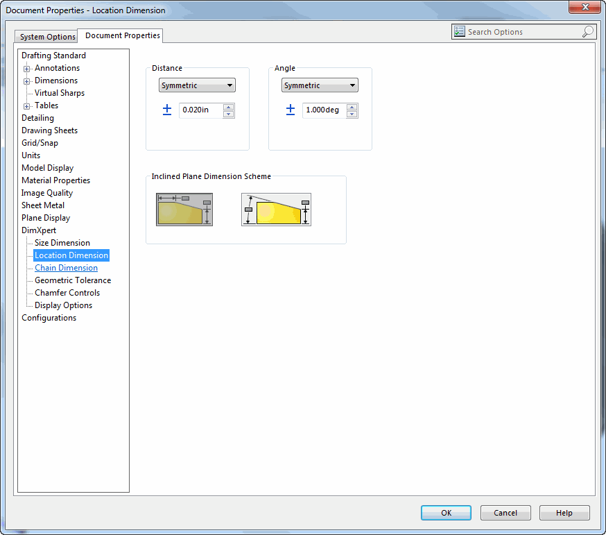

Document Properties > DimXpert > Location Dimension
Setting
Get/Set Methods
Return Value or <Value>
Comments
Distance - Tolerance type IModelDocExtension::GetUserPreferenceInteger(swUserPreferenceIntegerValue_e.swPartDimXpertLocationDistanceTolType, swUserPreferenceOption_e.swDetailingNoOptionSpecified)
IModelDocExtension::SetUserPreferenceInteger(swUserPreferenceIntegerValue_e.swPartDimXpertLocationDistanceTolType, swUserPreferenceOption_e.swDetailingNoOptionSpecified, swDimXpertTolType_e.<Value>)
See swDimXpertTolType_e for valid options Sets the tolerance type for linear dimensions between two features
Distance - Bilateral or Symmetric tolerance upper value IModelDocExtension::GetUserPreferenceDouble(swUserPreferenceDoubleValue_e.swPartDimXpertLocationDistanceTolUpperValue, swUserPreferenceOption_e.swDetailingNoOptionSpecified)
IModelDocExtension::SetUserPreferenceDouble(swUserPreferenceDoubleValue_e.swPartDimXpertLocationDistanceTolUpperValue, swUserPreferenceOption_e.swDetailingNoOptionSpecified, <Value>)
Double value Specifies:
  • the upper and lower symmetric tolerances
    - or -
  • the upper bilateral tolerance
for the distance of linear dimensions between two features
Distance - Bilateral tolerance lower value IModelDocExtension::GetUserPreferenceDouble(swUserPreferenceDoubleValue_e.swPartDimXpertLocationDistanceTolLowerValue, swUserPreferenceOption_e.swDetailingNoOptionSpecified)
IModelDocExtension::SetUserPreferenceDouble(swUserPreferenceDoubleValue_e.swPartDimXpertLocationDistanceTolLowerValue, swUserPreferenceOption_e.swDetailingNoOptionSpecified, <Value>)
Double value Specifies the lower bilateral tolerance for the distance of linear dimensions between two features
Distance - Block tolerance value IModelDocExtension::GetUserPreferenceInteger(swUserPreferenceIntegerValue_e.swPartDimXpertLocationDistanceBlockPrecision, swUserPreferenceOption_e.swDetailingNoOptionSpecified)
IModelDocExtension::SetUserPreferenceInteger(swUserPreferenceIntegerValue_e.swPartDimXpertLocationDistanceBlockPrecision, swUserPreferenceOption_e.swDetailingNoOptionSpecified, swDimXpertBlockPrecision_e.<Value>)
See swDimXpertBlockPrecision_e for valid options Sets the block precision tolerance for the distance of linear dimensions between two features
Angle - Tolerance type IModelDocExtension::GetUserPreferenceInteger(swUserPreferenceIntegerValue_e.swPartDimXpertLocationAngleTolType, swUserPreferenceOption_e.swDetailingNoOptionSpecified)
IModelDocExtension::SetUserPreferenceInteger(swUserPreferenceIntegerValue_e.swPartDimXpertLocationAngleTolType, swUserPreferenceOption_e.swDetailingNoOptionSpecified, swDimXpertTolType_e.<Value>)
See swDimXpertTolType_e for valid options Sets the tolerance type for angular dimensions between two features
Angle - Bilateral or Symmetric tolerance upper value IModelDocExtension::GetUserPreferenceDouble(swUserPreferenceDoubleValue_e.swPartDimXpertLocationAngleTolUpperValue, swUserPreferenceOption_e.swDetailingNoOptionSpecified)
IModelDocExtension::SetUserPreferenceDouble(swUserPreferenceDoubleValue_e.swPartDimXpertLocationAngleTolUpperValue, swUserPreferenceOption_e.swDetailingNoOptionSpecified, <Value>)
    - or -
for the angle of angular dimensions between two features
Angle - Bilateral tolerance lower value IModelDocExtension::GetUserPreferenceDouble(swUserPreferenceDoubleValue_e.swPartDimXpertLocationAngleTolLowerValue, swUserPreferenceOption_e.swDetailingNoOptionSpecified)
IModelDocExtension::SetUserPreferenceDouble(swUserPreferenceDoubleValue_e.swPartDimXpertLocationAngleTolLowerValue, swUserPreferenceOption_e.swDetailingNoOptionSpecified, <Value>)
Double value Specifies the lower bilateral tolerance for the angle of angular dimensions between two features
Angle - Block tolerance value IModelDocExtension::GetUserPreferenceInteger(swUserPreferenceIntegerValue_e.swPartDimXpertLocationAngleBlockPrecision, swUserPreferenceOption_e.swDetailingNoOptionSpecified)
IModelDocExtension::SetUserPreferenceInteger(swUserPreferenceIntegerValue_e.swPartDimXpertLocationAngleBlockPrecision, swUserPreferenceOption_e.swDetailingNoOptionSpecified, swDimXpertBlockPrecision_e.<Value>)
See swDimXpertBlockPrecision_e for valid options Sets the block precision tolerance for the angle of angular dimensions between two features
Inclined Plane Dimension Scheme - Linear or Linear and angle IModelDocExtension::GetUserPreferenceToggle(swUserPreferenceToggle_e.swPartDimXpertLocationInclinedPlane, swUserPreferenceOption_e.swDetailingNoOptionSpecified)
IModelDocExtension::SetUserPreferenceToggle(swUserPreferenceToggle_e.swPartDimXpertLocationInclinedPlane, swUserPreferenceOption_e.swDetailingNoOptionSpecified, <Value>)
Boolean value Specifies whether to locate planes with angular dimensions
