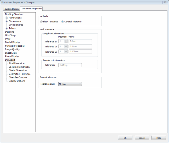

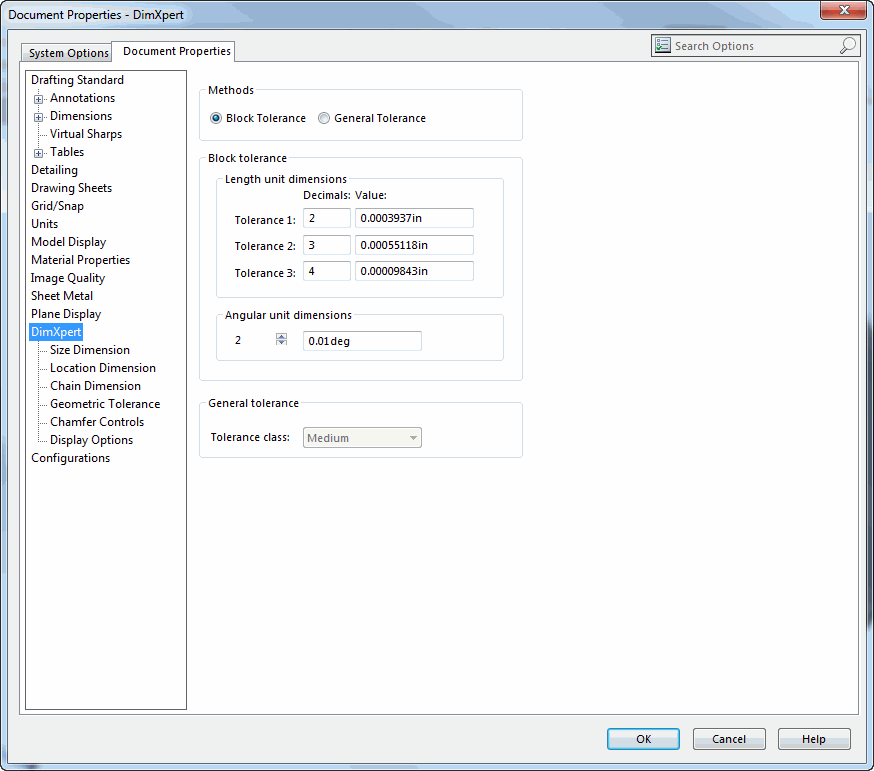

Document Properties > DimXpert
Setting
Get/Set Methods
Return Value or <Value>
Comments
Methods - Block Tolerance or General Tolerance IModelDocExtension::GetUserPreferenceToggle(swUserPreferenceToggle_e.swPartDimXpertBlockTolerance swUserPreferenceOption_e.swDetailingNoOptionSpecified)
IModelDocExtension::SetUserPreferenceToggle(swUserPreferenceToggle_e.swPartDimXpertBlockTolerance, swUserPreferenceOption_e.swDetailingNoOptionSpecified, <Value>)
Boolean value Specifies whether to use Block Tolerances or General Tolerances on dimensions that do not contain tolerances; true for Block Tolerances
Block Tolerance - Length unit dimensions - Tolerance 1 - Decimals IModelDocExtension::GetUserPreferenceInteger(swUserPreferenceIntegerValue_e.swPartDimXpertLengthUnitTol1Decimals, swUserPreferenceOption_e.swDetailingNoOptionSpecified)
IModelDocExtension::SetUserPreferenceInteger(swUserPreferenceIntegerValue_e.swPartDimXpertLengthUnitTol1Decimals, swUserPreferenceOption_e.swDetailingNoOptionSpecified, <Value>)
Integer value Specifies number of decimal places for first tolerance
Block Tolerance - Length unit dimensions - Tolerance 1 - Value IModelDocExtension::GetUserPreferenceDouble(swUserPreferenceDoubleValue_e.swPartDimXpertLengthUnitTol1Value, swUserPreferenceOption_e.swDetailingNoOptionSpecified)
IModelDocExtension::SetUserPreferenceDouble(swUserPreferenceDoubleValue_e.swPartDimXpertLengthUnitTol1Value, swUserPreferenceOption_e.swDetailingNoOptionSpecified, <Value>)
Double value in mm Specifies symmetric plus or minus tolerance for first tolerance
Block Tolerance - Length unit dimensions - Tolerance 2 - Decimals IModelDocExtension::GetUserPreferenceInteger(swUserPreferenceIntegerValue_e.swPartDimXpertLengthUnitTol2Decimals, swUserPreferenceOption_e.swDetailingNoOptionSpecified)
IModelDocExtension::SetUserPreferenceInteger(swUserPreferenceIntegerValue_e.swPartDimXpertLengthUnitTol2Decimals, swUserPreferenceOption_e.swDetailingNoOptionSpecified, <Value>)
Integer value Specifies number of decimal places for second tolerance
Block Tolerance - Length unit dimensions - Tolerance 2 - Value ModelDocExtension::GetUserPreferenceDouble(swUserPreferenceDoubleValue_e.swPartDimXpertLengthUnitTol2Value, swUserPreferenceOption_e.swDetailingNoOptionSpecified)
IModelDocExtension::SetUserPreferenceDouble(swUserPreferenceDoubleValue_e.swPartDimXpertLengthUnitTol2Value, swUserPreferenceOption_e.swDetailingNoOptionSpecified, <Value>)
Double value in mm Specifies symmetric plus or minus tolerance for second tolerance
Block Tolerance - Length unit dimensions - Tolerance 3 - Decimals IModelDocExtension::GetUserPreferenceInteger(swUserPreferenceIntegerValue_e.swPartDimXpertLengthUnitTol3Decimals, swUserPreferenceOption_e.swDetailingNoOptionSpecified)
IModelDocExtension::SetUserPreferenceInteger(swUserPreferenceIntegerValue_e.swPartDimXpertLengthUnitTol3Decimals, swUserPreferenceOption_e.swDetailingNoOptionSpecified, <Value>)
Integer value Specifies number of decimal places for third tolerance
Block Tolerance - Length unit dimensions - Tolerance 3 - Value ModelDocExtension::GetUserPreferenceDouble(swUserPreferenceDoubleValue_e.swPartDimXpertLengthUnitTol3Value, swUserPreferenceOption_e.swDetailingNoOptionSpecified)
IModelDocExtension::SetUserPreferenceDouble(swUserPreferenceDoubleValue_e.swPartDimXpertLengthUnitTol3Value, swUserPreferenceOption_e.swDetailingNoOptionSpecified, <Value>)
Double value in mm Specifies symmetric plus or minus tolerance for third tolerance
Angular unit dimensions - Tolerance ModelDocExtension::GetUserPreferenceDouble(swUserPreferenceDoubleValue_e.swPartDimXpertAngularUnitTolValue, swUserPreferenceOption_e.swDetailingNoOptionSpecified)
IModelDocExtension::SetUserPreferenceDouble(swUserPreferenceDoubleValue_e.swPartDimXpertAngularUnitTolValue, swUserPreferenceOption_e.swDetailingNoOptionSpecified, <Value>)
Double value in degrees Specifies the tolerance value to use for all angular dimensions
General tolerance - Tolerance class IModelDocExtension::GetUserPreferenceInteger(swUserPreferenceIntegerValue_e.swPartDimXpertGeneralToleranceClass, swUserPreferenceOption_e.swDetailingNoOptionSpecified)
IModelDocExtension::SetUserPreferenceInteger(swUserPreferenceIntegerValue_e.swPartDimXpertGeneralToleranceClass, swUserPreferenceOption_e.swDetailingNoOptionSpecified, swDimXpertGeneralTolClass_e.<Value>)
See swDimXpertGeneralTolClass_e for valid options Specifies the part tolerance class
