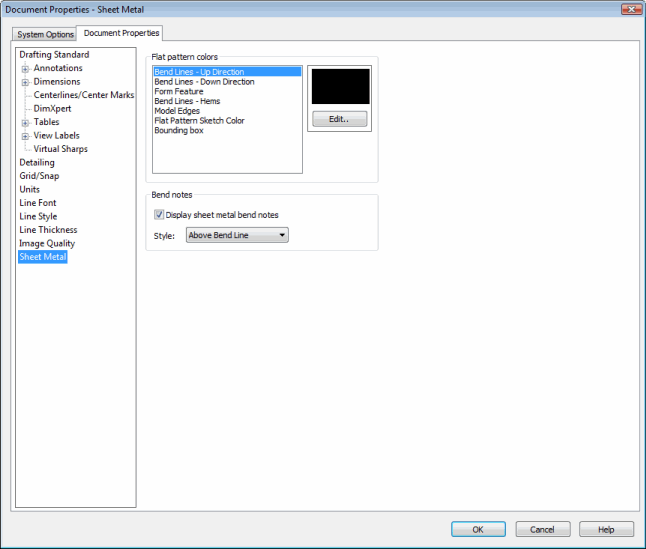

Document Properties > Sheet Metal
For Drawings:

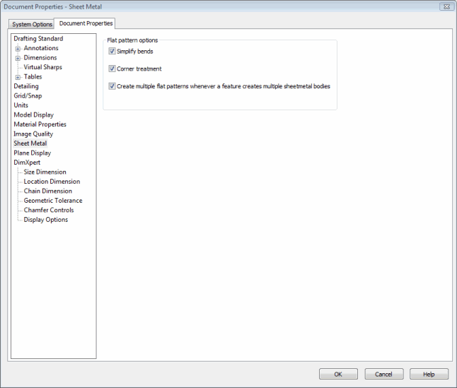

For Parts:
Setting
Get/Set Methods
Return Value or <Value>
Comments
Flat pattern colors - Bend Lines - Up Direction
IModelDocExtension::GetUserPreferenceInteger(swUserPreferenceIntegerValue_e.swSheetMetalColorBendLinesUp, swUserPreferenceOption_e.swDetailingNoOptionSpecified)
IModelDocExtension::SetUserPreferenceInteger(swUserPreferenceIntegerValue_e.swSheetMetalColorBendLinesUp, swUserPreferenceOption_e.swDetailingNoOptionSpecified, <Value>)
Integer RGB value
For drawings only
Flat pattern colors - Bend Lines - Down Direction
IModelDocExtension::GetUserPreferenceInteger(swUserPreferenceIntegerValue_e.swSheetMetalColorBendLinesDown, swUserPreferenceOption_e.swDetailingNoOptionSpecified)
IModelDocExtension::SetUserPreferenceInteger(swUserPreferenceIntegerValue_e.swSheetMetalColorBendLinesDown, swUserPreferenceOption_e.swDetailingNoOptionSpecified, <Value>)
Integer RGB value
For drawings only
Flat pattern colors - Form Feature
IModelDocExtension::GetUserPreferenceInteger(swUserPreferenceIntegerValue_e.swSheetMetalColorFormFeature, swUserPreferenceOption_e.swDetailingNoOptionSpecified)
IModelDocExtension::SetUserPreferenceInteger(swUserPreferenceIntegerValue_e.swSheetMetalColorFormFeature, swUserPreferenceOption_e.swDetailingNoOptionSpecified, <Value>)
Integer RGB value
For drawings only
Flat pattern colors - Bend Lines - Hems
IModelDocExtension::GetUserPreferenceInteger(swUserPreferenceIntegerValue_e.swSheetMetalColorBendLinesHems, swUserPreferenceOption_e.swDetailingNoOptionSpecified)
IModelDocExtension::SetUserPreferenceInteger(swUserPreferenceIntegerValue_e.swSheetMetalColorBendLinesHems, swUserPreferenceOption_e.swDetailingNoOptionSpecified, <Value>)
Integer RGB value
For drawings only
Flat pattern colors - Model Edges
IModelDocExtension::GetUserPreferenceInteger(swUserPreferenceIntegerValue_e.swSheetMetalColorModelEdges, swUserPreferenceOption_e.swDetailingNoOptionSpecified)
IModelDocExtension::SetUserPreferenceInteger(swUserPreferenceIntegerValue_e.swSheetMetalColorModelEdges, swUserPreferenceOption_e.swDetailingNoOptionSpecified, <Value>)
Integer RGB value
For drawings only
Flat pattern colors - Flat Pattern Sketch Color
IModelDocExtension::GetUserPreferenceInteger(swUserPreferenceIntegerValue_e.swSheetMetalColorFlatPatternSketch, swUserPreferenceOption_e.swDetailingNoOptionSpecified)
IModelDocExtension::SetUserPreferenceInteger(swUserPreferenceIntegerValue_e.swSheetMetalColorFlatPatternSketch, swUserPreferenceOption_e.swDetailingNoOptionSpecified, <Value>)
Integer RGB value
For drawings only
Bend notes - Display sheet metal bend notes
IModelDocExtension::GetUserPreferenceToggle(swUserPreferenceToggle_e.swShowSheetMetalBendNotes, swUserPreferenceOption_e.swDetailingNoOptionSpecified)
IModelDocExtension::SetUserPreferenceToggle(swUserPreferenceToggle_e.swShowSheetMetalBendNotes, swUserPreferenceOption_e.swDetailingNoOptionSpecified, <Value>)
Boolean value
Specifies whether to show sheet metal bend notes; For drawings only
Bend notes - Style
IModelDocExtension::GetUserPreferenceInteger(swUserPreferenceIntegerValue_e.swBendNoteStyle, swUserPreferenceOption_e.swDetailingNoOptionSpecified)
IModelDocExtension::SetUserPreferenceInteger(swUserPreferenceIntegerValue_e.swBendNoteStyle, swUserPreferenceOption_e.swDetailingNoOptionSpecified, swBendNoteStyle_e.<Value>)
See swBendNoteStyle_e for valid options
Specifies where to place note for bends; For drawings only
Flat pattern options - Simplify bends
IModelDocExtension::GetUserPreferenceToggle(swUserPreferenceToggle_e.swFlatPatternOpt_SimplifyBends, swUserPreferenceOption_e.swDetailingNoOptionSpecified)
IModelDocExtension::SetUserPreferenceToggle(swUserPreferenceToggle_e.swFlatPatternOpt_SimplifyBends, swUserPreferenceOption_e.swDetailingNoOptionSpecified, <Value>)
Boolean value
For parts only
Flat pattern options - Corner treatment
IModelDocExtension::GetUserPreferenceToggle(swUserPreferenceToggle_e.swFlatPatternOpt_CornerTreatment, swUserPreferenceOption_e.swDetailingNoOptionSpecified)
IModelDocExtension::SetUserPreferenceToggle(swUserPreferenceToggle_e.swFlatPatternOpt_CornerTreatment, swUserPreferenceOption_e.swDetailingNoOptionSpecified, <Value>)
Boolean value
For parts only
Flat pattern options - Create multiple flat patterns whenever a feature creates multiple sheetmetal bodies
IModelDocExtension::GetUserPreferenceToggle(swUserPreferenceToggle_e.swFlatPatternOpt_DisableSplitters, swUserPreferenceOption_e.swDetailingNoOptionSpecified)
IModelDocExtension::SetUserPreferenceToggle(swUserPreferenceToggle_e.swFlatPatternOpt_DisableSplitters, swUserPreferenceOption_e.swDetailingNoOptionSpecified, <Value>)
Boolean value For parts only
