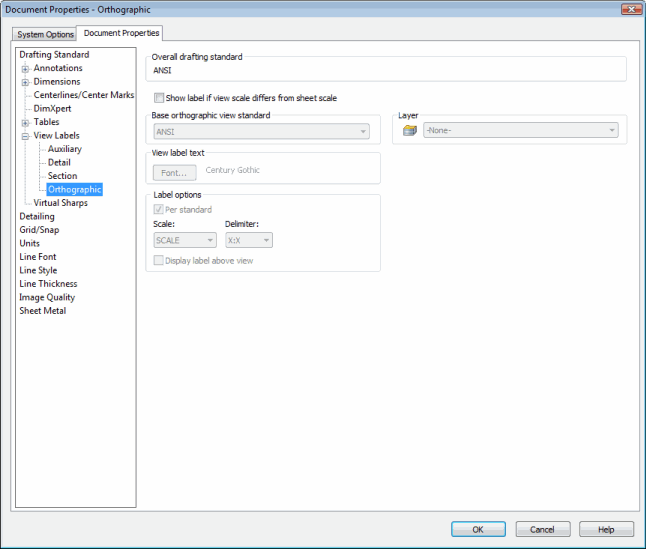

Document Properties > View Labels > Orthographic
Setting
Get/Set Methods
Return Value or <Value>
Comments
Show label if view scale differs from sheet scale
IModelDocExtension::GetUserPreferenceToggle(swUserPreferenceToggle_e.swDetailingOrthoViewLabelsEnableShow, swUserPreferenceOption_e.swDetailingNoOptionSpecified)
IModelDocExtension::SetUserPreferenceToggle(swUserPreferenceToggle_e.swDetailingOrthoViewLabelsEnableShow, swUserPreferenceOption_e.swDetailingNoOptionSpecified, <Value>)
Boolean value
Specifies whether to display the scale label in the orthographic view if the view scale differs from the sheet scale
Base orthographic view standard
IModelDocExtension::GetUserPreferenceInteger(swUserPreferenceIntegerValue_e.swDetailingDimensionStandard, swUserPreferenceOption_e.swDetailingOrthoView)
IModelDocExtension::SetUserPreferenceInteger(swUserPreferenceIntegerValue_e.swDetailingDimensionStandard, swUserPreferenceOption_e.swDetailingOrthoView, swDetailingStandard_e.<Value>)
See swDetailingStandard_e for valid options
Specifies the base orthographic view standard to use
View label text - Font
IModelDocExtension::GetUserPreferenceTextFormat(swUserPreferenceTextFormat_e.swDetailingOrthoLabelTextFormat, swUserPreferenceOption_e.swDetailingNoOptionSpecified)
IModelDocExtension::SetUserPreferenceTextFormat(swUserPreferenceTextFormat_e.swDetailingOrthoLabelTextFormat, swUserPreferenceOption_e.swDetailingNoOptionSpecified, <Value>)
See ITextFormat for font options
To set font property values, implement ITextFormat, set the appropriate ITextFormat member values, and pass the ITextFormat object in the API set method
Label options - Per standard
IModelDocExtension::GetUserPreferenceToggle(swUserPreferenceToggle_e.swDetailingOrthoViewLabels_PerStandard, swUserPreferenceOption_e.swDetailingNoOptionSpecified)
IModelDocExtension::SetUserPreferenceToggle(swUserPreferenceToggle_e.swDetailingOrthoViewLabels_PerStandard, swUserPreferenceOption_e.swDetailingNoOptionSpecified, <Value>)
Boolean value
If...
Then display the orthographic view label according to the format...
True
Required by the current detailing standard
False
Determined by these document-level user preferences:
swDetailingOrthoViewLabels_Scale
swDetailingOrthoViewLabels_Delimiter
Label options - Scale
IModelDocExtension::GetUserPreferenceInteger(swUserPreferenceIntegerValue_e.swDetailingOrthoViewLabels_Scale, swUserPreferenceOption_e.swDetailingNoOptionSpecified)
IModelDocExtension::SetUserPreferenceInteger(swUserPreferenceIntegerValue_e.swDetailingOrthoViewLabels_Scale, swUserPreferenceOption_e.swDetailingNoOptionSpecified, swDetailingViewLabelsScale_e.<Value>)
See swDetailingViewLabelsScale_e for valid options
Specifies the format of the label to use in front of the scale value
Label options - Delimiter
IModelDocExtension::GetUserPreferenceInteger(swUserPreferenceIntegerValue_e.swDetailingOrthoViewLabels_Delimiter, swUserPreferenceOption_e.swDetailingNoOptionSpecified)
IModelDocExtension::SetUserPreferenceInteger(swUserPreferenceIntegerValue_e.swDetailingOrthoViewLabels_Delimiter, swUserPreferenceOption_e.swDetailingNoOptionSpecified, swDetailingViewLabelsDelimiter_e .<Value>)
See swDetailingViewLabelsDelimiter_e for valid options
Specifies the format of the scale value
Label options - Display label above view
IModelDocExtension::GetUserPreferenceToggle(swUserPreferenceToggle_e.swDetailingOrthoViewLabels_AboveView, swUserPreferenceOption_e.swDetailingNoOptionSpecified)
IModelDocExtension::SetUserPreferenceToggle(swUserPreferenceToggle_e.swDetailingOrthoViewLabels_AboveView, swUserPreferenceOption_e.swDetailingNoOptionSpecified, <Value>)
Boolean value
Specifies whether to display the label above the detail view
Layer
IModelDocExtension::GetUserPreferenceString(swUserPreferenceStringValue_e.swDetailingLayer, swUserPreferenceOption_e.swDetailingOrthoView)
IModelDocExtension::SetUserPreferenceString(swUserPreferenceStringValue_e.swDetailingLayer, swUserPreferenceOption_e.swDetailingOrthoView, <Value>)
Valid Options:
  • "BORDER"
  • "CENTER"
  • "CONTINUOUS"
  • "DIM"
  • "FORMAT"
  • "HIDDEN"
  • "RED"
  • "TEXT"
  • "THIN"
This setting is available only on drawings; depending on drawing, some options may not apply
