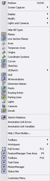

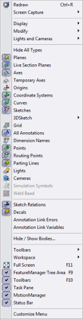

View Menu
NOTE: Available enumerators for View menu items appear in alphabetical order in the following table.
Setting
Get/Set Methods
Return Value or <Value>
Comment
All Annotations
IModelDocExtension::GetUserPreferenceToggle(swUserPreferenceToggle_e.swDisplayAllAnnotations, swUserPreferenceOption_e.swDetailingNoOptionSpecified)
IModelDocExtension::SetUserPreferenceToggle(swUserPreferenceToggle_e.swDisplayAllAnnotations, swUserPreferenceOption_e.swDetailingNoOptionSpecified, <Value>)
Boolean value
Specifies whether to display all annotations
Axes
IModelDocExtension::GetUserPreferenceToggle(swUserPreferenceToggle_e.swDisplayAxes, swUserPreferenceOption_e.swDetailingNoOptionSpecified)
IModelDocExtension::SetUserPreferenceToggle(swUserPreferenceToggle_e.swDisplayAxes, swUserPreferenceOption_e.swDetailingNoOptionSpecified, <Value>)
Boolean value
Specifies whether to display axes in graphics area
Cameras
IModelDocExtension::GetUserPreferenceToggle(swUserPreferenceToggle_e.swDisplayCameras, swUserPreferenceOption_e.swDetailingNoOptionSpecified)
IModelDocExtension::SetUserPreferenceToggle(swUserPreferenceToggle_e.swDisplayCameras, swUserPreferenceOption_e.swDetailingNoOptionSpecified, <Value>)
Boolean value
Specifies whether to display cameras
Coordinate Systems
IModelDocExtension::GetUserPreferenceToggle(swUserPreferenceToggle_e.swDisplayCoordSystems, swUserPreferenceOption_e.swDetailingNoOptionSpecified)
IModelDocExtension::SetUserPreferenceToggle(swUserPreferenceToggle_e.swDisplayCoordSystems, swUserPreferenceOption_e.swDetailingNoOptionSpecified, <Value>)
Boolean value
Specifies whether to display temporary axes in graphics area
Curves
IModelDocExtension::GetUserPreferenceToggle(swUserPreferenceToggle_e.swDisplayCurves, swUserPreferenceOption_e.swDetailingNoOptionSpecified)
IModelDocExtension::SetUserPreferenceToggle(swUserPreferenceToggle_e.swDisplayCurves, swUserPreferenceOption_e.swDetailingNoOptionSpecified, <Value>)
Boolean value
Specifies whether to display curves in graphics area
Dimension Names
IModelDocExtension::GetUserPreferenceToggle(swUserPreferenceToggle_e.swShowDimensionNames, swUserPreferenceOption_e.swDetailingNoOptionSpecified)
IModelDocExtension::SetUserPreferenceToggle(swUserPreferenceToggle_e.swShowDimensionNames, swUserPreferenceOption_e.swDetailingNoOptionSpecified, <Value>)
Boolean value
Specifies whether to show dimension names
Hide All Types
IModelDocExtension::GetUserPreferenceToggle(swUserPreferenceToggle_e.swViewDisplayHideAllTypes, swUserPreferenceOption_e.swDetailingNoOptionSpecified)
IModelDocExtension::SetUserPreferenceToggle(swUserPreferenceToggle_e.swViewDisplayHideAllTypes, swUserPreferenceOption_e.swDetailingNoOptionSpecified, <Value>)
Boolean value
Specifies whether to hide all items in table
Lights
IModelDocExtension::GetUserPreferenceToggle(swUserPreferenceToggle_e.swDisplayLights, swUserPreferenceOption_e.swDetailingNoOptionSpecified)
IModelDocExtension::SetUserPreferenceToggle(swUserPreferenceToggle_e.swDisplayLights, swUserPreferenceOption_e.swDetailingNoOptionSpecified, <Value>)
Boolean value
Specifies whether to display lights
Live Section Planes
IModelDocExtension::GetUserPreferenceToggle(swUserPreferenceToggle_e.swDisplayLiveSections, swUserPreferenceOption_e.swDetailingNoOptionSpecified)
IModelDocExtension::SetUserPreferenceToggle(swUserPreferenceToggle_e.swDisplayLiveSections, swUserPreferenceOption_e.swDetailingNoOptionSpecified, <Value>)
Boolean value
Specifies whether to display live sections in graphics area
Origins
IModelDocExtension::GetUserPreferenceToggle(swUserPreferenceToggle_e.swDisplayOrigins, swUserPreferenceOption_e.swDetailingNoOptionSpecified)
IModelDocExtension::SetUserPreferenceToggle(swUserPreferenceToggle_e.swDisplayOrigins, swUserPreferenceOption_e.swDetailingNoOptionSpecified, <Value>)
Boolean value
Specifies whether to display origins in graphics area
Planes
IModelDocExtension::GetUserPreferenceToggle(swUserPreferenceToggle_e.swDisplayPlanes, swUserPreferenceOption_e.swDetailingNoOptionSpecified)
IModelDocExtension::SetUserPreferenceToggle(swUserPreferenceToggle_e.swDisplayPlanes, swUserPreferenceOption_e.swDetailingNoOptionSpecified, <Value>)
Boolean value
Specifies whether to display planes in graphics area
Routing Points
IModelDocExtension::GetUserPreferenceToggle(swUserPreferenceToggle_e.swDisplayReferencePoints, swUserPreferenceOption_e.swDetailingNoOptionSpecified)
IModelDocExtension::SetUserPreferenceToggle(swUserPreferenceToggle_e.swDisplayReferencePoints, swUserPreferenceOption_e.swDetailingNoOptionSpecified, <Value>)
IModelDocExtension::GetUserPreferenceToggle(swUserPreferenceToggle_e.swDisplayReferencePoints2, swUserPreferenceOption_e.swDetailingNoOptionSpecified)
IModelDocExtension::SetUserPreferenceToggle(swUserPreferenceToggle_e.swDisplayReferencePoints2, swUserPreferenceOption_e.swDetailingNoOptionSpecified, <Value>)
IModelDocExtension::GetUserPreferenceToggle(swUserPreferenceToggle_e.swDisplayRoutePoints, swUserPreferenceOption_e.swDetailingNoOptionSpecified)
IModelDocExtension::SetUserPreferenceToggle(swUserPreferenceToggle_e.swDisplayRoutePoints, swUserPreferenceOption_e.swDetailingNoOptionSpecified, <Value>)
Boolean value
Specifies whether to display routing or reference points in graphics area
Simulation Symbols
IModelDocExtension::GetUserPreferenceToggle(swUserPreferenceToggle_e.swDisplaySimulationSymbol, swUserPreferenceOption_e.swDetailingNoOptionSpecified)
IModelDocExtension::SetUserPreferenceToggle(swUserPreferenceToggle_e.swDisplaySimulationSymbol, swUserPreferenceOption_e.swDetailingNoOptionSpecified, <Value>)
Boolean value
Specifies whether to display simulation symbols (for SolidWorks Simulation only)
Sketch Relations
IModelDocExtension::GetUserPreferenceToggle(swUserPreferenceToggle_e.swViewSketchRelations, swUserPreferenceOption_e.swDetailingNoOptionSpecified)
IModelDocExtension::SetUserPreferenceToggle(swUserPreferenceToggle_e.swViewSketchRelations, swUserPreferenceOption_e.swDetailingNoOptionSpecified, <Value>)
Boolean value
Specifies whether to display sketch relation symbols
Sketches
IModelDocExtension::GetUserPreferenceToggle(swUserPreferenceToggle_e.swDisplaySketches, swUserPreferenceOption_e.swDetailingNoOptionSpecified)
IModelDocExtension::SetUserPreferenceToggle(swUserPreferenceToggle_e.swDisplaySketches, swUserPreferenceOption_e.swDetailingNoOptionSpecified, <Value>)
Boolean value
Specifies to display sketches in graphics area
Temporary Axes
IModelDocExtension::GetUserPreferenceToggle(swUserPreferenceToggle_e.swDisplayTemporaryAxes, swUserPreferenceOption_e.swDetailingNoOptionSpecified)
IModelDocExtension::SetUserPreferenceToggle(swUserPreferenceToggle_e.swDisplayTemporaryAxes, swUserPreferenceOption_e.swDetailingNoOptionSpecified, <Value>)
Boolean value
