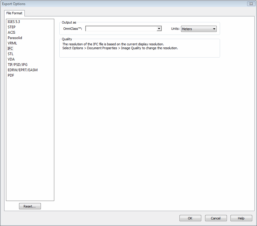

File > Save As > Save as type > IFC 2.3 > Options > IFC
Setting
Get/Set Methods
Return Value
or
<Value>
or
<OnFlag>
Comment
Output as - OmniClass
ISldWorks::GetUserPreferenceStringValue(swUserPreferenceStringValue_e.swExportIFCType)
ISldWorks::SetUserPreferenceStringValue(swUserPreferenceStringValue_e.swExportIFCType, <Value>)
String value
Output as - Unit
ISldWorks::GetUserPreferenceIntegerValue(swUserPreferenceIntegerValue_e.swExportIFCUnits)
ISldWorks::SetUserPreferenceIntegerValue(swUserPreferenceIntegerValue_e.swExportIFCUnits, swLengthUnit_e.<Value>)
Any of the following swLengthUnit_e values:
  • 0 = swMM (millimeters)
  • 1 = swCM (centimeters)
  • 2 = swMETER
  • 3 = swINCHES
  • 4 = swFEET
