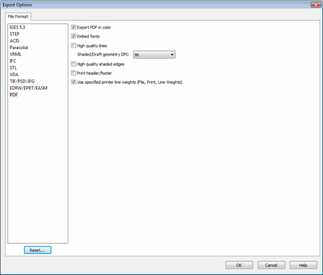

File > Save As > Save as type > Adobe Portable Document Format > Options > PDF
Setting
Get/Set Methods
Return Value
or
<OnFlag>
Comment
Export PDF in color
ISldWorks::GetUserPreferenceToggle(swUserPreferenceToggle_e.swPDFExportInColor)
ISldWorks::SetUserPreferenceToggle(swUserPreferenceToggle_e.swPDFExportInColor, <OnFlag>)
Boolean value
Specifies whether to save documents in color when saving to PDF
Embed fonts
ISldWorks::GetUserPreferenceToggle(swUserPreferenceToggle_e.swPDFExportEmbedFonts)
ISldWorks::SetUserPreferenceToggle(swUserPreferenceToggle_e.swPDFExportEmbedFonts, <OnFlag>)
Boolean value
Specifies whether to embed fonts when saving documents  to PDF
High quality
ISldWorks::GetUserPreferenceToggle(swUserPreferenceToggle_e.swPDFExportHighQuality)
ISldWorks::SetUserPreferenceToggle(swUserPreferenceToggle_e.swPDFExportHighQuality, <OnFlag>)
Boolean value
Specifies whether to save drawing documents in high quality when saving to PDF
Shaded/Draft geometry DPI
See Comment
See Comment
Not currently available in the SolidWorks API
Print header/footer
ISldWorks::GetUserPreferenceToggle(swUserPreferenceToggle_e.swPDFExportPrintHeaderFooter)
ISldWorks::SetUserPreferenceToggle(swUserPreferenceToggle_e.swPDFExportPrintHeaderFooter, <OnFlag>)
Boolean value
Specifies whether to use the header and footer specified in File > Print > Header Footer when saving documents to PDF
Use specified printer line weights (File > Print > Line Weights)
ISldWorks::GetUserPreferenceToggle(swUserPreferenceToggle_e.swPDFExportUseCurrentPrintLineWeights)
ISldWorks::SetUserPreferenceToggle(swUserPreferenceToggle_e.swPDFExportUseCurrentPrintLineWeights, <OnFlag>)
Boolean value
Specifies whether to use the default printer line weights when saving documents to PDF
