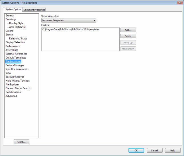

System Options > File Locations
This topic contains two tables. The information in the table:
  • appearing immediately after the screen capture of the System Options - File Locations dialog corresponds to the settings on that dialog.
  • titled Obsolete Enumerators contains enumerators that previously appeared on the System Options - File Locations dialog, but are now obsolete and no longer appear on that dialog.

swFileLocationsScenes
Obsolete
Page:   System Options > File Locations
Web Help Content Version: API Help (English only) 2011 SP05
