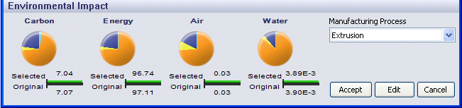

Environmental Impact Dashboard
The dashboard provides real-time feedback about the environmental impact of the materials from the Find Similar Material dialog box. This dashboard is similar to the Environmental Impact dashboard in the Sustainability Task Pane.
Pie charts and comparison bars Pie charts display the environmental impact of the material you selected in the Similar Materials list. The bars compare the selected material (Selected) to the material with which you launched Find Similar (Original).
Manufacturing Process Sets the manufacturing process for the selected material.
Accept Populates the Material section of the SustainabilityTask Pane with the Class and Name of the selected material and closes the Find Similar Material dialog box.
Edit Clears the list of similar materials and displays the default search criteria box so you can perform a new search for similar materials using different settings.
Cancel Closes the Find Similar Material dialog box.
