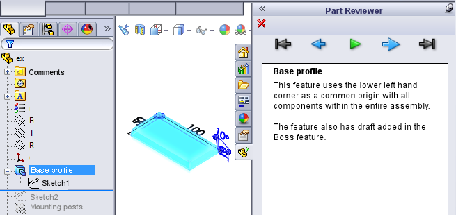

You can use Part Reviewer to review how parts are created feature-by-feature. Part Reviewer can help you learn best practices for creating various types of parts.
Part Reviewer sample parts are located in the SolidWorks Forum. These sample parts contain comments about their features to teach you how they were created and why they were used. You can also create your own parts and add your own comments.
To access Part Reviewer, click Tools > Add-Ins. Under SolidWorks Add-ins, select SolidWorks Part Reviewer.
The Part Reviewer tab  appears in the Task Pane.
