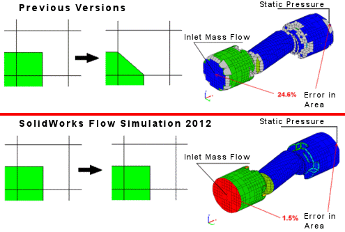

Enhanced meshing technology improves the CAD geometry representation by the computational mesh. As a result, the accuracy of calculation is improved with fewer number of cells.
In previous releases, there were partial cells that simplified the geometry by cutting the sharp corners residing in the cell. The new technology uses additional information from
the CAD (e.g. edges) to construct the non-simplified geometry, wherever possible.
