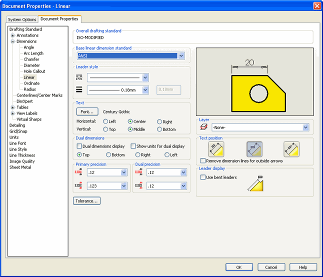

Setting |
Get/Set Methods |
Return Value or <Value> |
Comments |
Base linear dimension standard |
IModelDocExtension::GetUserPreferenceInteger(swUserPreferenceIntegerValue_e.swDetailingDimensionStandard,
swUserPreferenceOption_e.swDetailingLinearDimension)
IModelDocExtension::SetUserPreferenceInteger(swUserPreferenceIntegerValue_e.swDetailingDimensionStandard,
swUserPreferenceOption_e.swDetailingLinearDimension, swDetailingStandard_e.<Value>) |
See swDetailingStandard_e
for valid options |
Specifies the base linear dimensioning standard to use |
Leader style - Leader Style |
IModelDocExtension::GetUserPreferenceInteger(swUserPreferenceIntegerValue_e.swLineFontDimensionsStyle,
IModelDocExtension::SetUserPreferenceInteger(swUserPreferenceIntegerValue_e.swLineFontDimensionsStyle,
swUserPreferenceOption_e.swDetailingLinearDimension, swLineStyles_e.<Value>) |
See swLineStyles_e
for valid options |
Specifies style of lines for linear dimensions |
Leader style - Leader Thickness |
IModelDocExtension::GetUserPreferenceInteger(swUserPreferenceIntegerValue_e.swLineFontDimensionsThickness,
IModelDocExtension::SetUserPreferenceInteger(swUserPreferenceIntegerValue_e.swLineFontDimensionsThickness,
swUserPreferenceOption_e.swDetailingLinearDimension, swLineWeights_e.<Value>) |
See swLineWeights_e
for valid options |
Specifies thickness of lines for linear dimensions |
Leader style - Custom Thickness |
IModelDocExtension::GetUserPreferenceDouble(swUserPreferenceDoubleValue_e.swLineFontDimensionsThicknessCustom,
IModelDocExtension::SetUserPreferenceDouble(swUserPreferenceDoubleValue_e.swLineFontDimensionsThicknessCustom,
swUserPreferenceOption_e.swDetailingLinearDimension, <Value>) |
Double value |
Specifies a custom thickness for lines in linear dimensions; sets Custom Thickness
to the specified thickness and
Leader Thickness to Custom Size |
Text - Font... |
IModelDocExtension::GetUserPreferenceTextFormat(swUserPreferenceTextFormat_e.swDetailingDimensionTextFormat,
IModelDocExtension::SetUserPreferenceTextFormat(swUserPreferenceTextFormat_e.swDetailingDimensionTextFormat,
See ITextFormat
for font options |
To set font property values, implement ITextFormat, set the appropriate
ITextFormat member values, and pass the ITextFormat object in the API
set method |
Text - Horizontal |
IModelDocExtension::GetUserPreferenceInteger(swUserPreferenceIntegerValue_e.swDetailingDimensionTextAlignmentHorizontal,
IModelDocExtension::SetUserPreferenceInteger(swUserPreferenceIntegerValue_e.swDetailingDimensionTextAlignmentHorizontal,
swUserPreferenceOption_e.swDetailingLinearDimension, swTextJustification_e.<Value>) |
See swTextJustification_e
for valid options |
Text - Vertical |
IModelDocExtension::GetUserPreferenceInteger(swUserPreferenceIntegerValue_e.swDetailingDimensionTextAlignmentVertical,
IModelDocExtension::SetUserPreferenceInteger(swUserPreferenceIntegerValue_e.swDetailingDimensionTextAlignmentVertical,
swUserPreferenceOption_e.swDetailingLinearDimension, swTextAlignmentVertical_e.<Value>) |
See swTextAlignmentVertical_e
for valid options |
Dual dimensions - Dual dimensions display |
IModelDocExtension::GetUserPreferenceToggle(swUserPreferenceToggle_e.swDetailingDualDimensions,
IModelDocExtension::SetUserPreferenceToggle(swUserPreferenceToggle_e.swDetailingDualDimensions,
Boolean value |
Specifies whether to display dimensions in two kinds of units |
Dual dimensions - Show units for dual display |
IModelDocExtension::GetUserPreferenceToggle(swUserPreferenceToggle_e.swDetailingShowDualDimensionUnits,
IModelDocExtension::SetUserPreferenceToggle(swUserPreferenceToggle_e.swDetailingShowDualDimensionUnits,
Boolean value |
Specifies whether to display units for dual dimensions |
Dual dimensions - Dimension position |
IModelDocExtension::GetUserPreferenceInteger(swUserPreferenceIntegerValue_e.swDetailingDualDimPosition,
IModelDocExtension::SetUserPreferenceInteger(swUserPreferenceIntegerValue_e.swDetailingDualDimPosition,
swUserPreferenceOption_e.swDetailingLinearDimension, swDetailingDualDimPosition_e.<Value>) |
See swDetailingDualDimPosition_e
for valid options |
Positions the display of dimensions in two kinds of units |
Primary precision - Unit Precision |
IModelDocExtension::GetUserPreferenceInteger(swUserPreferenceIntegerValue_e.swDetailingLinearDimPrecision,
IModelDocExtension::SetUserPreferenceInteger(swUserPreferenceIntegerValue_e.swDetailingLinearDimPrecision,
Number of decimal places to display; 0 through 8 |
Specifies primary precision for linear dimension |
Primary precision - Tolerance Precision |
IModelDocExtension::GetUserPreferenceInteger(swUserPreferenceIntegerValue_e.swDetailingLinearTolPrecision,
IModelDocExtension::SetUserPreferenceInteger(swUserPreferenceIntegerValue_e.swDetailingLinearTolPrecision,
swUserPreferenceOption_e.swDetailingLinearDimension, swDimensionPrecisionSettings_e
.<Value>) |
See swDimensionPrecisionSettings_e
for valid options |
Specifies primary precision for tolerance |
Dual precision - Unit Precision |
IModelDocExtension::GetUserPreferenceInteger(swUserPreferenceIntegerValue_e.swDetailingAltLinearDimPrecision,
IModelDocExtension::SetUserPreferenceInteger(swUserPreferenceIntegerValue_e.swDetailingAltLinearDimPrecision,
Specifies dual precision for alternate linear dimension |
Dual precision - Tolerance Precision |
IModelDocExtension::GetUserPreferenceInteger(swUserPreferenceIntegerValue_e.swDetailingAltLinearTolPrecision,
IModelDocExtension::SetUserPreferenceInteger(swUserPreferenceIntegerValue_e.swDetailingAltLinearTolPrecision,
.<Value>) |
for valid options |
Specifies dual precision for alternate linear tolerance |
Tolerance... |
See Comments |
See Comments |
See Dimension Tolerance |
Layer |
IModelDocExtension::GetUserPreferenceString(swUserPreferenceStringValue_e.swDetailingLayer,
IModelDocExtension::SetUserPreferenceString(swUserPreferenceStringValue_e.swDetailingLayer,
Valid Options:
"Border"
"Dimensions"
"Notes"
"BOM"
"FORMAT"
This setting is available only on drawings; depending on drawing, some
options may not apply |
Text position |
IModelDocExtension::GetUserPreferenceInteger(swUserPreferenceIntegerValue_e.swDetailingDimensionTextAndLeaderStyle,
IModelDocExtension::SetUserPreferenceInteger(swUserPreferenceIntegerValue_e.swDetailingDimensionTextAndLeaderStyle,
swUserPreferenceOption_e.swDetailingLinearDimension, swDisplayDimensionLeaderText_e.<Value>) |
See swDisplayDimensionLeaderText_e
for valid options |
Specifies how to display leader |
Leader display - Use bent leaders |
IModelDocExtension::GetUserPreferenceToggle(swUserPreferenceToggle_e.swDetailingDimANSIBentLeader,
IModelDocExtension::SetUserPreferenceToggle(swUserPreferenceToggle_e.swDetailingDimANSIBentLeader,
Boolean value |
Specifies whether to use bent leaders only if detailing standard is
ANSI |
