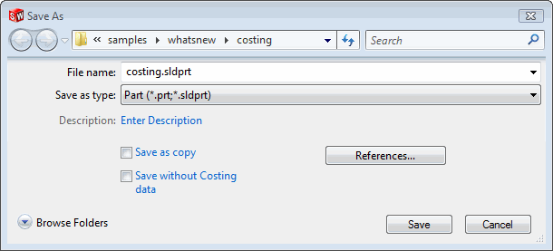

Save without Costing data |
IModelDocExtension::GetUserPreferenceToggle(swUserPreferenceToggle_e.swSaveWithoutCostingData)
IModelDocExtension::SetUserPreferenceToggle(swUserPreferenceToggle_e.swSaveWithoutCostingData,
<OnFlag>) |
Boolean value |
Specifies whether to save the sheet metal part without including any Costing
data |
