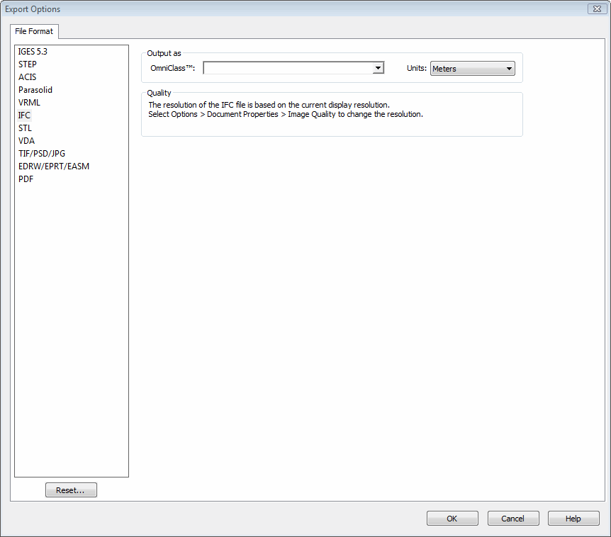

Output as - Unit |
ISldWorks::GetUserPreferenceIntegerValue(swUserPreferenceIntegerValue_e.swExportIFCUnits)
ISldWorks::SetUserPreferenceIntegerValue(swUserPreferenceIntegerValue_e.swExportIFCUnits,
swLengthUnit_e.<Value>)
Any of the following swLengthUnit_e
values:
0 = swMM (millimeters)
1 = swCM (centimeters)
2 = swMETER
3 = swINCHES
4 = swFEET
