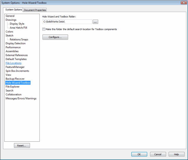

Hole Wizard and Toolbox folder |
ISldWorks::GetUserPreferenceStringValue(swUserPreferenceStringValue_e.swHoleWizardToolBoxFolder)
ISldWorks::SetUserPreferenceStringValue(swUserPreferenceStringValue_e.swHoleWizardToolBoxFolder,
<Value>) |
String value |
Specifies the location of the Hole Wizard/Toolbox folder |
Make this folder the default search
location for Toolbox components |
ISldWorks::GetUserPreferenceToggle(swUserPreferenceToggle_e.swUseFolderAsDefaultSearchLocation)
ISldWorks::SetUserPreferenceToggle(swUserPreferenceToggle_e.swUseFolderAsDefaultSearchLocation, <Value>) |
Boolean value |
Specifies whether to make the specified Hole
Wizard and Toolbox folder the default search location for Toolbox components |
