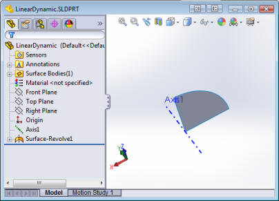

' 3. Create a model that consists of the following features:
'    * Surface-Revolve1 (sketch a line segment and surface-revolve it 90 degrees about an axis)
'    * Axis1
