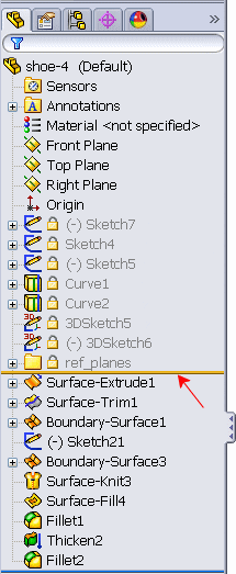

You drag the freeze bar to freeze features.
  1. Move the pointer over the freeze bar.
    The pointer changes to FRZ_freeze_pointer.gif.
  2. Drag the freeze bar down below ref_planes FM_folder.gif.
    When the freeze bar is at the top of the tree, you can also right-click a feature and click Freeze to freeze that feature and all features above it in the FeatureManager design tree.
    Features above the freeze bar are frozen – you cannot edit them, and they are excluded from rebuilds of the model. Frozen features are indicated by an icon FM_freeze.gif and gray text.
