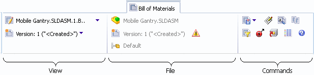

Bill of Materials Tab - Named BOM
Use the Bill of Materials tab to view named BOMs. Named BOMs can be saved from computed BOMs and SolidWorks BOMs.
To display a computed BOM, in your local file vault, select a SolidWorks assembly or drawing. On the Bill of Materials tab, for BOM, select a named BOM icon or SolidWorks named BOM icon.
BOM_UI_Named
View
Information about the named BOM.
BOM_UI_Named_BOM_BOM_control Bill of Materials The BOM type. Select a named BOM or SolidWorks named BOM .
  BOM Version Version of Bill of Materials being viewed.
File
Information about the file associated with the named BOM.
Source (Read-only) The assembly or drawing that is associated with the named BOM.
Source version (Read-only) The version of the associated file.
The Update Source Version icon at the end of the text field appears as if a more recent version of the source file exists and you can update the named BOM data to match it.
If the icon appears as , the named BOM is based on the latest version of the source file.
Configuration (Read-only) The configuration of the associated file.
Commands
BOM_UI_Save_BOM Save Select Save to save the BOM, or Save As to save a new named BOM.
BOM_UI_Open_as_CSV_file Open As CSV Opens the BOM in Excel as a comma-delimited file.
BOM_UI_Switch_View Switch View Toggles between the Bill of Materials view and the File view.
