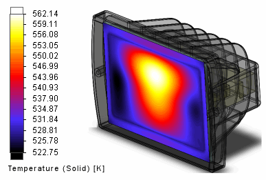

Color Bar
Several usability improvements are implemented for the Color Bar.
  • You can dynamically adjust the palette size, position, and number of levels of the Color Bar.
  • A new option Auto scale in the Font dialog box adjust automatically the font size for text in the Color Bar.
  • You can define the default settings and appearance of the Color Bar under General Options.
  • The Color Bar dialog box now contains a range of new palettes optimized for visualization of the temperature distribution.
