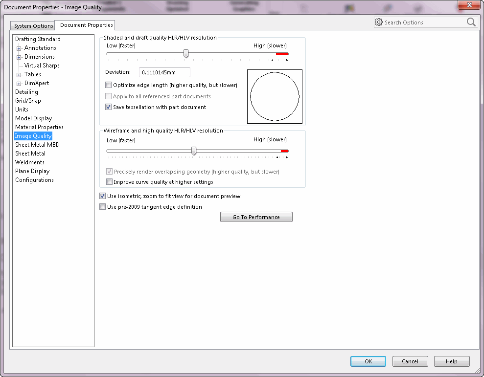

Document Properties > Image Quality
Setting
Get/Set Methods
Return Value or <Value>
Comments
Shaded and draft quality HLR/HLV resolution - Quality
IModelDocExtension::GetUserPreferenceInteger(swUserPreferenceIntegerValue_e.swImageQualityShaded, swUserPreferenceOption_e.swDetailingNoOptionSpecified)
IModelDocExtension::SetUserPreferenceInteger(swUserPreferenceIntegerValue_e.swImageQualityShaded, swUserPreferenceOption_e.swDetailingNoOptionSpecified, swImageQualityShaded_e.<Value>)
See swImageQualityShaded_e for valid options
Specifies the tessellation of cylindrical surfaces for shaded rendering output
Shaded and draft quality HLR/HLV resolution - Deviation
IModelDocExtension::GetUserPreferenceDouble(swUserPreferenceDoubleValue_e.swImageQualityShadedDeviation, swUserPreferenceOption_e.swDetailingNoOptionSpecified)
IModelDocExtension::SetUserPreferenceDouble(swUserPreferenceDoubleValue_e.swImageQualityShadedDeviation, swUserPreferenceOption_e.swDetailingNoOptionSpecified, <Value>)
Double value
Specifies maximum chordal deviation in effect at the various tuning levels; use IModelDocExtension::GetUserPreferenceDoubleValueRange to get the current and valid minimum and maximum values
Shaded and draft quality HLR/HLV resolution - Optimize edge length (higher quality, but slower)
IModelDocExtension::GetUserPreferenceToggle(swUserPreferenceToggle_e.swImageQualityUseHighQualityEdgeSize, swUserPreferenceOption_e.swDetailingNoOptionSpecified)
IModelDocExtension::SetUserPreferenceToggle(swUserPreferenceToggle_e.swImageQualityUseHighQualityEdgeSize, swUserPreferenceOption_e.swDetailingNoOptionSpecified, <Value>)
Boolean value
Specifies whether to increase image quality
Shaded and draft quality HLR/HLV resolution - Apply to all referenced part documents
IModelDocExtension::GetUserPreferenceToggle(swUserPreferenceToggle_e.swImageQualityApplyToAllReferencedPartDoc swUserPreferenceOption_e.swDetailingNoOptionSpecified)
IModelDocExtension::SetUserPreferenceToggle(swUserPreferenceToggle_e.swImageQualityApplyToAllReferencedPartDoc , swUserPreferenceOption_e.swDetailingNoOptionSpecified, <Value>)
Boolean value
For assemblies only; specifies whether to apply image quality settings to all part documents referenced by active document
Shaded and draft quality HLR/HLV resolution - Save tessellation with part document
IModelDocExtension::GetUserPreferenceToggle(swUserPreferenceToggle_e.swImageQualitySaveTesselationWithPartDoc, swUserPreferenceOption_e.swDetailingNoOptionSpecified)
IModelDocExtension::SetUserPreferenceToggle(swUserPreferenceToggle_e.swImageQualitySaveTesselationWithPartDoc, swUserPreferenceOption_e.swDetailingNoOptionSpecified, <Value>)
Boolean value
Specifies whether to save display information with the part document
Wireframe and high quality HLR/HLV resolution - quality of wireframe display output
IModelDocExtension::GetUserPreferenceInteger(swUserPreferenceIntegerValue_e.swImageQualityWireframe, swUserPreferenceOption_e.swDetailingNoOptionSpecified)
IModelDocExtension::SetUserPreferenceInteger(swUserPreferenceIntegerValue_e.swImageQualityWireframe, swUserPreferenceOption_e.swDetailingNoOptionSpecified, swImageQualityWireframe_e.<Value>)
See swImageQualityWireframe_e for valid options
Specifies the wireframe quality:  optimal or custom
Wireframe and high quality HLR/HLV resolution - wireframe quality
IModelDocExtension::GetUserPreferenceInteger(swUserPreferenceIntegerValue_e.swImageQualityWireframeValue, swUserPreferenceOption_e.swDetailingNoOptionSpecified)
IModelDocExtension::SetUserPreferenceInteger(swUserPreferenceIntegerValue_e.swImageQualityWireframeValue, swUserPreferenceOption_e.swDetailingNoOptionSpecified, <Value>)
Integer value (1 - 100)
Specifies value for custom swImageQualityWireframe quality
Wireframe and high quality HLR/HLV resolution - Precisely render overlapping geometry (higher quality, but slower)
IModelDocExtension::GetUserPreferenceToggle(swUserPreferenceToggle_e.swPreciseRenderingOfOverlappingGeometry, swUserPreferenceOption_e.swDetailingNoOptionSpecified)
IModelDocExtension::SetUserPreferenceToggle(swUserPreferenceToggle_e.swPreciseRenderingOfOverlappingGeometry, swUserPreferenceOption_e.swDetailingNoOptionSpecified, <Value>)
Boolean value
For wireframes and drawings only
Wireframe and high quality HLR/HLV resolution - Improve curve quality at higher settings
IModelDocExtension::GetUserPreferenceToggle(swUserPreferenceToggle_e.swImageQualityWireframeHighCurveQuality, swUserPreferenceOption_e.swDetailingNoOptionSpecified)
IModelDocExtension::SetUserPreferenceToggle(swUserPreferenceToggle_e.swImageQualityWireframeHighCurveQuality, swUserPreferenceOption_e.swDetailingNoOptionSpecified, <Value>)
Boolean value
Specifies whether to improve a curve's angular tolerance at the high end of wireframe quality resolution; for wireframe quality slider settings between 92 and 100
Use isometric, zoom to fit view for document preview
IModelDocExtension::GetUserPreferenceToggle(swUserPreferenceToggle_e.swImageQualityZoomToFitForPreviewImages, swUserPreferenceOption_e.swDetailingNoOptionSpecified)
IModelDocExtension::SetUserPreferenceToggle(swUserPreferenceToggle_e.swImageQualityZoomToFitForPreviewImages, swUserPreferenceOption_e.swDetailingNoOptionSpecified, <Value>)
Boolean value
For parts and assemblies only; true to save in isometric, zoom to fit view (default); false to save in the current view
Use pre-2009 tangent edge definition
IModelDocExtension::GetUserPreferenceToggle(swUserPreferenceToggle_e.swImageQualityUseOldTangentEdgeDisplay, swUserPreferenceOption_e.swDetailingNoOptionSpecified)
IModelDocExtension::SetUserPreferenceToggle(swUserPreferenceToggle_e.swImageQualityUseOldTangentEdgeDisplay, swUserPreferenceOption_e.swDetailingNoOptionSpecified, <Value>)
Boolean value
True to leave tangent edges visible as in the pre-2009 SolidWorks implementation; false to hide tangent edges when the angle between adjacent faces is less than one degree
