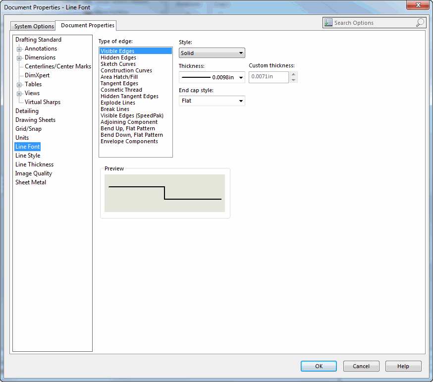

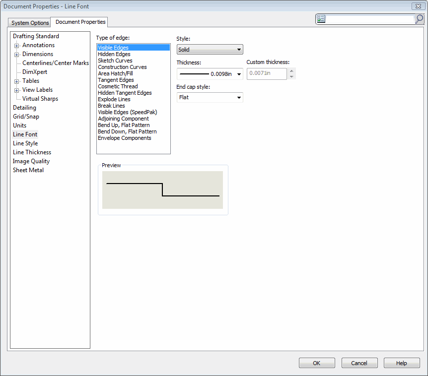

Document Properties > Line Font
Setting
Get/Set Methods
Return Value or <Value>
Comments
Visible Edges - Style
IModelDocExtension::GetUserPreferenceInteger(swUserPreferenceIntegerValue_e.swLineFontVisibleEdgesStyle, swUserPreferenceOption_e.swDetailingNoOptionSpecified)
IModelDocExtension::SetUserPreferenceInteger(swUserPreferenceIntegerValue_e.swLineFontVisibleEdgesStyle, swUserPreferenceOption_e.swDetailingNoOptionSpecified, swLineStyles_e.<Value>)
See swLineStyles_e for valid options
Specifies style of visible edges
Visible Edges - Thickness
IModelDocExtension::GetUserPreferenceInteger(swUserPreferenceIntegerValue_e.swLineFontVisibleEdgesThickness, swUserPreferenceOption_e.swDetailingNoOptionSpecified)
IModelDocExtension::SetUserPreferenceInteger(swUserPreferenceIntegerValue_e.swLineFontVisibleEdgesThickness, swUserPreferenceOption_e.swDetailingNoOptionSpecified, swLineWeights_e.<Value>)
See swLineWeights_e for valid options
Specifies thickness of visible edges
Visible Edges - Custom thickness
IModelDocExtension::GetUserPreferenceDouble(swUserPreferenceDoubleValue_e.swLineFontVisibleEdgesThicknessCustom, swUserPreferenceOption_e.swDetailingNoOptionSpecified)
IModelDocExtension::SetUserPreferenceDouble(swUserPreferenceDoubleValue_e.swLineFontVisibleEdgesThicknessCustom, swUserPreferenceOption_e.swDetailingNoOptionSpecified, <Value>)
Double value
Specifies a custom thickness for visible edges
Visible Edges - End cap style
IModelDocExtension::GetUserPreferenceInteger(swUserPreferenceIntegerValue_e.swLineFontVisibleEdgesEndCap, swUserPreferenceOption_e.swDetailingNoOptionSpecified)
IModelDocExtension::SetUserPreferenceInteger(swUserPreferenceIntegerValue_e.swLineFontVisibleEdgesEndCap, swUserPreferenceOption_e.swDetailingNoOptionSpecified, swLineEndCaps_e.<Value>)
See swLineEndCaps_e for valid options
Specifies style of visible edge end caps
Hidden Edges - Style
IModelDocExtension::GetUserPreferenceInteger(swUserPreferenceIntegerValue_e.swLineFontHiddenEdgesStyle, swUserPreferenceOption_e.swDetailingNoOptionSpecified)
IModelDocExtension::SetUserPreferenceInteger(swUserPreferenceIntegerValue_e.swLineFontHiddenEdgesStyle, swUserPreferenceOption_e.swDetailingNoOptionSpecified, swLineStyles_e.<Value>)
Specifies style of hidden edges
Hidden Edges - Thickness
IModelDocExtension::GetUserPreferenceInteger(swUserPreferenceIntegerValue_e.swLineFontHiddenEdgesThickness, swUserPreferenceOption_e.swDetailingNoOptionSpecified)
IModelDocExtension::SetUserPreferenceInteger(swUserPreferenceIntegerValue_e.swLineFontHiddenEdgesThickness, swUserPreferenceOption_e.swDetailingNoOptionSpecified, swLineWeights_e.<Value>)
Specifies thickness of hidden edges
Hidden Edges - Custom thickness
IModelDocExtension::GetUserPreferenceDouble(swUserPreferenceDoubleValue_e.swLineFontHiddenEdgesThicknessCustom, swUserPreferenceOption_e.swDetailingNoOptionSpecified)
IModelDocExtension::SetUserPreferenceDouble(swUserPreferenceDoubleValue_e.swLineFontHiddenEdgesThicknessCustom, swUserPreferenceOption_e.swDetailingNoOptionSpecified, <Value>)
Double value
Specifies a custom thickness for hidden edges
Hidden Edges - End cap style
IModelDocExtension::GetUserPreferenceInteger(swUserPreferenceIntegerValue_e.swLineFontHiddenEdgesEndCap, swUserPreferenceOption_e.swDetailingNoOptionSpecified)
IModelDocExtension::SetUserPreferenceInteger(swUserPreferenceIntegerValue_e.swLineFontHiddenEdgesEndCap, swUserPreferenceOption_e.swDetailingNoOptionSpecified, swLineEndCaps_e.<Value>)
Specifies style of hidden edge end caps
Sketch Curves - Style
IModelDocExtension::GetUserPreferenceInteger(swUserPreferenceIntegerValue_e.swLineFontSketchCurvesStyle, swUserPreferenceOption_e.swDetailingNoOptionSpecified)
IModelDocExtension::SetUserPreferenceInteger(swUserPreferenceIntegerValue_e.swLineFontSketchCurvesStyle, swUserPreferenceOption_e.swDetailingNoOptionSpecified, swLineStyles_e.<Value>)
Specifies style of sketch curves
Sketch Curves - Thickness
IModelDocExtension::GetUserPreferenceInteger(swUserPreferenceIntegerValue_e.swLineFontSketchCurvesThickness, swUserPreferenceOption_e.swDetailingNoOptionSpecified)
IModelDocExtension::SetUserPreferenceInteger(swUserPreferenceIntegerValue_e.swLineFontSketchCurvesThickness, swUserPreferenceOption_e.swDetailingNoOptionSpecified, swLineWeights_e.<Value>)
Specifies thickness of sketch curves
Sketch Curves - Custom thickness
IModelDocExtension::GetUserPreferenceDouble(swUserPreferenceDoubleValue_e.swLineFontSketchCurvesThicknessCustom, swUserPreferenceOption_e.swDetailingNoOptionSpecified)
IModelDocExtension::SetUserPreferenceDouble(swUserPreferenceDoubleValue_e.swLineFontSketchCurvesThicknessCustom, swUserPreferenceOption_e.swDetailingNoOptionSpecified, <Value>)
Double value
Specifies a custom thickness for sketch curves
Sketch Curves - End cap style
IModelDocExtension::GetUserPreferenceInteger(swUserPreferenceIntegerValue_e.swLineFontSketchCurvesEndCap, swUserPreferenceOption_e.swDetailingNoOptionSpecified)
IModelDocExtension::SetUserPreferenceInteger(swUserPreferenceIntegerValue_e.swLineFontSketchCurvesEndCap, swUserPreferenceOption_e.swDetailingNoOptionSpecified, swLineEndCaps_e.<Value>)
Specifies style of sketch curve end caps
Construction Curves - Style
IModelDocExtension::GetUserPreferenceInteger(swUserPreferenceIntegerValue_e.swLineFontConstructionCurvesStyle, swUserPreferenceOption_e.swDetailingNoOptionSpecified)
IModelDocExtension::SetUserPreferenceInteger(swUserPreferenceIntegerValue_e.swLineFontConstructionCurvesStyle, swUserPreferenceOption_e.swDetailingNoOptionSpecified, swLineStyles_e.<Value>)
Specifies style of construction curves
Construction Curves - Thickness
IModelDocExtension::GetUserPreferenceInteger(swUserPreferenceIntegerValue_e.swLineFontConstructionCurvesThickness, swUserPreferenceOption_e.swDetailingNoOptionSpecified)
IModelDocExtension::SetUserPreferenceInteger(swUserPreferenceIntegerValue_e.swLineFontConstructionCurvesThickness, swUserPreferenceOption_e.swDetailingNoOptionSpecified, swLineWeights_e.<Value>)
Specifies thickness of construction curves
Construction Curves - Custom thickness
IModelDocExtension::GetUserPreferenceDouble(swUserPreferenceDoubleValue_e.swLineFontConstructionCurvesThicknessCustom, swUserPreferenceOption_e.swDetailingNoOptionSpecified)
IModelDocExtension::SetUserPreferenceDouble(swUserPreferenceDoubleValue_e.swLineFontConstructionCurvesThicknessCustom, swUserPreferenceOption_e.swDetailingNoOptionSpecified, <Value>)
Double value
Specifies a custom thickness for construction curves
Area Hatch/Fill - Style
IModelDocExtension::GetUserPreferenceInteger(swUserPreferenceIntegerValue_e.swLineFontCrosshatchStyle, swUserPreferenceOption_e.swDetailingNoOptionSpecified)
IModelDocExtension::SetUserPreferenceInteger(swUserPreferenceIntegerValue_e.swLineFontCrosshatchStyle, swUserPreferenceOption_e.swDetailingNoOptionSpecified, swLineStyles_e.<Value>)
Specifies style of hatch/fills
Area Hatch/Fill - Thickness
IModelDocExtension::GetUserPreferenceInteger(swUserPreferenceIntegerValue_e.swLineFontCrosshatchThickness, swUserPreferenceOption_e.swDetailingNoOptionSpecified)
IModelDocExtension::SetUserPreferenceInteger(swUserPreferenceIntegerValue_e.swLineFontCrosshatchThickness, swUserPreferenceOption_e.swDetailingNoOptionSpecified, swLineWeights_e.<Value>)
Specifies thickness of hatch/fills
Area Hatch/Fill - Custom thickness
IModelDocExtension::GetUserPreferenceDouble(swUserPreferenceDoubleValue_e.swLineFontCrosshatchThicknessCustom, swUserPreferenceOption_e.swDetailingNoOptionSpecified)
IModelDocExtension::SetUserPreferenceDouble(swUserPreferenceDoubleValue_e.swLineFontCrosshatchThicknessCustom, swUserPreferenceOption_e.swDetailingNoOptionSpecified, <Value>)
Double value
Specifies a custom thickness for hatch/fills
Tangent Edges - Style
IModelDocExtension::GetUserPreferenceInteger(swUserPreferenceIntegerValue_e.swLineFontTangentEdgesStyle, swUserPreferenceOption_e.swDetailingNoOptionSpecified)
IModelDocExtension::SetUserPreferenceInteger(swUserPreferenceIntegerValue_e.swLineFontTangentEdgesStyle, swUserPreferenceOption_e.swDetailingNoOptionSpecified, swLineStyles_e.<Value>)
Specifies style of tangent edges
Tangent Edges - Thickness
IModelDocExtension::GetUserPreferenceInteger(swUserPreferenceIntegerValue_e.swLineFontTangentEdgesThickness, swUserPreferenceOption_e.swDetailingNoOptionSpecified)
IModelDocExtension::SetUserPreferenceInteger(swUserPreferenceIntegerValue_e.swLineFontTangentEdgesThickness, swUserPreferenceOption_e.swDetailingNoOptionSpecified, swLineWeights_e.<Value>)
Specifies thickness of tangent edges
Tangent Edges - Custom thickness
IModelDocExtension::GetUserPreferenceDouble(swUserPreferenceDoubleValue_e.swLineFontTangentEdgesThicknessCustom, swUserPreferenceOption_e.swDetailingNoOptionSpecified)
IModelDocExtension::SetUserPreferenceDouble(swUserPreferenceDoubleValue_e.swLineFontTangentEdgesThicknessCustom, swUserPreferenceOption_e.swDetailingNoOptionSpecified, <Value>)
Double value
Specifies a custom thickness for tangent edges
Cosmetic Thread - Style
IModelDocExtension::GetUserPreferenceInteger(swUserPreferenceIntegerValue_e.swLineFontCosmeticThreadStyle, swUserPreferenceOption_e.swDetailingNoOptionSpecified)
IModelDocExtension::SetUserPreferenceInteger(swUserPreferenceIntegerValue_e.swLineFontCosmeticThreadStyle, swUserPreferenceOption_e.swDetailingNoOptionSpecified, swLineStyles_e.<Value>)
Specifies style of cosmetic threads
Cosmetic Thread - Thickness
IModelDocExtension::GetUserPreferenceInteger(swUserPreferenceIntegerValue_e.swLineFontCosmeticThreadThickness, swUserPreferenceOption_e.swDetailingNoOptionSpecified)
IModelDocExtension::SetUserPreferenceInteger(swUserPreferenceIntegerValue_e.swLineFontCosmeticThreadThickness, swUserPreferenceOption_e.swDetailingNoOptionSpecified, swLineWeights_e.<Value>)
Specifies thickness of cosmetic threads
Cosmetic Thread - Custom thickness
IModelDocExtension::GetUserPreferenceDouble(swUserPreferenceDoubleValue_e.swLineFontCosmeticThreadThicknessCustom, swUserPreferenceOption_e.swDetailingNoOptionSpecified)
IModelDocExtension::SetUserPreferenceDouble(swUserPreferenceDoubleValue_e.swLineFontCosmeticThreadThicknessCustom, swUserPreferenceOption_e.swDetailingNoOptionSpecified, <Value>)
Double value
Specifies a custom thickness for cosmetic threads
Hidden Tangent Edges - Style
IModelDocExtension::GetUserPreferenceInteger(swUserPreferenceIntegerValue_e.swLineFontHideTangentEdgeStyle, swUserPreferenceOption_e.swDetailingNoOptionSpecified)
IModelDocExtension::SetUserPreferenceInteger(swUserPreferenceIntegerValue_e.swLineFontHideTangentEdgeStyle, swUserPreferenceOption_e.swDetailingNoOptionSpecified, swLineStyles_e.<Value>)
Specifies style of hidden tangent edges
Hidden Tangent Edges - Thickness
IModelDocExtension::GetUserPreferenceInteger(swUserPreferenceIntegerValue_e.swLineFontHideTangentEdgeThickness, swUserPreferenceOption_e.swDetailingNoOptionSpecified)
IModelDocExtension::SetUserPreferenceInteger(swUserPreferenceIntegerValue_e.swLineFontHideTangentEdgeThickness, swUserPreferenceOption_e.swDetailingNoOptionSpecified, swLineWeights_e.<Value>)
Specifies thickness of hidden tangent edges
Hidden Tangent Edges - Custom thickness
IModelDocExtension::GetUserPreferenceDouble(swUserPreferenceDoubleValue_e.swLineFontHideTangentEdgeThicknessCustom, swUserPreferenceOption_e.swDetailingNoOptionSpecified)
IModelDocExtension::SetUserPreferenceDouble(swUserPreferenceDoubleValue_e.swLineFontHideTangentEdgeThicknessCustom, swUserPreferenceOption_e.swDetailingNoOptionSpecified, <Value>)
Double value
Specifies a custom thickness for hidden tangent edges
Explode Lines - Style
IModelDocExtension::GetUserPreferenceInteger(swUserPreferenceIntegerValue_e.swLineFontExplodedLinesStyle, swUserPreferenceOption_e.swDetailingNoOptionSpecified)
IModelDocExtension::SetUserPreferenceInteger(swUserPreferenceIntegerValue_e.swLineFontExplodedLinesStyle, swUserPreferenceOption_e.swDetailingNoOptionSpecified, swLineStyles_e.<Value>)
Specifies style of exploded lines
Explode Lines - Thickness
IModelDocExtension::GetUserPreferenceInteger(swUserPreferenceIntegerValue_e.swLineFontExplodedLinesThickness, swUserPreferenceOption_e.swDetailingNoOptionSpecified)
IModelDocExtension::SetUserPreferenceInteger(swUserPreferenceIntegerValue_e.swLineFontExplodedLinesThickness, swUserPreferenceOption_e.swDetailingNoOptionSpecified, swLineWeights_e.<Value>)
Specifies thickness of exploded lines
Explode Lines - Custom thickness
IModelDocExtension::GetUserPreferenceDouble(swUserPreferenceDoubleValue_e.swLineFontExplodedLinesThicknessCustom, swUserPreferenceOption_e.swDetailingNoOptionSpecified)
IModelDocExtension::SetUserPreferenceDouble(swUserPreferenceDoubleValue_e.swLineFontExplodedLinesThicknessCustom, swUserPreferenceOption_e.swDetailingNoOptionSpecified, <Value>)
Double value
Specifies a custom thickness for exploded lines
Break Lines - Style
IModelDocExtension::GetUserPreferenceInteger(swUserPreferenceIntegerValue_e.swLineFontBreakLineStyle, swUserPreferenceOption_e.swDetailingNoOptionSpecified)
IModelDocExtension::SetUserPreferenceInteger(swUserPreferenceIntegerValue_e.swLineFontBreakLineStyle, swUserPreferenceOption_e.swDetailingNoOptionSpecified, swLineStyles_e.<Value>)
Specifies style of break lines
Break Lines - Thickness
IModelDocExtension::GetUserPreferenceInteger(swUserPreferenceIntegerValue_e.swLineFontBreakLineThickness, swUserPreferenceOption_e.swDetailingNoOptionSpecified)
IModelDocExtension::SetUserPreferenceInteger(swUserPreferenceIntegerValue_e.swLineFontBreakLineThickness, swUserPreferenceOption_e.swDetailingNoOptionSpecified, swLineWeights_e.<Value>)
Specifies thickness of break lines
Break Lines - Custom thickness
IModelDocExtension::GetUserPreferenceDouble(swUserPreferenceDoubleValue_e.swLineFontBreakLineThicknessCustom, swUserPreferenceOption_e.swDetailingNoOptionSpecified)
IModelDocExtension::SetUserPreferenceDouble(swUserPreferenceDoubleValue_e.swLineFontBreakLineThicknessCustom, swUserPreferenceOption_e.swDetailingNoOptionSpecified, <Value>)
Double value
Specifies a custom thickness for break lines
Visible Edges (SpeedPak) - Style
IModelDocExtension::GetUserPreferenceInteger(swUserPreferenceIntegerValue_e.swLineFontSpeedPakDrawingsModelEdgesStyle, swUserPreferenceOption_e.swDetailingNoOptionSpecified)
IModelDocExtension::SetUserPreferenceInteger(swUserPreferenceIntegerValue_e.swLineFontSpeedPakDrawingsModelEdgesStyle, swUserPreferenceOption_e.swDetailingNoOptionSpecified, swLineStyles_e.<Value>)
Specifies style of SpeedPak drawing model edges
Visible Edges (SpeedPak) - Thickness
IModelDocExtension::GetUserPreferenceInteger(swUserPreferenceIntegerValue_e.swLineFontSpeedPakDrawingsModelEdgesThickness, swUserPreferenceOption_e.swDetailingNoOptionSpecified)
IModelDocExtension::SetUserPreferenceInteger(swUserPreferenceIntegerValue_e.swLineFontSpeedPakDrawingsModelEdgesThickness, swUserPreferenceOption_e.swDetailingNoOptionSpecified, swLineWeights_e.<Value>)
Specifies thickness of SpeedPak drawing model edges
Visible Edges (SpeedPak) - Custom thickness
IModelDocExtension::GetUserPreferenceDouble(swUserPreferenceDoubleValue_e.swLineFontSpeedPakDrawingsModelEdgesThicknessCustom, swUserPreferenceOption_e.swDetailingNoOptionSpecified)
IModelDocExtension::SetUserPreferenceDouble(swUserPreferenceDoubleValue_e.swLineFontSpeedPakDrawingsModelEdgesThicknessCustom, swUserPreferenceOption_e.swDetailingNoOptionSpecified, <Value>)
Double value
Specifies a custom thickness for model edges in a SpeedPak drawing document
Adjoining Component - Style
ModelDocExtension::GetUserPreferenceInteger(swUserPreferenceIntegerValue_e.swLineFontAdjoiningComponentStyle, swUserPreferenceOption_e.swDetailingNoOptionSpecified)
IModelDocExtension::SetUserPreferenceInteger(swUserPreferenceIntegerValue_e.swLineFontAdjoiningComponentStyle, swUserPreferenceOption_e.swDetailingNoOptionSpecified, swLineStyles_e.<Value>)
Specifies style of the edges of adjoining components in drawing documents
Adjoining Component - Thickness
ModelDocExtension::GetUserPreferenceInteger(swUserPreferenceIntegerValue_e.swLineFontAdjoiningComponent, swUserPreferenceOption_e.swDetailingNoOptionSpecified)
IModelDocExtension::SetUserPreferenceInteger(swUserPreferenceIntegerValue_e.swLineFontAdjoiningComponent, swUserPreferenceOption_e.swDetailingNoOptionSpecified, swLineWeights_e.<Value>)
Specifies thickness of the edges of adjoining components in drawing documents
Adjoining Component - Custom Thickness
IModelDocExtension::GetUserPreferenceDouble(swUserPreferenceDoubleValue_e.swLineFontAdjoiningComponentCustom, swUserPreferenceOption_e.swDetailingNoOptionSpecified)
IModelDocExtension::SetUserPreferenceDouble(swUserPreferenceDoubleValue_e.swLineFontAdjoiningComponentCustom, swUserPreferenceOption_e.swDetailingNoOptionSpecified, <Value>)
Double value
Specifies a custom thickness of the edges of adjoining components in drawing documents
Bend Up, Flat Pattern - Style
ModelDocExtension::GetUserPreferenceInteger(swUserPreferenceIntegerValue_e.swLineFontBendLineUpStyle, swUserPreferenceOption_e.swDetailingNoOptionSpecified)
IModelDocExtension::SetUserPreferenceInteger(swUserPreferenceIntegerValue_e.swLineFontBendLineUpStyle, swUserPreferenceOption_e.swDetailingNoOptionSpecified, swLineStyles_e.<Value>)
See swLineStyles_e for valid options Specifies style of the bend lines indicating where to bend the sheet metal up in flat patterns in drawing documents
Bend Up, Flat Pattern - Thickness
ModelDocExtension::GetUserPreferenceInteger(swUserPreferenceIntegerValue_e.swLineFontBendLineUpThickness, swUserPreferenceOption_e.swDetailingNoOptionSpecified)
IModelDocExtension::SetUserPreferenceInteger(swUserPreferenceIntegerValue_e.swLineFontBendLineUpThickness, swUserPreferenceOption_e.swDetailingNoOptionSpecified, swLineWeights_e.<Value>)
See swLineWeights_e for valid options Specifies thickness of the bend lines indicating where to bend the sheet metal up in flat patterns in drawing documents
Bend Up, Flat Pattern - Custom Thickness
IModelDocExtension::GetUserPreferenceDouble(swUserPreferenceDoubleValue_e.swLineFontBendLineUpThicknessCustom, swUserPreferenceOption_e.swDetailingNoOptionSpecified)
IModelDocExtension::SetUserPreferenceDouble(swUserPreferenceDoubleValue_e.swLineFontBendLineUpThicknessCustom, swUserPreferenceOption_e.swDetailingNoOptionSpecified, <Value>)
Double value Specifies a custom thickness of the bend lines indicating where to bend the sheet metal up in flat patterns in drawing documents
Bend Down, Flat Pattern - Style
ModelDocExtension::GetUserPreferenceInteger(swUserPreferenceIntegerValue_e.swLineFontBendLineDownStyle, swUserPreferenceOption_e.swDetailingNoOptionSpecified)
IModelDocExtension::SetUserPreferenceInteger(swUserPreferenceIntegerValue_e.swLineFontBendLineDownStyle, swUserPreferenceOption_e.swDetailingNoOptionSpecified, swLineStyles_e.<Value>)
See swLineStyles_e for valid options Specifies style of the bend lines indicating where to bend the sheet metal down in flat patterns in drawing documents
Bend Down, Flat Pattern - Thickness
ModelDocExtension::GetUserPreferenceInteger(swUserPreferenceIntegerValue_e.swLineFontBendLineDownThickness, swUserPreferenceOption_e.swDetailingNoOptionSpecified)
IModelDocExtension::SetUserPreferenceInteger(swUserPreferenceIntegerValue_e.swLineFontBendLineDownThickness, swUserPreferenceOption_e.swDetailingNoOptionSpecified, swLineWeights_e.<Value>)
See swLineWeights_e for valid options Specifies thickness of the bend lines indicating where to bend the sheet metal down in flat patterns in drawing documents
Bend Down, Flat Pattern - Custom Thickness
IModelDocExtension::GetUserPreferenceDouble(swUserPreferenceDoubleValue_e.swLineFontBendLineDownThicknessCustom, swUserPreferenceOption_e.swDetailingNoOptionSpecified)
IModelDocExtension::SetUserPreferenceDouble(swUserPreferenceDoubleValue_e.swLineFontBendLineDownThicknessCustom, swUserPreferenceOption_e.swDetailingNoOptionSpecified, <Value>)
Double value Specifies a custom thickness of the bend lines indicating where to bend the sheet metal down in flat patterns in drawing documents
Envelope Components - Style
ModelDocExtension::GetUserPreferenceInteger(swUserPreferenceIntegerValue_e.swLineFontEnvelopeComponentStyle, swUserPreferenceOption_e.swDetailingNoOptionSpecified)
IModelDocExtension::SetUserPreferenceInteger(swUserPreferenceIntegerValue_e.swLineFontEnvelopeComponentStyle, swUserPreferenceOption_e.swDetailingNoOptionSpecified, swLineStyles_e.<Value>)
See swLineStyles_e for valid options Specifies style of the edges of envelope components
Envelope Components - Thickness
ModelDocExtension::GetUserPreferenceInteger(swUserPreferenceIntegerValue_e.swLineFontEnvelopeComponentThickness, swUserPreferenceOption_e.swDetailingNoOptionSpecified)
IModelDocExtension::SetUserPreferenceInteger(swUserPreferenceIntegerValue_e.swLineFontEnvelopeComponentThickness, swUserPreferenceOption_e.swDetailingNoOptionSpecified, swLineWeights_e.<Value>)
See swLineWeights_e for valid options Specifies thickness of the edges of envelope components
Envelope Components - Custom Thickness
IModelDocExtension::GetUserPreferenceDouble(swUserPreferenceDoubleValue_e.swLineFontEnvelopeComponentThicknessCustom, swUserPreferenceOption_e.swDetailingNoOptionSpecified)
IModelDocExtension::SetUserPreferenceDouble(swUserPreferenceDoubleValue_e.swLineFontEnvelopeComponentThicknessCustom, swUserPreferenceOption_e.swDetailingNoOptionSpecified, <Value>)
Double value Specifies a custom thickness of the edges of envelope components
