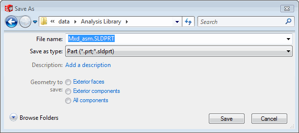

File > Save As > Save as type > Part
Setting
Get/Set Methods
Return Value
or
<Value>
Comment
Geometry to save:
  • Exterior faces
  • Exterior components
  • All components
ISldWorks::GetUserPreferenceIntegerValue(swUserPreferenceIntegerValue_e.swSaveAssemblyAsPartOptions)
ISldWorks::SetUserPreferenceIntegerValue(swUserPreferenceIntegerValue_e.swSaveAssemblyAsPartOptions, swSaveAsmAsPartOptions_e.<Value>)
See swSaveAsmAsPartOptions_e for valid options
Save assembly as multibody part
