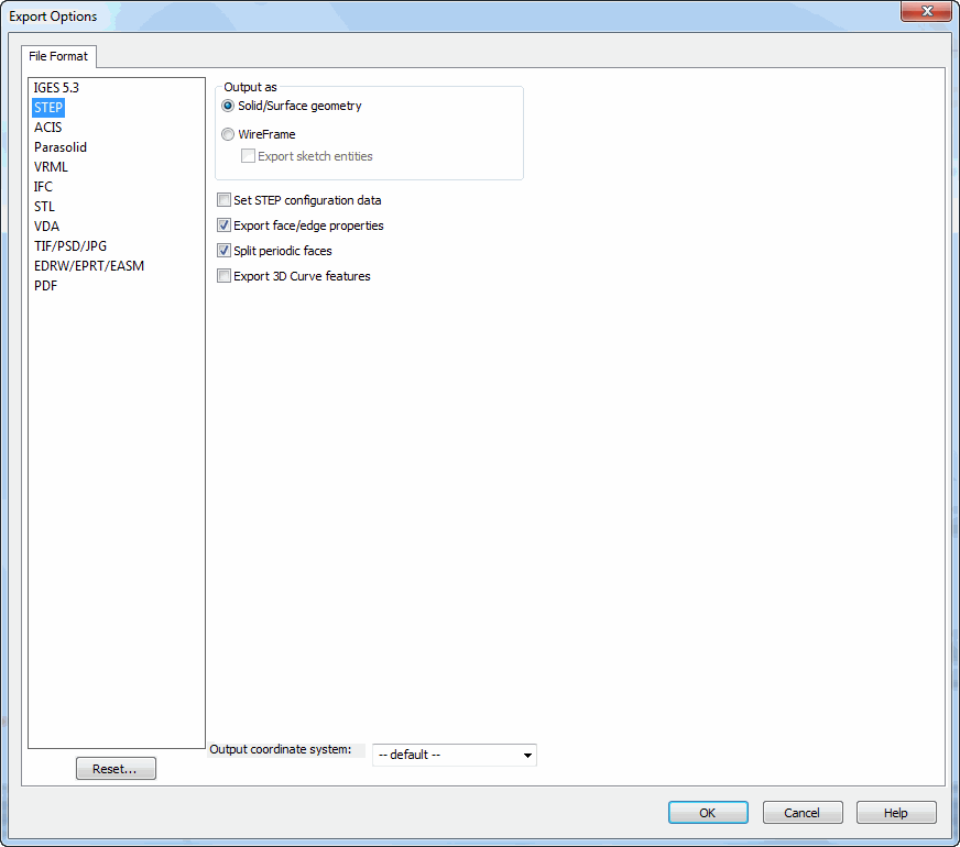

File > Save As > Save as type > STEP > Options > STEP
This topic contains two tables. The information in the table:
  • appearing immediately after the screen capture of the Export Options - File Format - STEP dialog corresponds to the settings on that dialog.
  • titled Miscellaneous Enumerators contains enumerators related to saving STEP data.
Setting
Get/Set Methods
Return Value
or
<Value>
Comment
Output as - Solid/Surface geometry
ISldWorks::GetUserPreferenceIntegerValue(swUserPreferenceIntegerValue_e.swStepExportPreference)
ISldWorks::SetUserPreferenceIntegerValue(swUserPreferenceIntegerValue_e.swStepExportPreference, swAcisOutputGeometryPreference_e.swAcisOutputAsSolidAndSurface)
Output as - 3D curves
ISldWorks::SetUserPreferenceIntegerValue(swUserPreferenceIntegerValue_e.swStepExportPreference, swAcisOutputGeometryPreference_e.swAcisOutputAs3DCurves)
Output as - Export sketch entities
ISldWorks::SetUserPreferenceIntegerValue(swUserPreferenceIntegerValue_e.swStepExportPreference, swAcisOutputGeometryPreference_e.swAcisOutputAs3DCurves_IncludeSketchEnts)
Set STEP configuration data
IModelDocExtension::GetUserPreferenceToggle(swUserPreferenceToggle_e.swStepExportConfigurationData, swUserPreferenceOption_e.swDetailingNoOptionSpecified)
IModelDocExtension::SetUserPreferenceToggle(swUserPreferenceToggle_e.swStepExportConfigurationData, swUserPreferenceOption_e.swDetailingNoOptionSpecified, <Value>)
Boolean value
Specifies whether to export STEP configuration data
Export face/edge properties
ISldWorks::GetUserPreferenceToggle(swUserPreferenceToggle_e.swStepExportFaceEdgeProps)
ISldWorks::SetUserPreferenceToggle(swUserPreferenceToggle_e.swStepExportFaceEdgeProps, <OnFlag>)
Boolean value
Specifies whether to export face and edge properties
Split periodic faces
ISldWorks::GetUserPreferenceToggle(swUserPreferenceToggle_e.swStepExportSplitPeriodic)
ISldWorks::SetUserPreferenceToggle(swUserPreferenceToggle_e.swStepExportSplitPeriodic, <OnFlag>)
Boolean value
Specifies whether to split periodic faces on export
Export 3D Curve features
ISldWorks::GetUserPreferenceToggle(swUserPreferenceToggle_e.swStepExport3DCurveFeatures)
ISldWorks::SetUserPreferenceToggle(swUserPreferenceToggle_e.swStepExport3DCurveFeatures, <OnFlag>)
Boolean value Specifies whether to include 3D curve features in the exported file
Output coordinate system
IModelDocExtension::GetUserPreferenceString(swUserPreferenceString_e.swFileSaveAsCoordinateSystem, swUserPreferenceOption_e.swDetailingNoOptionSpecified)
IModelDocExtension::SetUserPreferenceString(swUserPreferenceString_e.swFileSaveAsCoordinateSystem, swUserPreferenceOption_e.swDetailingNoOptionSpecified, <Value>)
String value
Contains the name of the transform coordinate system; an empty string signifies that the  default coordinate system that does not require a transform; coordinate settings are not saved with the document; they must be selected at export time
