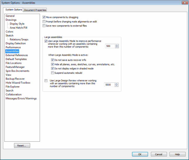

System Options > Assemblies
Setting
Get/Set Method
Return Value
or
<Value>
or
<OnFlag>
Comment
Move components by dragging
ISldWorks::GetUserPreferenceToggle(swUserPreferenceToggle_e.swAssemblyAllowComponentMoveByDragging)
ISldWorks::SetUserPreferenceToggle(swUserPreferenceToggle_e.swAssemblyAllowComponentMoveByDragging, <OnFlag>)
Boolean value
Specifies whether to move assembly components by dragging them or using the Move with Triad and Move Component tools
Prompt before changing mate alignments on edit
ISldWorks::GetUserPreferenceToggle(swUserPreferenceToggle_e.swPromptForAutoMateFlip)
ISldWorks::SetUserPreferenceToggle(swUserPreferenceToggle_e.swPromptForAutoMateFlip, <OnFlag>)
Boolean value
Specifies whether to prompt before automatically flipping a mate to avoid errors
Save new components to external files
ISldWorks::GetUserPreferenceToggle(swUserPreferenceToggle_e.swSaveNewComponentToExternalFile)
ISldWorks::SetUserPreferenceToggle(swUserPreferenceToggle_e.swSaveNewComponentToExternalFile, <OnFlag>)
Boolean value
Specifies whether to save new components to external files
Large assemblies - Use Large Assembly Mode to improve performance whenever working with an assembly containing more than this number of components (checkbox)
ISldWorks::GetUserPreferenceToggle(swUserPreferenceToggle_e.swLargeAsmModeEnabled)
ISldWorks::SetUserPreferenceToggle(swUserPreferenceToggle_e.swLargeAsmModeEnabled, <OnFlag>)
Boolean value
Specifies whether to activate large assembly mode
Large assemblies - Use Large Assembly Mode to improve performance whenever working with an assembly containing more than this number of components (listbox)
ISldWorks::GetUserPreferenceIntegerValue(swUserPreferenceIntegerValue_e.swLargeAsmModeThreshold)
ISldWorks::SetUserPreferenceIntegerValue(swUserPreferenceIntegerValue_e.swLargeAsmModeThreshold, <Value>)
Integer value
When Large Assembly Mode is active - Do not save auto recover info
ISldWorks::GetUserPreferenceToggle(swUserPreferenceToggle_e.swLargeAsmModeAutoRecover)
ISldWorks::SetUserPreferenceToggle(swUserPreferenceToggle_e.swLargeAsmModeAutoRecover, <OnFlag>)
Boolean value
Specifies whether to automatically save model information after specified number of changes
When Large Assembly Mode is active - Hide all planes, axes, sketches, curves, annotations, etc.
ISldWorks::GetUserPreferenceToggle(swUserPreferenceToggle_e.swLargeAsmModeHideAllItems)
ISldWorks::SetUserPreferenceToggle(swUserPreferenceToggle_e.swLargeAsmModeHideAllItems, <OnFlag>)
Boolean value
Specifies whether to hide all planes, axes, sketches, curves, annotations, etc.
When Large Assembly Mode is active - Do not display edges in shaded mode
ISldWorks::GetUserPreferenceToggle(swUserPreferenceToggle_e.swLargeAsmModeUseHLREdgesInShaded)
ISldWorks::SetUserPreferenceToggle(swUserPreferenceToggle_e.swLargeAsmModeUseHLREdgesInShaded, <OnFlag>)
Boolean value
Specifies whether to use HLR edges in shaded mode
When Large Assembly Mode is active - Suspend automatic rebuild
ISldWorks::GetUserPreferenceToggle(swUserPreferenceToggle_e.swLargeAsmModeSuspendAutoRebuild)
ISldWorks::SetUserPreferenceToggle(swUserPreferenceToggle_e.swLargeAsmModeSuspendAutoRebuild, <OnFlag>)
Boolean value
Specifies to defer the update of assemblies so that you can make changes and rebuild the assembly once
Use Large Design Review whenever working with an assembly containing more than this number of components
ISldWorks::GetUserPreferenceToggle(swUserPreferenceToggle_e.swLargeAsmModeLargeDesignReview)
ISldWorks::SetUserPreferenceToggle(swUserPreferenceToggle_e.swLargeAsmModeLargeDesignReview, <OnFlag>)
ISldWorks::GetUserPreferenceIntegerValue(swUserPreferenceIntegerValue_e.swLargeAsmModeLargeDesignReviewThreshhold)
ISldWorks::SetUserPreferenceIntegerValue(swUserPreferenceIntegerValue_e.swLargeAsmModeLargeDesignReviewThreshhold, <Value>)
Boolean value
Integer value
Specifies whether to automatically use Large Design Review based on the number of components in the assembly; see swLargeAsmModeLargeDesignReviewThreshhold
Specifies the minimum number of components in an assembly for automatically using Large Design Review
