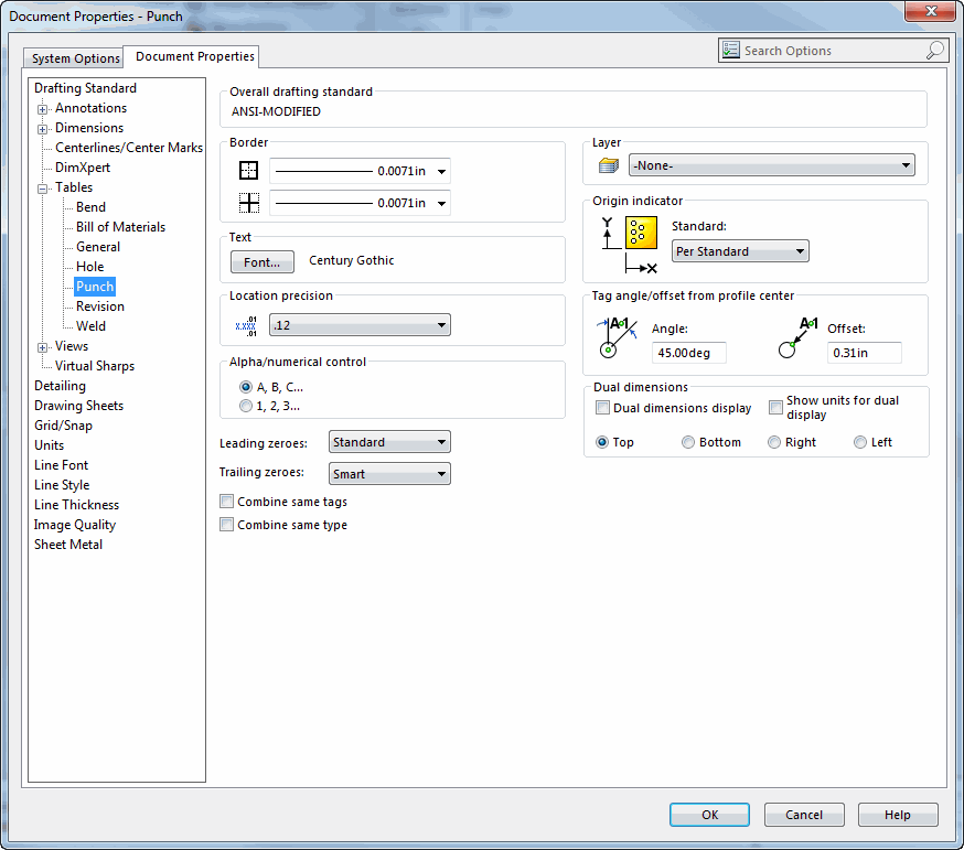

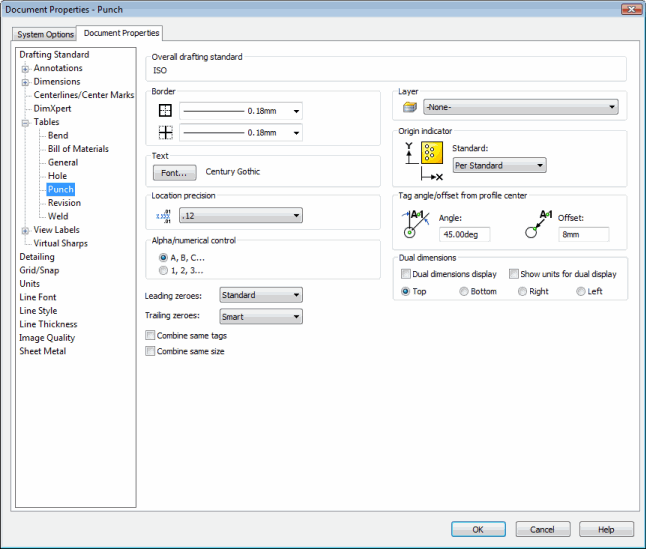

Document Properties > Tables > Punch
NOTE: Setting any of the following punch table values means that new punch tables added to the drawing use these default values. However, a punch table that uses a template table for insertion might not use these default values because the template table contains certain properties that take precedence over these default values. These properties include the tag style, precision values, combine tag, and combine same size.
Setting
Get/Set Methods
Return Value or <Value>
Comments
Border - Box Border
IModelDocExtension::GetUserPreferenceInteger(swUserPreferenceIntegerValue_e.swDetailingPunchTableBorderLineWeight, swUserPreferenceOption_e.swDetailingNoOptionSpecified)
IModelDocExtension::SetUserPreferenceInteger(swUserPreferenceIntegerValue_e.swDetailingPunchTableBorderLineWeight, swUserPreferenceOption_e.swDetailingNoOptionSpecified, swLineWeights_e.<Value>)
See swLineWeights_e for valid options
Border - Grid Border
ModelDocExtension::GetUserPreferenceInteger(swUserPreferenceIntegerValue_e.swDetailingPunchTableGridLineWeight, swUserPreferenceOption_e.swDetailingNoOptionSpecified)
IModelDocExtension::SetUserPreferenceInteger(swUserPreferenceIntegerValue_e.swDetailingPunchTableGridLineWeight, swUserPreferenceOption_e.swDetailingNoOptionSpecified, swLineWeights_e.<Value>)
Text - Font...
IModelDocExtension::GetUserPreferenceTextFormat(swUserPreferenceTextFormat_e.swDetailingPunchTextFormat, swUserPreferenceOption_e.swDetailingNoOptionSpecified)
IModelDocExtension::SetUserPreferenceTextFormat(swUserPreferenceTextFormat_e.swDetailingPunchTextFormat, swUserPreferenceOption_e.swDetailingNoOptionSpecified, <Value>)
See ITextFormat for font options
To set font property values, implement ITextFormat, set the appropriate ITextFormat member values, and pass the ITextFormat object in the set method
Location precision - Unit Precision
IModelDocExtension::GetUserPreferenceInteger(swUserPreferenceIntegerValue_e.swPunchTableLocationPrecision, swUserPreferenceOption_e.swDetailingNoOptionSpecified)
IModelDocExtension::SetUserPreferenceInteger(swUserPreferenceIntegerValue_e.swPunchTableLocationPrecision, swUserPreferenceOption_e.swDetailingNoOptionSpecified, <Value>)
Integer value
Specifies the number of digits of precision to display in the punch table; specify a value from 0 through 8
When setting this value, existing punch tables in the drawing are updated to use this precision
Alpha/numerical control
IModelDocExtension::GetUserPreferenceInteger(swUserPreferenceIntegerValue_e.swPunchTableTagStyle, swUserPreferenceOption_e.swDetailingNoOptionSpecified)
IModelDocExtension::SetUserPreferenceInteger(swUserPreferenceIntegerValue_e.swPunchTableTagStyle, swUserPreferenceOption_e.swDetailingNoOptionSpecified, swPunchTableTagStyle_e.<Value>)
See swPunchTableTagStyle_e for valid options
Specifies whether the punch tags are alphanumeric or numeric
Leading zeroes
IModelDocExtension::GetUserPreferenceInteger(swUserPreferenceIntegerValue_e.swDetailingLeadingZero, swUserPreferenceOption_e.swDetailingHoleTable)
IModelDocExtension::SetUserPreferenceInteger(swUserPreferenceIntegerValue_e.swDetailingLeadingZero, swUserPreferenceOption_e.swDetailingPunchTable, swDetailingLeadingZero_e.<Value>)
See swDetailingLeadingZero_e for valid options
Trailing zeroes
IModelDocExtension::GetUserPreferenceInteger(swUserPreferenceIntegerValue_e.swDetailingDimTrailingZero, swUserPreferenceOption_e.swDetailingHoleTable)
IModelDocExtension::SetUserPreferenceInteger(swUserPreferenceIntegerValue_e.swDetailingDimTrailingZero, swUserPreferenceOption_e.swDetailingPunchTable, swDetailingDimTrailingZero_e.<Value>)
See swDetailingDimTrailingZero_e for valid options
Combine same tags
IModelDocExtension::GetUserPreferenceToggle(swUserPreferenceToggle_e.swPunchTableCombineTags, swUserPreferenceOption_e.swDetailingNoOptionSpecified)
IModelDocExtension::SetUserPreferenceToggle(swUserPreferenceToggle_e.swPunchTableCombineTags, swUserPreferenceOption_e.swDetailingNoOptionSpecified, <Value>)
Boolean value
If true, then punches of the same size are assigned the same tag, and the punch table contains a Quantity column, which indicates multiple punches of the same size exist
Combine same tags
IModelDocExtension::GetUserPreferenceToggle(swUserPreferenceToggle_e.swPunchTableCombineSameSize, swUserPreferenceOption_e.swDetailingNoOptionSpecified)
IModelDocExtension::SetUserPreferenceToggle(swUserPreferenceToggle_e.swPunchTableCombineSameSize, swUserPreferenceOption_e.swDetailingNoOptionSpecified, <Value>)
Boolean value
If true, then punches are the same size, and their cells in the Size column are merged and appear as a single cell
Layer
IModelDocExtension::GetUserPreferenceString(swUserPreferenceStringValue_e.swDetailingLayer, swUserPreferenceOption_e.swDetailingPunchTable)
IModelDocExtension::SetUserPreferenceString(swUserPreferenceStringValue_e.swDetailingLayer, swUserPreferenceOption_e.swDetailingPunchTable, <Value>)
Valid options:
  • "Border"
  • "Dimensions"
  • "Notes"
  • "BOM"
  • "FORMAT"
  • "None"
This setting is available only on drawings; depending on drawing, some options may not apply
Origin indicator
IModelDocExtension::GetUserPreferenceInteger(swUserPreferenceIntegerValue_e.swPunchTableOriginStandard, swUserPreferenceOption_e.swDetailingNoOptionSpecified)
IModelDocExtension::SetUserPreferenceInteger(swUserPreferenceIntegerValue_e.swPunchTableOriginStandard, swUserPreferenceOption_e.swDetailingNoOptionSpecified, swDetailingStandard_e.<Value>)
See swDetailingStandard_e for valid options
Specifies the detailing standard to use for displaying the punch table's origin symbol
If you specify -1 or 0, then the origin symbol is displayed according to the default document detailing standard; otherwise, the value is from swDetailingStandard_e and the punch table's origin is displayed according to that standard
When setting this value, any existing punch tables in the drawing are updated to use this dimensioning standard
To determine the default document detailing standard, get the value of the document's integer user preference swDetailingDimensionStardard
Tag angle/offset from profile center - Angle
IModelDocExtension::GetUserPreferenceDouble(swUserPreferenceDoubleValue_e.swPunchTableTagAngle, swUserPreferenceOption_e.swDetailingNoOptionSpecified)
IModelDocExtension::SetUserPreferenceDouble(swUserPreferenceDoubleValue_e.swPunchTableTagAngle, swUserPreferenceOption_e.swDetailingNoOptionSpecified, <Value>)
Double value
The origin of the punch tag text is at this angle, in radians, clockwise from the Y axis at the distance specified by swPunchTableTagOffset (see the next enumeration); the angle must be between -360° and 360°
Tag angle/offset from profile center - Offset
IModelDocExtension::GetUserPreferenceDouble(swUserPreferenceDoubleValue_e.swPunchTableTagOffset, swUserPreferenceOption_e.swDetailingNoOptionSpecified)
IModelDocExtension::SetUserPreferenceDouble(swUserPreferenceDoubleValue_e.swPunchTableTagOffset, swUserPreferenceOption_e.swDetailingNoOptionSpecified, <Value>)
Double value
The origin of the punch tag text is this distance from the punch at the angle specified by swPunchTableTagAngle (see previous enumeration); the offset must be > 0
Dual dimensions - Dual dimensions display
IModelDocExtension::GetUserPreferenceToggle(swUserPreferenceToggle_e.swTablePunchDualDimensionDisplay, swUserPreferenceOption_e.swDetailingNoOptionSpecified)
IModelDocExtension::SetUserPreferenceToggle(swUserPreferenceToggle_e.swTablePunchDualDimensionDisplay, swUserPreferenceOption_e.swDetailingNoOptionSpecified, <Value>)
Boolean value
Specifies whether to display dual dimensions
Dual dimensions - Show units for dual display
IModelDocExtension::GetUserPreferenceToggle(swUserPreferenceToggle_e.swTablePunchShowUnitsForDualDisplay, swUserPreferenceOption_e.swDetailingNoOptionSpecified)
IModelDocExtension::SetUserPreferenceToggle(swUserPreferenceToggle_e.swTablePunchShowUnitsForDualDisplay, swUserPreferenceOption_e.swDetailingNoOptionSpecified, <Value>)
Boolean value
Specifies whether to display units for dual dimensions
Dual dimensions - Position
IModelDocExtension::GetUserPreferenceInteger(swUserPreferenceIntegerValue_e.swTablePunchDualDimensionPos, swUserPreferenceOption_e.swDetailingNoOptionSpecified)
IModelDocExtension::SetUserPreferenceInteger(swUserPreferenceIntegerValue_e.swTablePunchDualDimensionPos, swUserPreferenceOption_e.swDetailingNoOptionSpecified, <Value>)
See swDetailingDualDimPosition_e for valid options
Specifies the position of punch table dual dimensions
