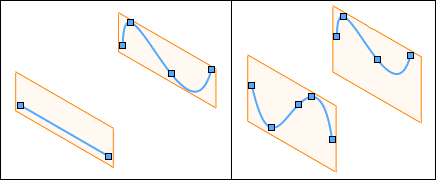

Valid sketch pairs where K-factor is applied:
Lofted Bends Valid 1

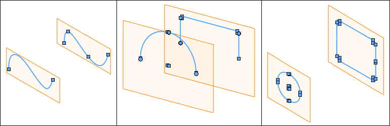

Invalid sketch pairs where K-factor is not applied:
Lofted Bends Invalid 1
