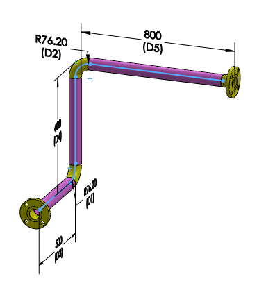

In route models, you can define driving dimensions that start with the end face of a flange.
Adding a dimension between a flange face and a route does not cause the sketch to be over defined.
In previous releases, you could not add dimensions between the end face of a flange and a route.
