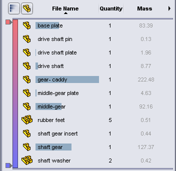

The Assembly Visualization tab in the FeatureManager design tree panel contains a list of all components in the assembly, sorted initially by file name. There are three columns:
  • File name
  • Quantity
  • Property (initially Mass)
Click a column header to sort by its parameter.

/ Show/Hide Value Bars Available for numeric properties. Turns the value bars off and on. When the value bars are on, the component with the highest value displays the longest bar. You can set the length of the bars to be calculated relative to the highest-value component or relative to the entire assembly.

Toggle Color On/Off
Toggles the color spectrum on and off when you click the vertical spectrum bar.
When the spectrum is on, the colors of components in the graphics area correspond to colors in the spectrum, to indicate the relative property value of each component.
Add Slider
Adds a color slider to the spectrum when you click in the blank area to the left of the vertical bar.
You can move the color sliders up and down to modify the color distribution in the spectrum. You can right-click a color slider and change its color or delete it. To return to the original two sliders, right-click any slider and click Reset all.
