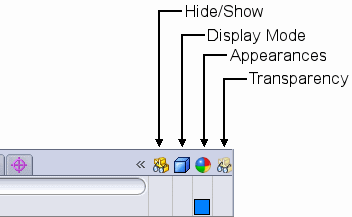

You can change the appearance and transparency for parts. For solid and surface bodies, you can also change the display mode (for example, wireframe or shaded), and whether the part is hidden or shown.
To change a part's display settings:
Click
at the top of the FeatureManager design tree.
The display pane appears to the right of the FeatureManager design tree.
- In a multibody part, to change display settings for a specific body, expand the Solid Bodies folder.
- Move the pointer in the Display Pane to activate a row.
The feature or body is highlighted in the graphics area.
- Do one of the following:
- Right-click and select a display setting from the pop-up menu.
- Click in the column for the setting you want to change.
For the Hide/Show and Transparency settings, clicking toggles the settings on and off.
| Transparency toggled on for boards |
| Hide/Show set to Hide for middle row of tubes |
For the Display Mode and Appearance settings, a pop-up menu shows the possible settings.
