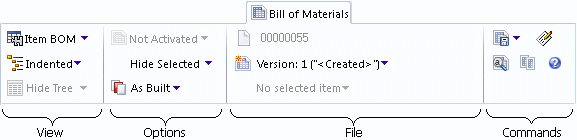

The Bill of Materials tab shows the item BOM, which corresponds to the item structure, and named BOMs for the selected item.
See Bills of Materials for details. The image below shows the Bill of Materials tab for an item. You can also view other BOM types from the Bill of Materials tab; see SolidWorks Enterprise PDM File Explorer Help.

BOM_UI_Items
View
BOM_UI_BOM_control Bill of Materials Select an item BOM template (Item BOM by default) or named BOM. The template defines the BOM columns. BOM templates are managed from the Administration tool.
BOM_UI_Indented_control2 BOM View Selects how the BOM contents are displayed:
  • Indented displays all items in a hierarchical view.
  • Parts Only displays only items without child items in a flat view. Quantities for items referenced by more than one parent item are accumulated.
  • Top Level Only displays only top-level items.
BOM_UI_Show_tree_control Tree View Not supported for item BOMs.
For computed BOMs, toggles display of the BOM tree pane.
Options
BOM_UI_Not_Activated_control Activation Controls whether the BOM is visible in the Bill of Materials view.
BOM_UI_Show_selected_control Selected File Shows or hides the selected top-level file in the BOM file list.
BOM_UI_As_Built_control Reference Version Indicates whether the versions of components that are displayed are the versions when the assembly was built or the latest versions of the components.
File
Source file (Read-only) For Item BOMs, the item ID.
For computed BOMs, the assembly or drawing file name.
File Version For item BOMs, selects the item version for which to display the BOM. For named BOMs, displays the version of the associated item.
In named BOMS, if the Update Source Version icon at the end of the text field appears as , a more recent version of the source item exists and you can update the named BOM data to match it. If it appears as , the named BOM is based on the latest version of the item.
For computed BOMs, lets you select the source file version for which to display the BOM.
Configuration Not supported for item BOMs.
For computed BOMs, lets you select the source file configuration for which to display the BOM.
