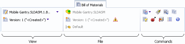

Bill of Materials Tab - Named BOM
Use the Bill of Materials tab to view named BOMs. Named BOMs can be saved from computed BOMs and SolidWorks BOMs.
To display a computed BOM:
In your local file vault, select a SolidWorks assembly or drawing. On the Bill of Materials tab, for BOM, select a named BOM icon or SolidWorks named BOM icon.
BOM_UI_Named
View
Information about the named BOM.
BOM_UI_Named_BOM_BOM_control Bill of Materials The BOM type. Select a named BOM or SolidWorks named BOM .
  BOM Version Version of Bill of Materials being viewed.
File
Information about the file associated with the named BOM.
Source (Read-only) The assembly or drawing that is associated with the named BOM.
Source version (Read-only) The version of the associated file.
The Update Source Version icon at the end of the text field appears as if a more recent version of the source file exists and you can update the named BOM data to match it.
If the icon appears as , the named BOM is based on the latest version of the source file.
Configuration (Read-only) The configuration of the associated file.
Commands
BOM_UI_Save_BOM Save Select Save to save the BOM, or Save As to save a new named BOM.
BOM_UI_Open_as_CSV_file Open As CSV Opens the BOM in Excel as a comma-delimited file.
BOM_UI_Switch_View Switch View Toggles between the Bill of Materials view and the File view.
Search Search the BOM for a text string. See Searching BOMs.
Compare Changes the Bill of Materials tab layout so that you can select a second BOM to compare. See Comparing BOMs.
Filter Opens the Filter dialog box, where you can specify the BOM content to display.
Position Numbers Opens the Position Numbers dialog box. See Adding Position Numbers.
Position numbers cannot be added to SolidWorks named BOMs.
Check Out
Check In
Help
