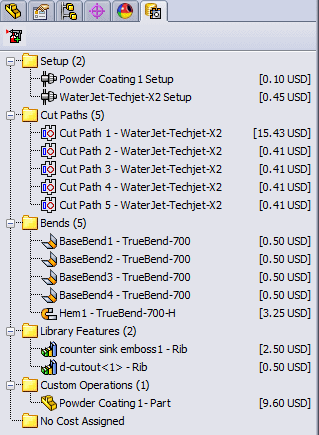

Use the CostingManager on the left side of the SolidWorks software window to see how the Costing tool categorizes each operation required for manufacturing the part.
To display the CostingManager:
- In a sheet metal part, click Costing

Setup
The Setup
folder contains the costs associated with manufacturing setups such as setting up machines to run a batch (lot) of parts. Each operation to manufacture the part requires a setup cost. If the setup cost is in the sheet metal template, it is recognized by the Costing tool.
For example, in the template, if you assign cut paths to a laser cutting operation, then the setup cost for the cut paths will be added from the template to the Setup folder.
Expand the Setup
folder and hover over a setup cost
to see how the cost is calculated.
The setup cost is per part.
Cut Paths
Cut paths are the tool paths that 2D machining operations, such as laser, waterjet, or plasma cutting will follow. In a part that starts as plate stock, any through holes, through cuts, or outside boundary geometry that needs cutting is cut using 2D machining operations by default, creating cut paths for these features.
The
Cut Paths
folder contains the:
- number of cuts required for the part
- cutting method to be used
- cost of each cut
The cost of each cut is calculated by:
Cost = Cut Length * Cost Per Unit Length in the sheet metal template
Expand the Cut Paths
folder and hover over a cut path
to see how the cost is calculated. Select a cut path to highlight the geometry in the model.
Bends
The Bends
folder contains all of the bends in the sheet metal part. Bends are separated into two categories: regular bends and hems. All bends in the folder indicate the bend operation to use and the cost of each bend.
Library Features
The Library Features
folder contains all forming tools and library features in the sheet metal part. The cost of each item is calculated per stroke as defined in the sheet metal template.
Hover over a library feature
to see the equation used to calculate the cost.
You can dissolve library features on sheet metal bodies. If you need to manufacture a library feature with a laser or water jet machine, you can dissolve the library feature so the Costing tool can calculate the cost based on the length to be cut, not on a per-stroke basis. In the FeatureManager design tree, right-click the library feature and click Dissolve Library Feature. The library feature is converted to cut paths for the Costing tool to evaluate.
Custom Operations
The Custom Operations
folder contains any operations that are not automatically recognized by the Costing tool. A custom operation cost can be calculated as a cost associated with the entire part, the part weight, specific part faces, part edges, or a single stroke operation such as a punch or bend operation.
For example, if the part is to be painted, you can assign a cost to paint the entire part or specific faces of a part. If you are painting specific faces, include a cost per area such as dollars per square inch to paint the part.
You can set custom operations in the sheet metal template and apply the operations automatically or manually.
You can also create custom operations without editing the template by clicking Add Custom Operation
in the CostingManager.
Each item in the folder displays the operation name you selected and the selection type.
Hover over a custom operation to see the equation used to calculate the cost.
No Cost Assigned
The
No Cost Assigned
folder contains features that:
- are not recognized by the Costing tool
- are not defined in the sheet metal template
- have a zero cost
If you set a feature cost to zero, the feature moves to this folder. If you assign a cost to a feature in the No Cost Assigned
folder, the feature moves to the appropriate folder and appears in italics with an asterisk to indicate an override. If a feature that you assign a cost to is not a cut path, bend, or library feature, then that feature is assigned to the Custom Operations
folder.
