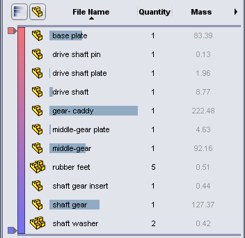

In Assembly Visualization, you can rank components based on the values of their custom properties.
The Assembly Visualization tab
in the FeatureManager design tree panel contains a list of all components in the assembly, sorted initially by file name.
To sort the list:

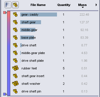

Click a column header to sort the components by that property. For example, to sort by component mass, click Mass.
- Click again to sort in reverse order.
You can adjust the width of a column to fit the column contents by double-clicking the column separator.
