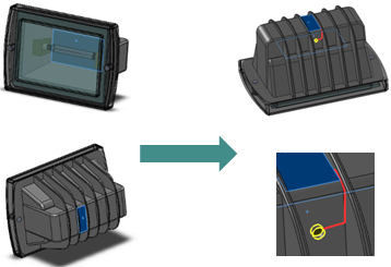

Leakage Browser
Available in the Create Lids feature. Helps you locate holes or displacement gaps in the model by visualizing the route from an internal face to an external face of the component.
