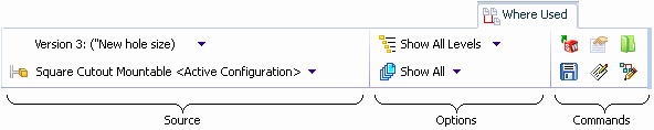

The toolbar areas of the Contains and Where Used tabs in Windows Explorer have been updated to make the controls easier to use and occupy less screen space.
Existing controls on both tabs have been rearranged into three sections.
Where_Used_contains_toolbar
  • The source section lets you select the version and configuration of the file to view.
  • The options section controls how the results are displayed.
  • The commands section contains action buttons.
If you shrink the size of the window, the sections are compacted into flyout buttons. Clicking any of these buttons displays the controls for that section.
