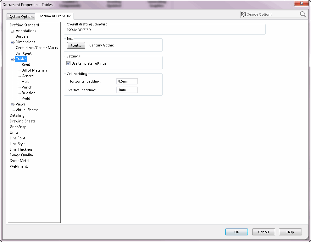

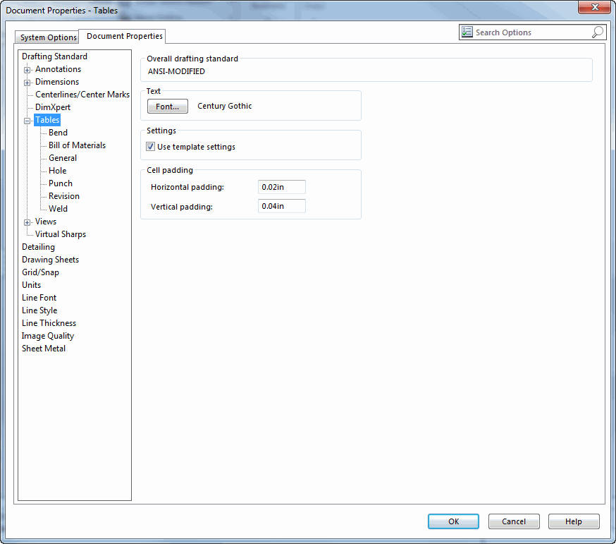

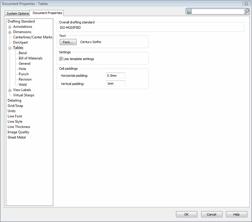

Document Properties > Tables
Setting
Get/Set Methods
Return Value or <Value>
Comments
Text - Font...
IModelDocExtension::GetUserPreferenceTextFormat(swUserPreferenceTextFormat_e.swDetailingTableTextFormat, swUserPreferenceOption_e.swDetailingNoOptionSpecified)
IModelDocExtension::SetUserPreferenceTextFormat(swUserPreferenceTextFormat_e.swDetailingTableTextFormat, swUserPreferenceOption_e.swDetailingNoOptionSpecified, <Value>)
See ITextFormat for font options
To set font property values, implement ITextFormat, set the appropriate ITextFormat member values, and pass the ITextFormat object in the API set method
Use template settings
IModelDocExtension::GetUserPreferenceToggle(swUserPreferenceToggle_e.swDetailingTablesUseTemplateSettings, swUserPreferenceOption_e.swDetailingNoOptionSpecified)
IModelDocExtension::SetUserPreferenceToggle(swUserPreferenceToggle_e.swDetailingTablesUseTemplateSettings, swUserPreferenceOption_e.swDetailingNoOptionSpecified, <Value>)
Boolean value
Specifies whether to override a table's document properties with the settings of an imported template
Cell paddings - Horizontal padding
IModelDocExtension::GetUserPreferenceDouble(swUserPreferenceDoubleValue_e.swDetailingTablesHorizontalPadding, swUserPreferenceOption_e.swDetailingNoOptionSpecified)
IModelDocExtension::SetUserPreferenceDouble(swUserPreferenceDoubleValue_e.swDetailingTablesHorizontalPadding, swUserPreferenceOption_e.swDetailingNoOptionSpecified, <Value>)
Double value
Specifies the horizontal padding for table cells
Cell paddings - Vertical padding
IModelDocExtension::GetUserPreferenceDouble(swUserPreferenceDoubleValue_e.swDetailingTablesVerticalPadding, swUserPreferenceOption_e.swDetailingNoOptionSpecified)
IModelDocExtension::SetUserPreferenceDouble(swUserPreferenceDoubleValue_e.swDetailingTablesVerticalPadding, swUserPreferenceOption_e.swDetailingNoOptionSpecified, <Value>)
Double value
Specifies the vertical padding for table cells
