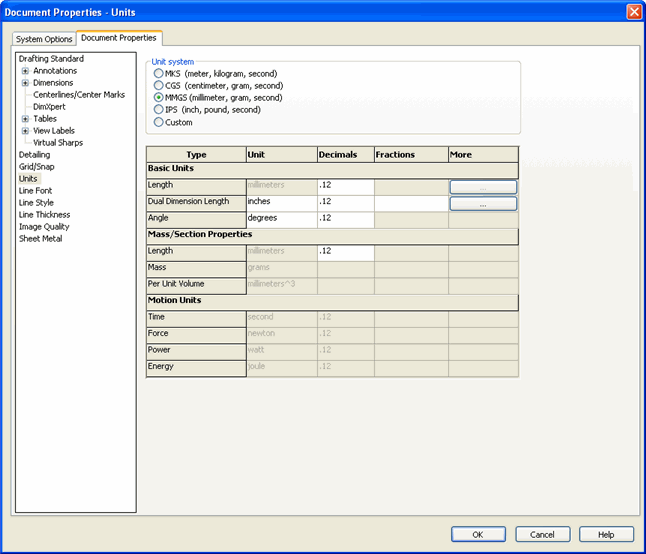

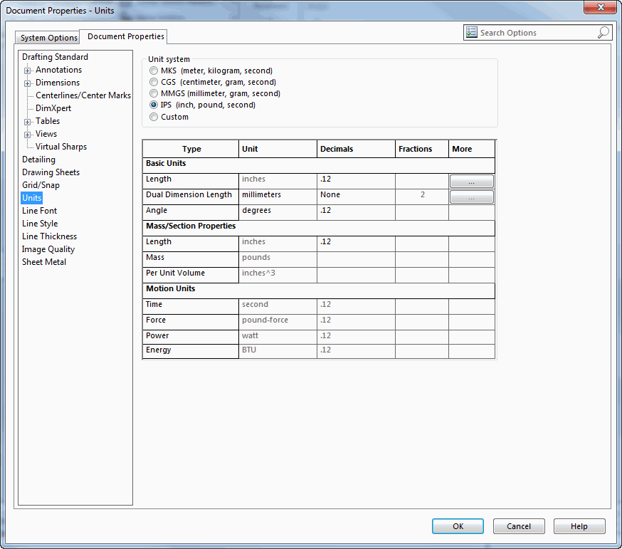

Document Properties > Units
Setting
Get/Set Methods
Return Value or <Value>
Comments
Unit system
IModelDocExtension::GetUserPreferenceInteger(swUserPreferenceIntegerValue_e.swUnitSystem, swUserPreferenceOption_e.swDetailingNoOptionSpecified)
IModelDocExtension::SetUserPreferenceInteger(swUserPreferenceIntegerValue_e.swUnitSystem, swUserPreferenceOption_e.swDetailingNoOptionSpecified, swUnitSystem_e.<Value>)
See swUnitSystem_e for valid options
Specifies type of system unit
Basic Units - Length - Unit
IModelDocExtension::GetUserPreferenceInteger(swUserPreferenceIntegerValue_e.swUnitsLinear, swUserPreferenceOption_e.swDetailingNoOptionSpecified)
IModelDocExtension::SetUserPreferenceInteger(swUserPreferenceIntegerValue_e.swUnitsLinear, swUserPreferenceOption_e.swDetailingNoOptionSpecified, swLengthUnit_e.<Value>)
See swLengthUnit_e for valid options
Specifies the type of linear length units
Basic Units - Length - Decimals or fractions?
IModelDocExtension::GetUserPreferenceInteger(swUserPreferenceIntegerValue_e.swUnitsLinearDecimalDisplay, swUserPreferenceOption_e.swDetailingNoOptionSpecified)
IModelDocExtension::SetUserPreferenceInteger(swUserPreferenceIntegerValue_e.swUnitsLinearDecimalDisplay, swUserPreferenceOption_e.swDetailingNoOptionSpecified, swFractionDisplay_e.<Value>)
See swFractionDisplay_e for valid options
Specifies decimal or fraction display for linear units
IModelDocExtension::GetUserPreferenceInteger(swUserPreferenceIntegerValue_e.swUnitsLinearDecimalPlaces, swUserPreferenceOption_e.swDetailingNoOptionSpecified)
IModelDocExtension::SetUserPreferenceInteger(swUserPreferenceIntegerValue_e.swUnitsLinearDecimalPlaces, swUserPreferenceOption_e.swDetailingNoOptionSpecified, <Value>)
Integer value (0 - 8)
Specifies the number of decimal places for linear units
Basic Units - Length - Fractions
IModelDocExtension::GetUserPreferenceInteger(swUserPreferenceIntegerValue_e.swUnitsLinearFractionDenominator, swUserPreferenceOption_e.swDetailingNoOptionSpecified)
IModelDocExtension::SetUserPreferenceInteger(swUserPreferenceIntegerValue_e.swUnitsLinearFractionDenominator, swUserPreferenceOption_e.swDetailingNoOptionSpecified, <Value>)
Integer value
Specifies the default denominator for linear fractions
Basic Units - Length - More - Convert  feet and inches format
IModelDocExtension::GetUserPreferenceToggle(swUserPreferenceToggle_e.swUnitsLinearFeetAndInchesFormat, swUserPreferenceOption_e.swDetailingNoOptionSpecified)
IModelDocExtension::SetUserPreferenceToggle(swUserPreferenceToggle_e.swUnitsLinearFeetAndInchesFormat, swUserPreferenceOption_e.swDetailingNoOptionSpecified, <Value>)
Boolean value
Specifies whether to change format of linear feet and inches
Basic Units - Length - More - Round to nearest fraction
IModelDocExtension::GetUserPreferenceToggle(swUserPreferenceToggle_e.swUnitsLinearRoundToNearestFraction, swUserPreferenceOption_e.swDetailingNoOptionSpecified)
IModelDocExtension::SetUserPreferenceToggle(swUserPreferenceToggle_e.swUnitsLinearRoundToNearestFraction, swUserPreferenceOption_e.swDetailingNoOptionSpecified, <Value>)
Boolean value
Specifies whether to round linear units to the nearest fraction
Basic Units - Dual Dimension Length - Unit
IModelDocExtension::GetUserPreferenceInteger(swUserPreferenceIntegerValue_e.swUnitsDualLinear, swUserPreferenceOption_e.swDetailingNoOptionSpecified)
IModelDocExtension::SetUserPreferenceInteger(swUserPreferenceIntegerValue_e.swUnitsDualLinear, swUserPreferenceOption_e.swDetailingNoOptionSpecified, swLengthUnit_e.<Value>)
Specifies type of dual linear length units
Basic Units - Dual Dimension Length - Decimals or fractions?
IModelDocExtension::GetUserPreferenceInteger(swUserPreferenceIntegerValue_e.swUnitsDualLinearDecimalDisplay, swUserPreferenceOption_e.swDetailingNoOptionSpecified)
IModelDocExtension::SetUserPreferenceInteger(swUserPreferenceIntegerValue_e.swUnitsDualLinearDecimalDisplay, swUserPreferenceOption_e.swDetailingNoOptionSpecified, swFractionDisplay_e.<Value>)
Specifies decimal or fraction display for dual linear units
IModelDocExtension::GetUserPreferenceInteger(swUserPreferenceIntegerValue_e.swUnitsDualLinearDecimalPlaces, swUserPreferenceOption_e.swDetailingNoOptionSpecified)
IModelDocExtension::SetUserPreferenceInteger(swUserPreferenceIntegerValue_e.swUnitsDualLinearDecimalPlaces, swUserPreferenceOption_e.swDetailingNoOptionSpecified, <Value>)
Specifies the number of decimal places for dual linear units
Basic Units - Dual Dimension Length - Fractions
IModelDocExtension::GetUserPreferenceInteger(swUserPreferenceIntegerValue_e.swUnitsDualLinearFractionDenominator, swUserPreferenceOption_e.swDetailingNoOptionSpecified)
IModelDocExtension::SetUserPreferenceInteger(swUserPreferenceIntegerValue_e.swUnitsDualLinearFractionDenominator, swUserPreferenceOption_e.swDetailingNoOptionSpecified, <Value>)
Integer value
Specifies the default denominator for dual linear fractions
Basic Units - Dual Dimension Length - More - Round to nearest fraction
IModelDocExtension::GetUserPreferenceToggle(swUserPreferenceToggle_e.swUnitsDualLinearRoundToNearestFraction, swUserPreferenceOption_e.swDetailingNoOptionSpecified)
IModelDocExtension::SetUserPreferenceToggle(swUserPreferenceToggle_e.swUnitsDualLinearRoundToNearestFraction, swUserPreferenceOption_e.swDetailingNoOptionSpecified, <Value>)
Boolean value
Specifies whether to round dual linear units to the nearest fraction
Basic Units - Dual Dimension Length - More - Convert feet and inches format
IModelDocExtension::GetUserPreferenceToggle(swUserPreferenceToggle_e.swUnitsDualLinearFeetAndInchesFormat, swUserPreferenceOption_e.swDetailingNoOptionSpecified)
IModelDocExtension::SetUserPreferenceToggle(swUserPreferenceToggle_e.swUnitsDualLinearFeetAndInchesFormat, swUserPreferenceOption_e.swDetailingNoOptionSpecified, <Value>)
Boolean value
Specifies whether to change format of dual linear feet and inches
Basic Units - Angle - Unit
IModelDocExtension::GetUserPreferenceInteger(swUserPreferenceIntegerValue_e.swUnitsAngular, swUserPreferenceOption_e.swDetailingNoOptionSpecified)
IModelDocExtension::SetUserPreferenceInteger(swUserPreferenceIntegerValue_e.swUnitsAngular, swUserPreferenceOption_e.swDetailingNoOptionSpecified, swAngleUnit_e.<Value>)
See swAngleUnit_e for valid options
Specifies angular units
Basic Units - Angle - Decimals
IModelDocExtension::GetUserPreferenceInteger(swUserPreferenceIntegerValue_e.swUnitsAngularDecimalPlaces, swUserPreferenceOption_e.swDetailingNoOptionSpecified)
IModelDocExtension::SetUserPreferenceInteger(swUserPreferenceIntegerValue_e.swUnitsAngularDecimalPlaces, swUserPreferenceOption_e.swDetailingNoOptionSpecified, <Value>)
Specifies the number of decimal places for angular units
Mass/Section Properties - Length - Unit
IModelDocExtension::GetUserPreferenceInteger(swUserPreferenceIntegerValue_e.swUnitsMassPropLength, swUserPreferenceOption_e.swDetailingNoOptionSpecified)
IModelDocExtension::SetUserPreferenceInteger(swUserPreferenceIntegerValue_e.swUnitsMassPropLength, swUserPreferenceOption_e.swDetailingNoOptionSpecified, swLengthUnit_e<Value>)
Specifies type of length unit to use for mass property units
NOTE: You can only set this option when swUnitSystem_e is swUnitSytem_Custom; Otherwise, FALSE is returned
Mass/Section Properties - Length - Decimals
IModelDocExtension::GetUserPreferenceInteger(swUserPreferenceIntegerValue_e.swUnitsMassPropDecimalPlaces, swUserPreferenceOption_e.swDetailingNoOptionSpecified)
IModelDocExtension::SetUserPreferenceInteger(swUserPreferenceIntegerValue_e.swUnitsMassPropDecimalPlaces, swUserPreferenceOption_e.swDetailingNoOptionSpecified, <Value>)
Specifies number of decimal places for mass property units
Mass/Section Properties - Mass - Unit
IModelDocExtension::GetUserPreferenceInteger(swUserPreferenceIntegerValue_e.swUnitsMassPropMass, swUserPreferenceOption_e.swDetailingNoOptionSpecified)
IModelDocExtension::SetUserPreferenceInteger(swUserPreferenceIntegerValue_e.swUnitsMassPropMass, swUserPreferenceOption_e.swDetailingNoOptionSpecified, swUnitsMassPropMass_e.<Value>)
See swUnitsMassPropMass_e for valid options
Specifies type of mass unit to use for mass property units
Mass/Section Properties - Per Unit Volume - Unit
IModelDocExtension::GetUserPreferenceInteger(swUserPreferenceIntegerValue_e.swUnitsMassPropVolume, swUserPreferenceOption_e.swDetailingNoOptionSpecified)
IModelDocExtension::SetUserPreferenceInteger(swUserPreferenceIntegerValue_e.swUnitsMassPropVolume, swUserPreferenceOption_e.swDetailingNoOptionSpecified, swUnitsMassPropVolume_e.<Value>)
See swUnitsMassPropVolume_e for valid options
Specifies type of volume unit to use for mass property units
Motion Analysis - Time - Unit
IModelDocExtension::GetUserPreferenceInteger(swUserPreferenceIntegerValue_e.swUnitsTimeUnits, swUserPreferenceOption_e.swDetailingNoOptionSpecified)
IModelDocExtension::SetUserPreferenceInteger(swUserPreferenceIntegerValue_e.swUnitsTimeUnits, swUserPreferenceOption_e.swDetailingNoOptionSpecified, swUnitsTimeUnit_e.<Value>)
See swUnitsTimeUnit_e for valid options
Specifies the type of time unit.
Motion Analysis - Time - Decimals
IModelDocExtension::GetUserPreferenceInteger(swUserPreferenceIntegerValue_e.swUnitsTimeDecimalPlaces, swUserPreferenceOption_e.swDetailingNoOptionSpecified)
IModelDocExtension::SetUserPreferenceInteger(swUserPreferenceIntegerValue_e.swUnitsTimeDecimalPlaces, swUserPreferenceOption_e.swDetailingNoOptionSpecified, <Value>)
Specifies the number of decimal places for swUnitsTime
Motion Analysis - Force - Unit
IModelDocExtension::GetUserPreferenceInteger(swUserPreferenceIntegerValue_e.swUnitsForce, swUserPreferenceOption_e.swDetailingNoOptionSpecified)
IModelDocExtension::SetUserPreferenceInteger(swUserPreferenceIntegerValue_e.swUnitsForce, swUserPreferenceOption_e.swDetailingNoOptionSpecified, swUnitsForce_e.<Value>)
See swUnitsForce_e for valid options
Specifies the type of force units.
Motion Analysis - Force - Decimals
IModelDocExtension::GetUserPreferenceInteger(swUserPreferenceIntegerValue_e.swUnitsForceDecimalPlaces, swUserPreferenceOption_e.swDetailingNoOptionSpecified)
IModelDocExtension::SetUserPreferenceInteger(swUserPreferenceIntegerValue_e.swUnitsForceDecimalPlaces, swUserPreferenceOption_e.swDetailingNoOptionSpecified, <Value>)
Specifies the number of decimal places for swUnitsForce
Motion Analysis - Power - Unit
IModelDocExtension::GetUserPreferenceInteger(swUserPreferenceIntegerValue_e.swUnitsPowerUnits, swUserPreferenceOption_e.swDetailingNoOptionSpecified)
IModelDocExtension::SetUserPreferenceInteger(swUserPreferenceIntegerValue_e.swUnitsPowerUnits, swUserPreferenceOption_e.swDetailingNoOptionSpecified, swUnitsPowerUnit_e.<Value>)
See swUnitsPowerUnit_e for valid options
Specifies type of power unit.
Motion Analysis - Power - Decimals
IModelDocExtension::GetUserPreferenceInteger(swUserPreferenceIntegerValue_e.swUnitsPowerDecimalPlaces, swUserPreferenceOption_e.swDetailingNoOptionSpecified)
IModelDocExtension::SetUserPreferenceInteger(swUserPreferenceIntegerValue_e.swUnitsPowerDecimalPlaces, swUserPreferenceOption_e.swDetailingNoOptionSpecified, <Value>)
Specifies the number of decimal places for swUnitsPower
Motion Analysis - Energy - Unit
IModelDocExtension::GetUserPreferenceInteger(swUserPreferenceIntegerValue_e.swUnitsEnergyUnits, swUserPreferenceOption_e.swDetailingNoOptionSpecified)
IModelDocExtension::SetUserPreferenceInteger(swUserPreferenceIntegerValue_e.swUnitsEnergyUnits, swUserPreferenceOption_e.swDetailingNoOptionSpecified, swUnitsEnergyUnit_e.<Value>)
See swUnitsEnergyUnit_e for valid options
Specifies the type of energy units.
Motion Analysis - Energy - Decimals
IModelDocExtension::GetUserPreferenceToggle(swUserPreferenceToggle_e.swUnitsEnergyDecimalPlaces, swUserPreferenceOption_e.swDetailingNoOptionSpecified)
IModelDocExtension::SetUserPreferenceToggle(swUserPreferenceToggle_e.swUnitsEnergyDecimalPlaces, swUserPreferenceOption_e.swDetailingNoOptionSpecified, <Value>)
Specifies the number of decimal places for swUnitsEnergy
